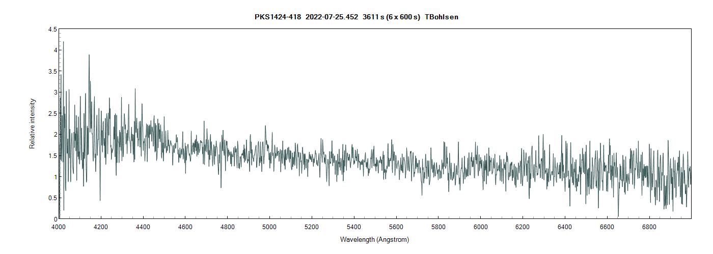

Hi All
There was a recent ATel #15525 reporting a brightening of this very distant object up to a mag of R=13.4
I tried to take a spectrum of it using my LISA. It is pretty dim but I could certainly obtained a spectrum. It seems pretty flat but because of the high redshift it is difficult for me to determine even vague lines.
Certainly a z=1.522, this is the furthest out object I have been able to take a spectrum of.
Terry

Hamish Barker
Posts: 227
Re: Blazar PKS 1424-414 (z=1.522) brightening
Post by Hamish Barker »
Nice work Terry.
It is certainly a bit mind boggling to be able to measure something so far away, and to do it with amateur equipment is even more incredible.
If 2SPot is able to take a spectrum with a slightly wider wavelength range by a few hundred angstrom each way, there are two possible absorbtion lines just off both the blue and red ends which were previously used to obtain the indicated redshift measurement.
