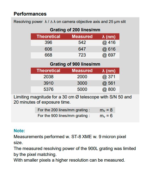

Re: V460Cyg a Carbon star spectrum
Hi Nacho,
I would be interested to see how faint you can go with the DADOS. The limiting magnitudes given in the manual seem rather poor to me.
Exact figures depend on many factors of course but I would expect to get ~3 magnitudes fainter than this at the same resolution and SNR using the same aperture and exposure with my ALPY600 and LHIRES
