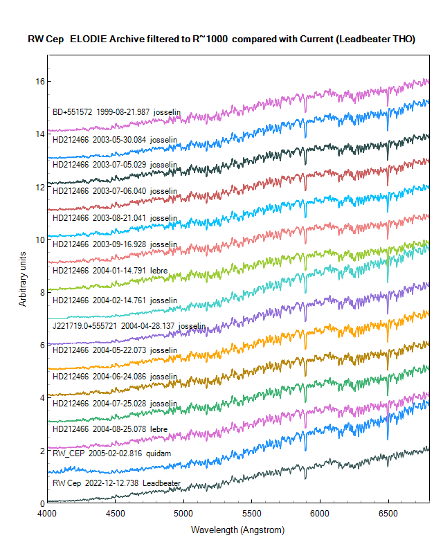

Currently mag 7.5 it is bright enough for high resolutions but it is not clear what wavelengths would be specifically interesting so Echelle spectra could be useful.
I have taken some carefully relative flux calibrated R~1000 spectra seen here in the BAA database (I will also add any further spectra there)

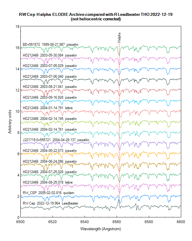

H alpha is in emission
https://britastro.org/specdb/data_graph ... s_id=13128
There may be more lines in emission. An echelle spectrum could be interesting
There are several high resolution spectra in the ELODIE archive but none of these show H alpha in emission (here compared with my spectra)

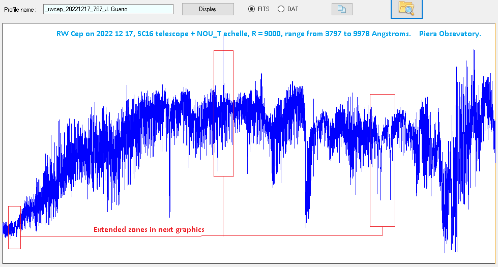

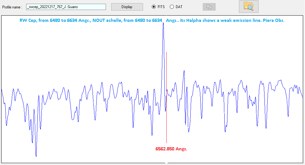

Hi Robin and everyone,
That is the result of one RW Cep observation, unfortunately the bad weather didn't leave me any other oportunity to observe it.
I left this in BAA, but I don't know either if exist someone interested in more observatons..
Merry Christmas and Happy Good Year, Joan.
- RW CEP 1.png (17.38 KiB) Viewed 12828 times
- RW CEP-2.png (14.3 KiB) Viewed 12828 times
- RW CEP-3.png (13.89 KiB) Viewed 12828 times
- RW CEP-4.png (25.9 KiB) Viewed 12828 times

What do you think of the flux calibration of your spectrum ? Is it ok? What did you use as reference star?
The continuum shape is very different from mine and historic spectra in the EOODIE Archive.
https://britastro.org/specdb/data_graph ... 20+Spectra
- Posts: 690
Re: RW Cep unusual dimming
Hi Robin,
As you said, the perfect spectrograph doesn't exist, and I'm afraid that an echelle isn't the best tool
for taking a good calibration flux, in my opinion, using a low resolution spectrograph takes very useful
data for it and more easily.
One can see that almost all studies using echelles, represent their data in a horizontal background.
BTW, it's possible that I'll have a good night today and I'll try to take this star again, and go to essay
V photometry with the Piera telescope. It's a pity that SMM one is damaged until the middle of January.
Cheers, Joan.
