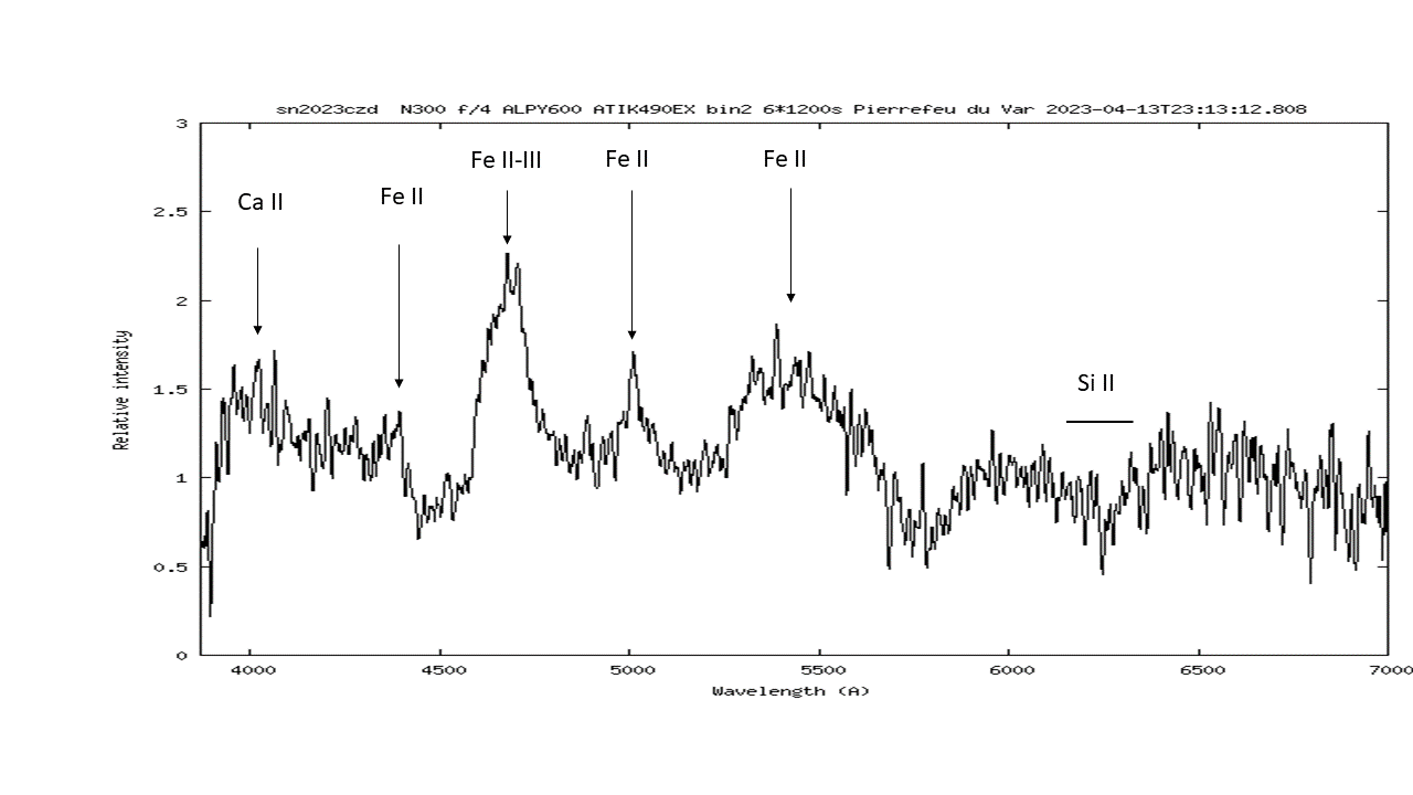

here is an Ia type supernova (m~16) in LEDA 83768 taken the 20230412 with a Newton 300 f/4 and Alpy 600 spectrograph.
Regards
Emmanuel
Newton 300 f/4 - Alpy 600/200 - science cam Asi 533mm - autoguider cam Asi 174 - AP900

An impressive result at mag 16. I see amateur Claudio Balcon made the official classification, beating the professional team by just 3 minutes !
https://www.wis-tns.org/object/2023czd
