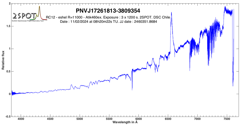

We made its spectrum last night with our eshel setup (R=11000). Just 3 exposures of 1200s before sunrise. The target was at magnItude 6.4 at the time of the exposures.
The spectrum was produced automatically this morning
Here's the automatic pointing of the target on the spectrograph fiber
and the full graph automatically processed
as well as the graph of Balmers lines up to H gamma (H Delta being very weak)
Posts: 1955
Re: PNV J17261813-3809354
An interesting very red spectrum. Total galactic IS extinction is 7.8 in V in that direction so probably very reddened. Image how bright it might have been without extinction !

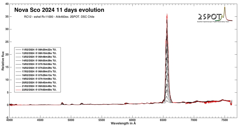

Our observations continue at the rate of one spectrum per day.
Here is the evolution over the first 5 days of this novae
Evolution of the whole spectrum
And the H alpha évolution

Our 9th spectrum of this nova, i.e. one spectrum per night without interruption
2SPOT
Posts: 129
Post by 2SPOT »
Observations of this nova continue from Chile, with 1 spectrum per day for the last 12 days, always in automatic observation and including the spectra process, so we don't have to do anything manually.
Here are our 12 spectra and their evolutions
and H alpha line evolution
