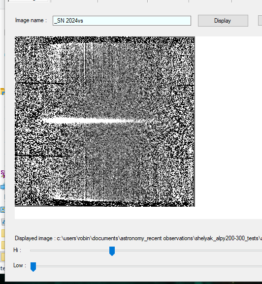

When measuring very faint objects it is important to accurately subtract the sky background which can be much brighter than the target. If using ISIS, a good check is to look at the sky subtracted image of the spectrum that ISIS produces and turn up the brightness. The sky background in the region directly above and below the spectrum should be just noise with no features in it. (If there are any features these will also appear in the target spectrum so adjust the geometric corrections and/or sky binning zones to minimise them)
(Do not worry about what appears to be the very high level of noise in the blue region. This is because the flat correction artificially increases the gain in this region where the flat lamp signal is low. Provided you average enough flats (I use 30) The flat does not significantly contribute to the noise above ~3800A in the final reduced spectrum)
It is also a good idea with faint targets to use a narrow spectrum binning zone and use the "optimal binning" function in the ISIS "General" tab to minimise sky and camera noise
