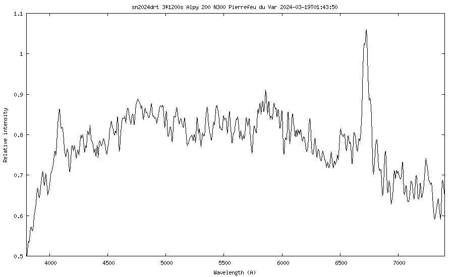

sn type II discovered the 2024-03-02. See discovery report here : https://www.wis-tns.org/object/2024drt/discovery-cert
H alpha and H epsilon redshifted show z of about 0.024
spectrum taken with an alpy 200 on a Newton 300 f/4
Data Process with Isis. Star ref is hd 113697
Emmanuel
Newton 300 f/4 - Alpy 600/200 - science cam Asi 533mm - autoguider cam Asi 174 - AP900
