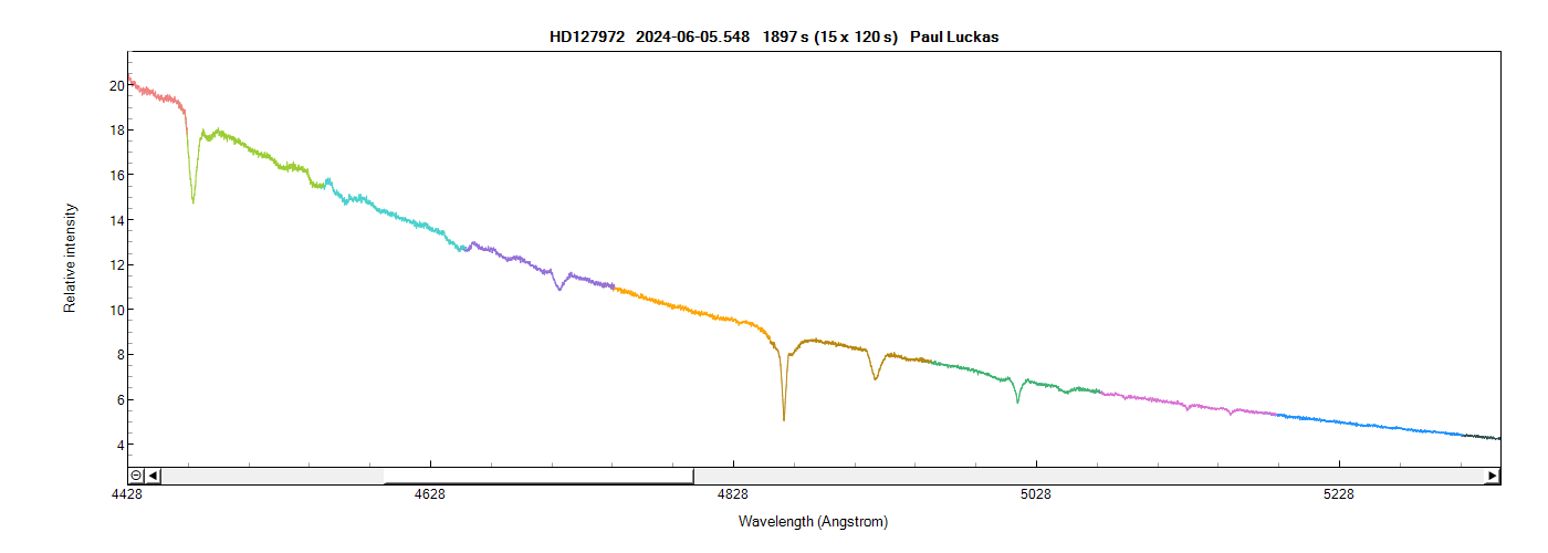

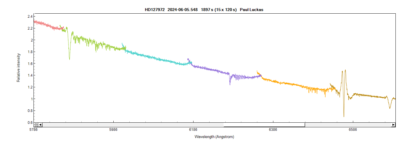

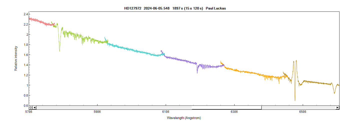

I am hoping someone might be able to shed some light on a curious problem that appears in the merged orders of eShel spectra processed in ISIS. The artefacts appear as 'bumps' at the points where individual orders meet in a merged spectrum and are particularly evident towards the red end, and almost completely absent at shorter wavelength merge points.
I've attached some screenshots that show the effect: a merged spectrum where you can clearly see the 'bumps', and a couple of screen shots that show unmerged orders plotted adjacent to one another that show the cause. The effects are almost absent at the 'blue' end, but increase to the extreme at the 'red' end and appear as pronounced deviations at one end of a typical order.

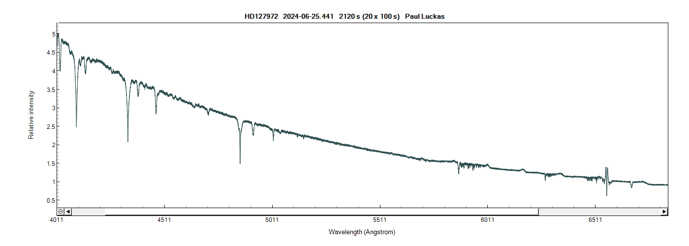

The fact remains that there may be residual separation of each order, as can be seen on this cropped spectrum, where each red arrow indicates the fusion of 2 orders.
and the whole merged spectrum taken in automatic mode reduction (no manual processing with ISIS in remote conditions)

I don't know the cause but It seems to me that it is not a stitching problem but a problem with the individual orders which show flip ups at the edges. The stitching is trying its best to fit to include those edge effects. A problem with the blaze profile in those regions ?
