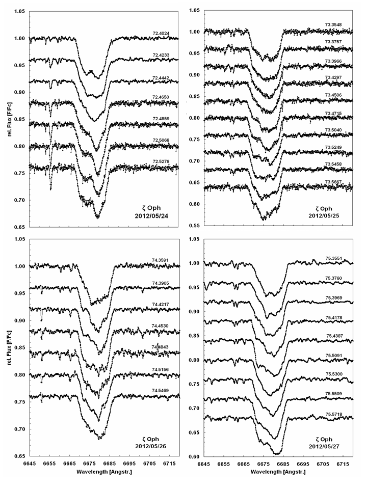

During four consecutive nights (24.-27.5.12) continuation of observations of the non radial pulsations of zeta Oph.
Results:
1. The Line profiles are more or less strong shaped, by the appearing and disappearing of an "emission" bump between 6575 to 6580 angströms, which moves (not always) uniformly across the line. This "bump" often shows a noticeable asymmetry in the way in which it traverses the profile (see plot of the single spectra).

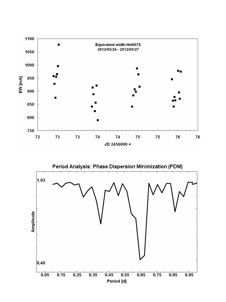

2. Similar to the efforts of P. Harmanec (Bull. Astron. Inst. Czechol. 40, 1989) an attempt, to find out a correlation of the equivalent width with the 0.643 day period (see plot: EW v. JD, and plot: period analysis). The usage of the PDM methode of the program "AVE" leads to a period 0.65 d.

Results:

- single spectra.png (218.66 KiB) Viewed 7645 times
- Period analysis.png (54.21 KiB) Viewed 7645 times
