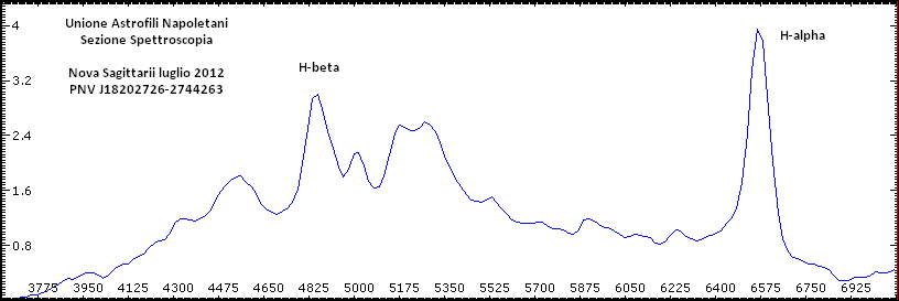

In Naples on 10/07/2012 from Observatory of Capodimonte we, Section of Spectroscopy of Unione Astrofili Napoletani, had catched Nova Sagittarii spectrumby Maktsutov180mm, Neq6 Skywatcher, StarAnalyzer 100l/mm.

- novasag-spectr.png (12.87 KiB) Viewed 5253 times

Good,The hydrogen lines are quite apparent
You could try to correct the instrumental response.
Can you tell us more about the Section of Spectroscopy of Unione Astrofili Napoletani
What instruments, spectrographs, the activity ...

The Section of Spectroscopy is a sperimental Section of the Unione Astrofili Napoletani (UAN) which observe from the Observatory of Capodimonte in Naples. It is composed of four amateurs (including me) and is operating from 2009. Our works have regarded Betelgeuse [Misura della temperatura superficiale di Betelgeuse mediante il metodo spettroscopico http://adsabs.harvard.edu/abs/2011AsUAI...1...20C] presented to Congresso Unione Astrofili Italiani (UAI) on September 2010, Moon [Monitoraggio dei fenomeni lunari transienti (TLP) mediante spettroscopia http://adsabs.harvard.edu/abs/2007AsUAI...6...13M], P-Cygni (next publication on UAI Review), AB-Aurigae, Delta Cephei, monthly monitoring of the spectrum of the crater Aristarchus from July 2011 in search of TLP . Antonio Marino, also him of the Section, have built a spectrograph with a 1200 lines grating and a Hg calibration lamp. Ideas are not missing for us. We operate by Maktusov 1800 on NEq6 Skywatcher, Star Analyzer 100l/mm, CCD Atik 16 IC-S in west cupola or by Celestron C11 f/10 on CI 700, Dados Baader Planetarium 200-900 l/mm, Atik in east cupola Atik 16 IC-S.
