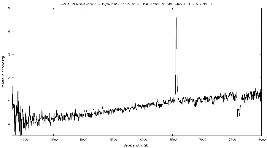

Dear All.
Another nova candidate has been announced on CBAT in Sagittarius called PNV J18193700-1907400
It is only about V =12.7 so quite dim.
I took 30 minutes of spectra of it before I got clouded out. It shows Ha emission but not much else. Enough to confirm that it is a nova though.
http://users.northnet.com.au/~bohlsen/N ... tarius.htm

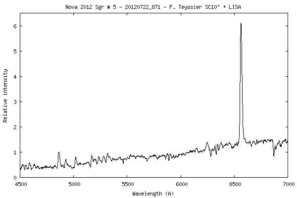

Tonight spectrum
The nova stil rises (Mag V = 11.2 from AAVSO)
The FeII lines appears

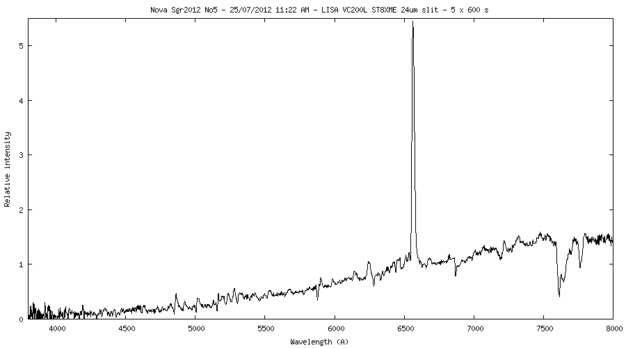

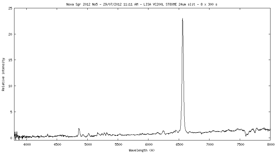

I took further spectra of this nova on 25th and 29th July. I also took photometry of it on 29th giving a V mag of 11.0 and R = 10.39.
More into here
There was a very rapid increase in the intensity of the Ha line over the 4 days.
More into here
