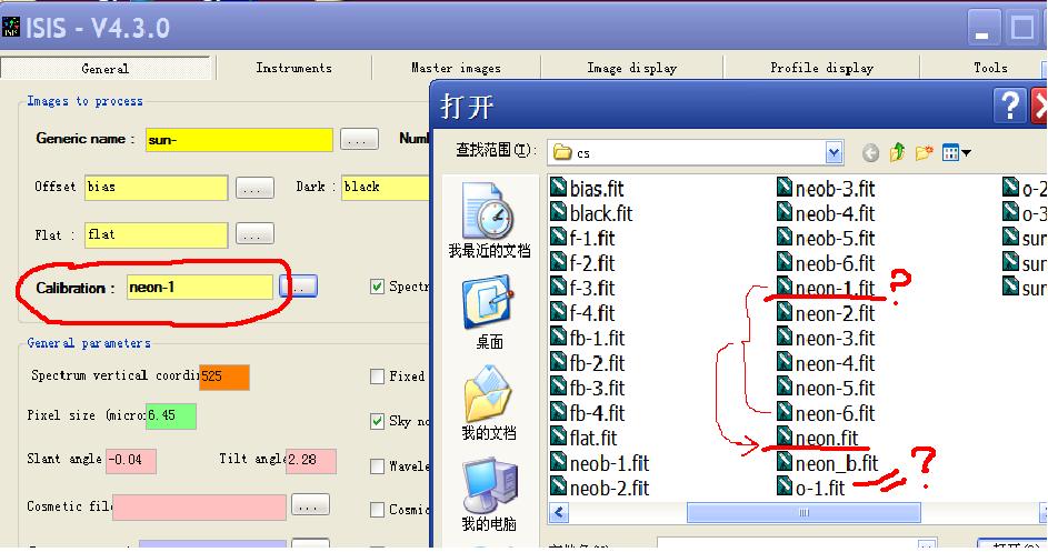

For the Calibration, which one shall I input? I took 6 neon and 6 neonblack; then made NEON.FIT and NEONB.FIT.
neon-1? NEON? neonb-1? or NEONB?
Which one shall I fill into the Calibration blank?
which photo shall I input?
- tu.JPG (89.08 KiB) Viewed 4997 times

Re: which photo shall I input?
Hello, Thierry:
Thank you. I have already and step by step read that link, but they are different~~

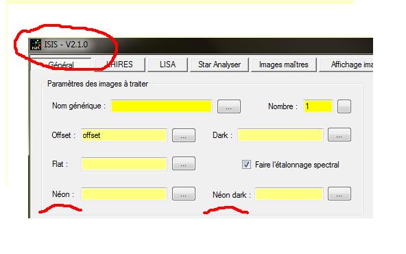

In old version, Isis gives "neon" & "neon dark", usually I fill neon-1 and neon_dark-1. Now the new version ONLY displays [Calibration], so I confuse what I should fill in?
I think that I need your help still....
Hello 李冬
in the calibration field put the file name of a single neon exposure taken just before the spectrum exposure. Due to mechanical flexure, If your spectrum acquisition is more longer than 10 minutes, it's better to use instead two neons: one taken before spectrum and one taken after spectrum. Indicate the file name of the sum of the two in the field calibration.
For the dark, ISIS now use the same dark file for the spectrum and the neon. ISIS apply automatically a factor to correct the difference in time exposure. So just indicate the file name of your master dark frame in the field "dark".
