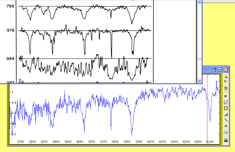

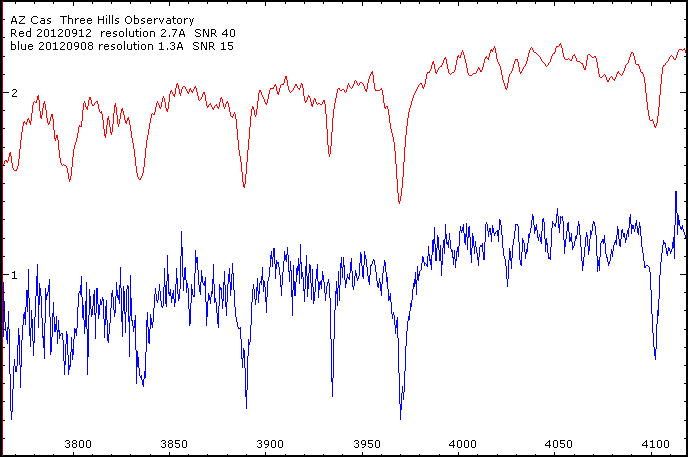

This is a very difficult region for me. The AZCas flux is much lower than at H alpha, the camera and grating response reduces rapidly and the LHIRES achromat cannot keep focus over the full region. I was able to take a spectrum but even in 3 hours I could only get SNR of ~15. (On average I was only recording a photon in each bin every 12 seconds :o ) It does however show the main features expected at this phase (see attached)
If anyone can do better then Cezary would be very grateful
THO 20120908 compared with Cowley 1977 fig 5

The same region using a 600 l/mm grating. The total exposure time was 220 min. The resolution is lower of course but the SNR is better. This may be the only possibility to record spectra when the brightness drops during eclipse.
Re: AZ Cas 3700-4000A
My third spectrum in this region, again using the 600 l/mm grating, compared with the previous spectra. (The first spectrum taken using the 1200 l/mm grating has been gaussian filtered to match the resolution of the 600 grating spectra)
Total exposure was increased further to 4hr 20min :shock: (a record for me) giving an SNR of ~60
As well as low sensitivity and poor focus, wavelength calibration is also a problem as there are only 2 unblended lines in this region which I have been able to identify in the internal neon spectrum (from Ar) and the Filly Dot lamp is just is a mass of blended lines at this resolution so I am using a 2 line linear calibration. This seems quite good though (~+-0.3A based on comparing spectrum of Altair with a UVES spectrum)

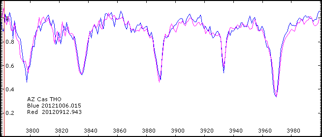

Here is another spectrum of this region for 6th October. (note the decimal date on the graphic is incorrect. It should read 20121006.915) Exposure was 11x1200 but conditions were poor for a time so the SNR is only ~40. There is no obvious change since 12th September.

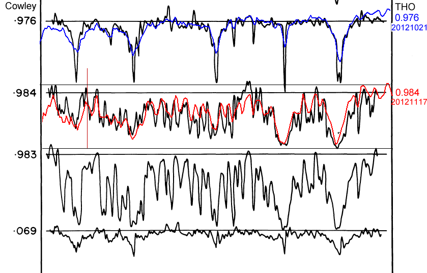

After several weeks poor weather, I was finally able to get another spectrum in the violet on 17 Nov. It shows a dramatic change with many new lines appearing and the Ca H K lines are deeper and broader. (see raw spectrum image compared with a month earlier) The reduced spectra overlay well on spectra from previous eclipses at the same phase, allowing for my lower resolution. (Cowley 1977 fig 5)
