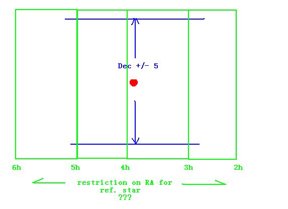

Please look at the picture I attached. Sometimes although Dec+/-5 degree is matched for selecting a ref. star, but the ref. star does not sit near target on RA, on the other hand, I have to find a suitable ref.star far away on the left or right of target on RA. direction. What is the limitation on RA.?

With Lhires III high resolution, one reference per night is enough and you can select Altair in the summer and Regulus in the winter for exemple. In low resolution, a reference closer to each of your target is better. We have inserted in the LISA Pack user manual a list of reference star sorted by Right Ascension and Declination for this purpose.
This manual is available here: http://www.shelyak.com/dossier.php?id_dossier=40&lang=2
