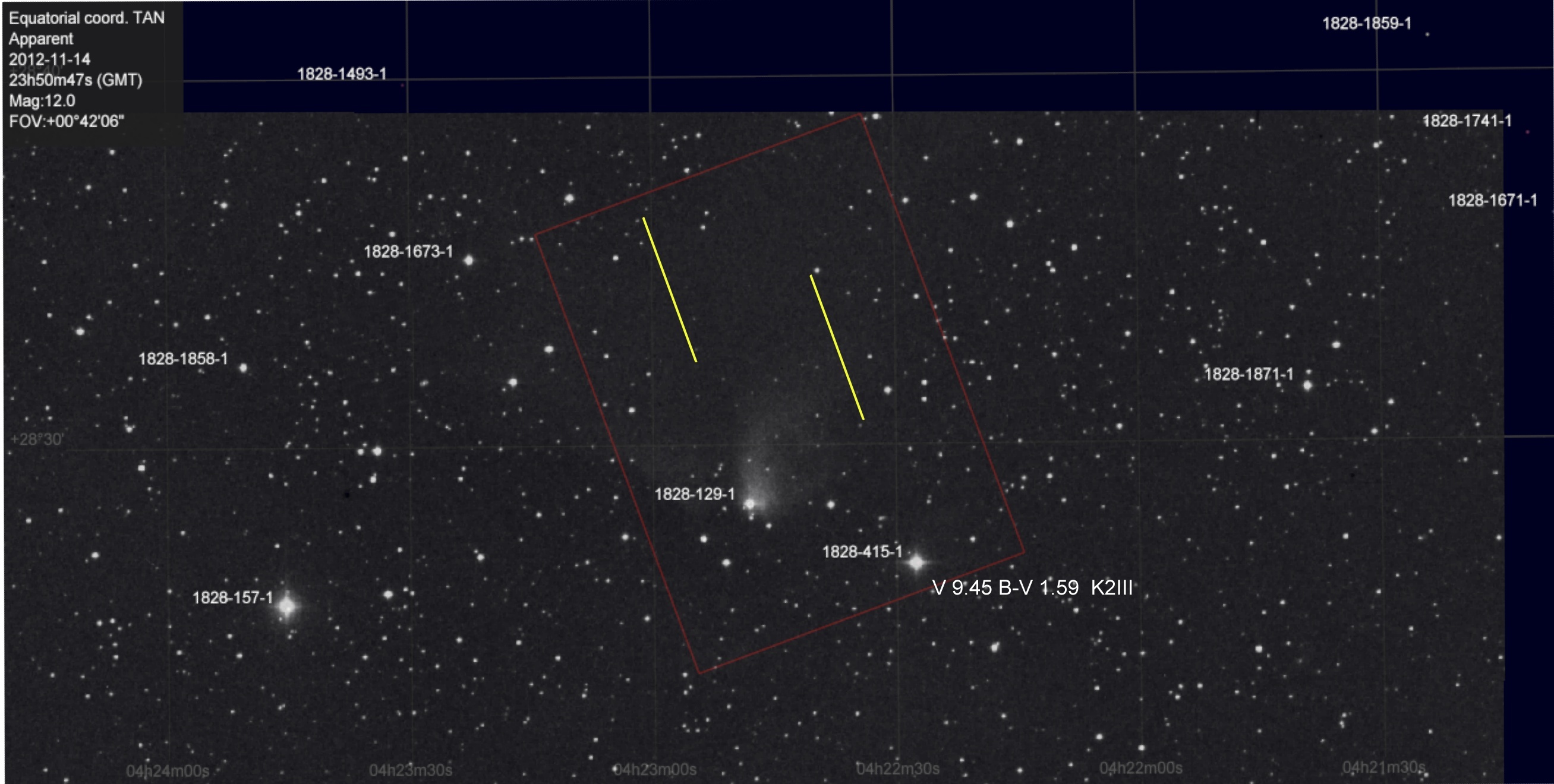

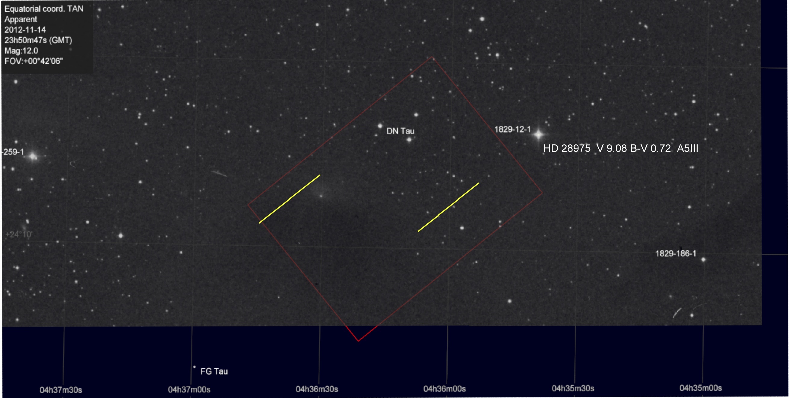

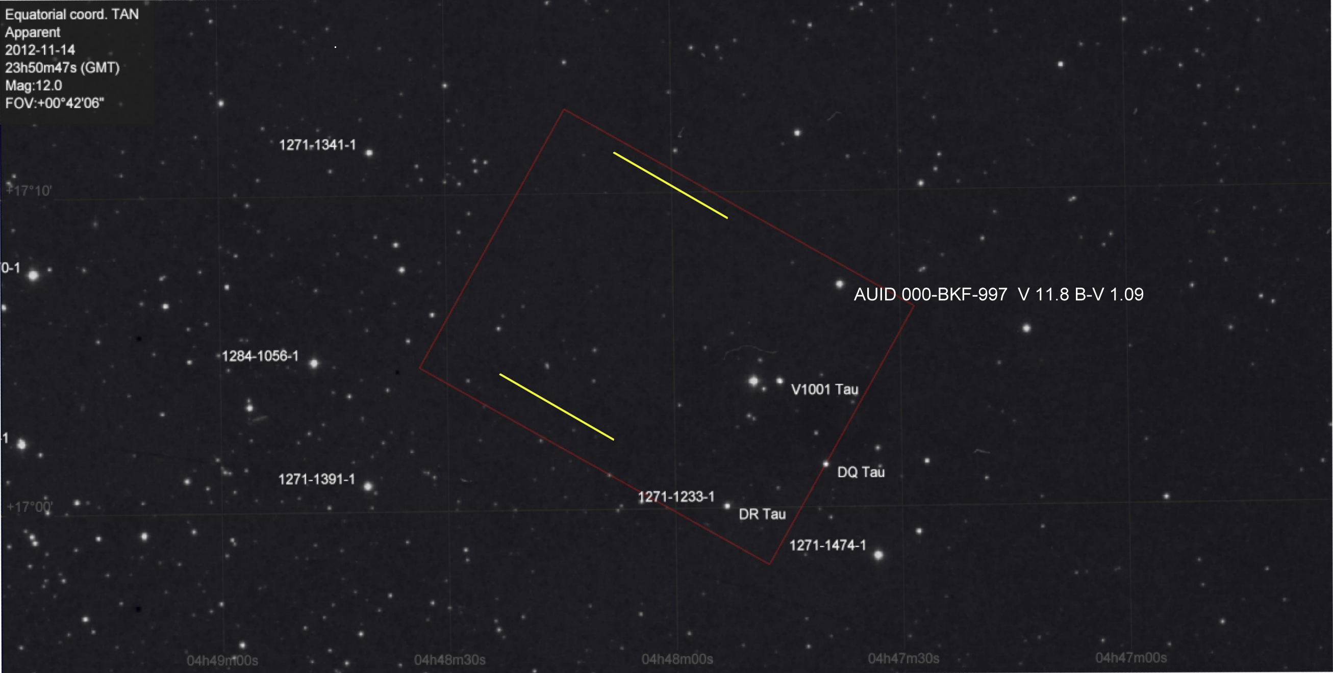

I am working with him to identify potential reference stars and here are some preliminary fields to try based on my setup of C11 at f6.3, SA100 and ATK16IC-S at 14A/pixel. The yellow lines show where the spectra from 3500-7200 would fall. (The suitability of reference star for DR Tau is to yet to be confirmed)
Potential problems are
Lack of signal relative to the sky background at the blue end
Background removal
Avoiding contamination from other stars and spectra
Flat field correction which will be important with the target and reference being in different parts of the field.
It might not be possible to get a good result but it will be interesting to try
