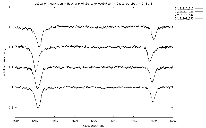

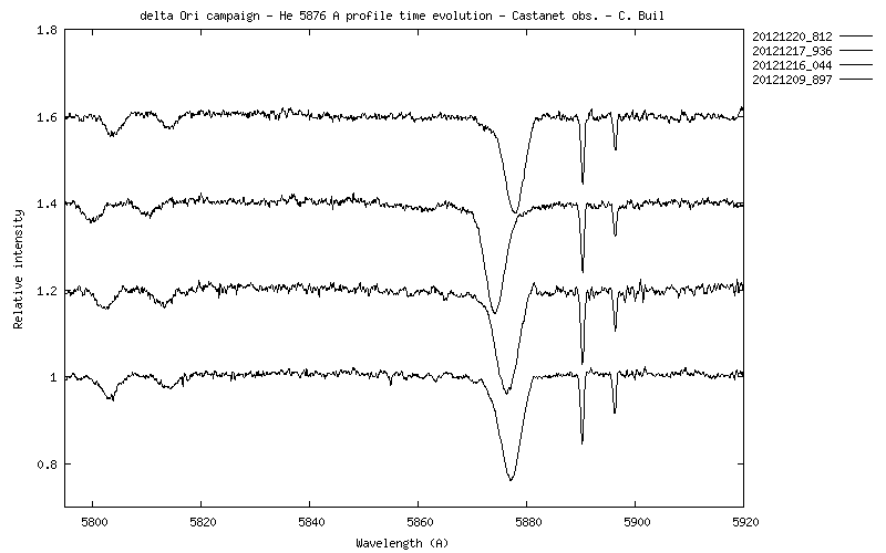

Latest spectra of delta Ori (20.8 dec.):
See also http://www.astrosurf.com/buil/campaign/deltaori/obs.htm
Christian B.
Christian B.
- comparison.png (9.57 KiB) Viewed 6637 times
- comparison2.png (9.25 KiB) Viewed 6637 times
