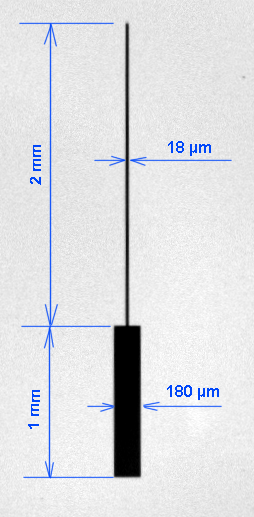

To further investigate this area, Christian suggested to make a special slit for Alpy - called photometric slit. This special step-slit is made of two parts : one thin (like current Alpy slits), and one wide:
With such a slit, you can work in two step. The thin slit allows "full resolution" (ie the max resolution for the instrument), and the wide slit allows to get the full light coming from the star (like in slitless mode), and make photometric measurements.
... a prototype is under test for some days, and it seems to be promising !

Pour explorer ce domaine, Christian nous a suggérer de réaliser une fente particulière, dite photométrique. Il s'agit d'une fente étagée, faite de deux parties : une partie fine (comme la fente standard de Alpy) et une partie large :
Avec une telle fente, on peut travailler en deux temps. La fente étroite permet de profiter de la pleine résolution de l'instrument, et la fente large permet d'enregistrer la totalité du flux venant de l'étoile (comme en mode sans fente) - et donc de faire des mesures photométriques.
... Un protoype est en test depuis quelques jours, et cela semble prometteur !

First test, evaluation and applications of spectrophotometric Shelyak slit here:
http://www.astrosurf.com/buil/alpy600/p ... c_slit.htm
Here a typical application on a very recent observation of RR Lyrae
with a Celestron 9.25 telescope and an Alpy spectrograph:
The RVB pseudo chanel are taken in the same time (thanks to spectrography)
and with a 0,01 mag. precision, or better (thanks photometry).
Probably a world premiere for amateur in spectrophotometric mode.
You can imagine numerous applications, for example instrumentation tests,
education... (I agree with Francois comments).

It is quite difficult to achieve both spectral and photometric measurements alternately. The idea
is not quite that. The photometric slit section is used for special operations, such as the measurement
of atmospheric extinction, photometric monitoring at low spectral resolution, or for precise the spectral response ...
For example, for the instrumental response:
- Spectra are made with fine slits (18, 23 microns). The sequences can of long duration.
- At the end, we made ​​a quick spectrum by using the wide slit (180, 230 microns) to obtain the continuum
and for get a true magnitude point.
The use of large slit can be also more complex because the spectral calibration is less precise.
So, use of two telescopes continue to be a good idea for routine works...
