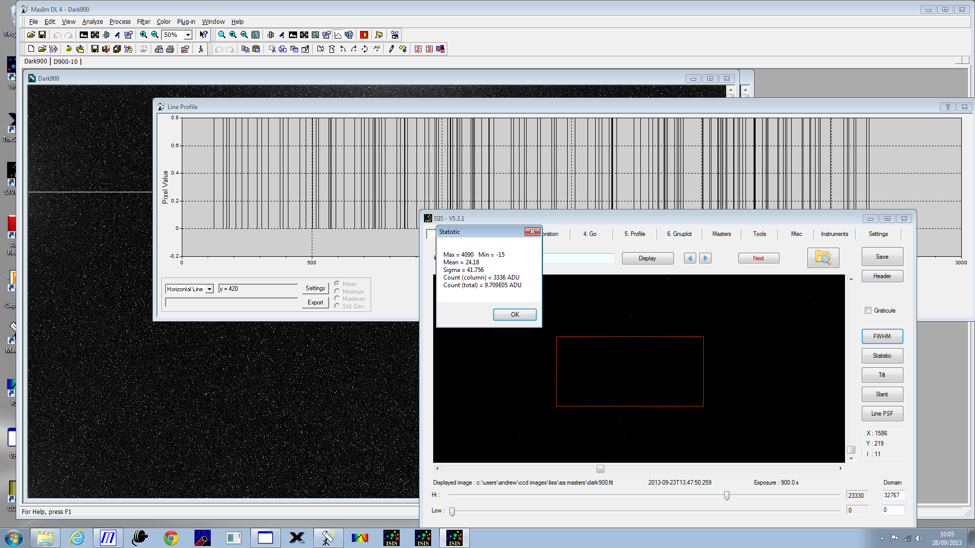

Hi all - I attach a screen capture that show that ISIS seems to be correctly using -ve numbers with my darks (note the negative minimum value). However, in the FITS file the BZERO scale is set to zero and no Pedestal values specified so other packages, Maxim in this case, sets the lowest value is zero.
Christian, would you be kind enough to comment on this? My assumption would be that ISIS is internally using a "Pedestal" value and hence getting the computations correct.
Regards Andrew
