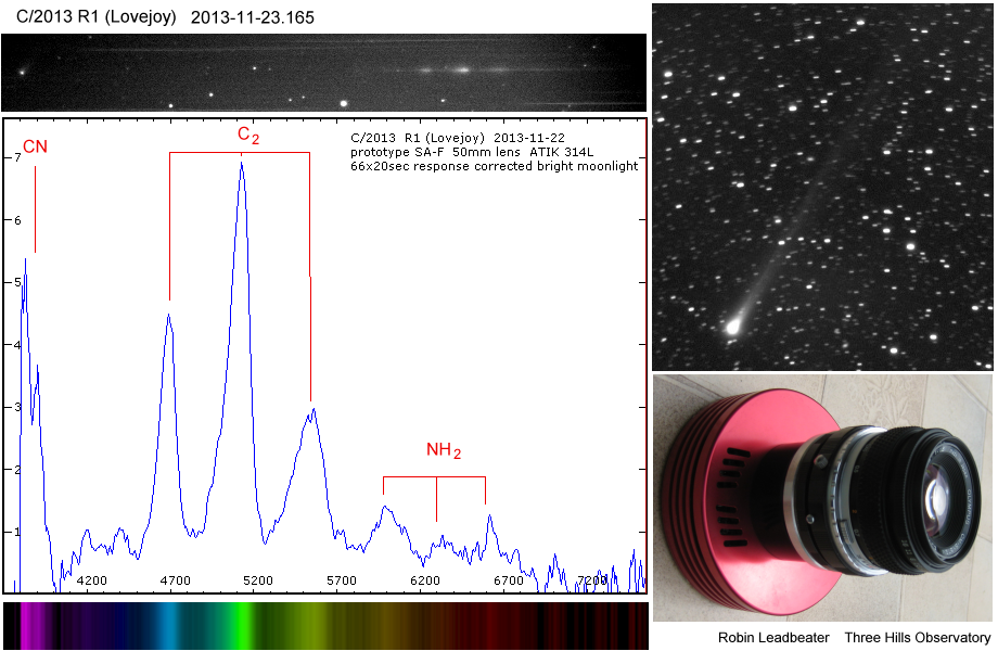

Another one of Lovejoy from 2013-11-22 using an objective grating and a 50mm camera lens. This one is still bright and well placed in the sky. A good target for a slit or slitless spectrograph while we wait to see if ISON survives perihelion
