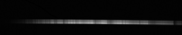

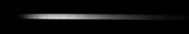

I had my second session with the Alpy. Comments and questions. I thought I thought I had good focus on the slit at the bench. But at the scope I found that when I focused the spectrum the star image in the guider was out of focus. I made the adjustment at the scope. The assumption I made (correct??) is that if the star image is in focus the slit is in focus.
I was working with very bright targets and it was hard to see the change in magnitude when the star moved into the slit. This, I think, is related to question 1. The fix was using the fine grid in PhD.
Below are two image of Betelgeuse. Note that the first image has a dark bar through the middle.
Question 1: Is this bar an indication that I am slightly off the slit? (Perhaps interactions of light and the slit from bring slightly off?)
Question 2: Is the image with the bar useful for analysis?
More general question 3: Does the optical path leading to the guide camera distort the star image?
The reason I ask this is that last time I collimated the results were good. But the off-focus image through the guide camera is off center ("doughnut hole" displaced from the center).
Thanks for any and all comments.
Ed
Second Results Alpy 600
- Betelgeuse slightly off slit?
- Betelgeuse_3_bar.jpg (5.75 KiB) Viewed 8117 times
- Betelgeuse on slit?
- Betelgeuse_1.jpg (5.99 KiB) Viewed 8117 times
Re: Second Results Alpy 600
Hi Ed,
Assuming these are very short exposures with no drift along the slit, your images show the star image is out of focus on the slit. The two lines in the top image are the top and bottom of the out of focus donut. The bottom image is possibly nearer focus, though it could be that you are just looking at the edge of the donut. When in focus you should have a narrow line the same width as the diameter of an in focus star
Your guide camera focus may have shifted on the transfer to the telescope. You can check the slit image on the scope in daylight with a diffuser over the scope if you need to limit the light, in twilight or using the light from the flat or calibration lamp depending on the exposure range of your guide camera.
I dont try to focus bright stars in the guider image. Instead I slew to a nearby fainter star which I can expose correctly and then slew back to the bright target.
The image of the star should not be significantly distorted in the guide image when centralised in the field close to the slit but small collimation errors are not a problem. Check that the ALPY module is pushed fully home against the stop in the outer housing before tightening the 6 thumb screws. This ensures the mirror slit is in the correct position under the guide camera.
HTH

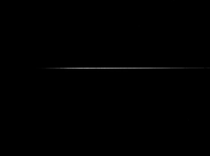

Thanks for the fast feedback, Robin. I will follow your advice. The attached image of Alnitak was taken after I attempted to focus the star by moving the guiding camera in until the star looked focused while keeping the spectrum focused. (If it is focused, this is...) So my questions are:
(1) If the slit is focused on the bench, should the star also be focused on the scope? Or, if the star is not focused at the scope, when I bring the star into focus is the slit still focused?
(2) Should I be worried that the spectrum is so wide? Seeing was not that good (2.5/5), it rarely is in eastern Kansas.
(3) What does the dark horizontal streak in the middle indicate? Still out of focus? Not centered? Normal on bright targets? Inquiring minds want to know.
Cheers, Ed
Hi Ed,
I would say from the width of the spectrum that the star was still quite a long way from focus at the slit and if you could have seen the slit in the guide camera at the time, I suspect it would have appeared out of focus, even when the star was in focus. (You could test this by moving the telescope focus until the spectrum image is at its narrowest. At that point the star will be in focus at the slit.) Compare with the attached raw image from my Alpy for example (C11 ~f6 ~3 arcsec seeing)
Remember we are looking in a mirror in the guide camera image, not a ground glass screen like in an SLR viewfinder for example. This means that if the slit is not in focus in the guide camera it is quite possible for the star to be in focus in the guide camera camera but actually be out of focus at the slit, (giving the wide spectrum.) The way to be sure the star is in focus at the slit is to focus the guide camera on the slit first. Then if the star is in focus in the guide camera it will also be in focus at the slit. From that point you can then if you want fine tune to maximise the light in the spectrum reaching the imaging camera.
Note that the focus of the spectrum lines however is completely independent of what is happening ahead of the slit (as you can see from the nice sharp lines you are still getting even with the star out of focus) so you don't need to worry about the quality of your spectrum resolution even if the star is not focused, just that you will be potentially losing a lot of light if the star is not in focus at the slit.
Hi Robin:
Many thanks for your patient tutoring. Your analysis makes complete sense. I think I understand enough now to make another "education" run the next clear night. I am saving all the mistakes as diagnostic tools. I find it valuable to know what images look like when they are not optimal since I tend to learn by my mistakes.
Cheers, Ed
Cheers, Ed
