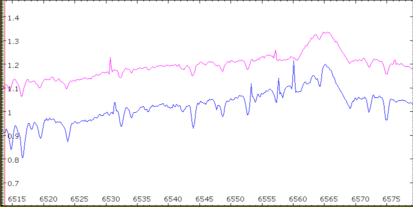

Re: Alpha Camelopardalis
Ok first comparison of Alpha Cam from two nights ago in blue and last night in pink.
Quite a few noticeable differences...
- AlphaCamComparison.GIF (8.51 KiB) Viewed 22507 times
Hi John,
i'm happy that your guest has leaved. So now you're on the right time for gathering spectra during bad weather
Alp Cam seems not to move between your two spectra. What are the narrow peaks you have above the continuum ? Cosmic or Real ?
Amitiés
thierry
Ps:planning a rendez vous one of these night ?
Amitiés
thierry

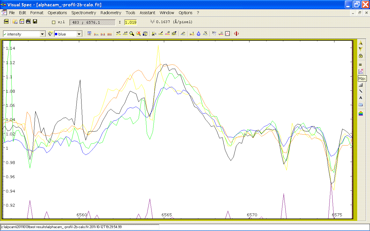

Preliminary results of my study of Alpha Cam over the last week.
Diagram shows changes in the broad Halpha emission line over 5 nights. The line shape changes from being symmetric to being asymmetric.
I now want to learn how to remove cosmics and tellurics as there are a few of these in the spectra - anyone got any comments on best way of doing this.
cheers
John
cheers
John

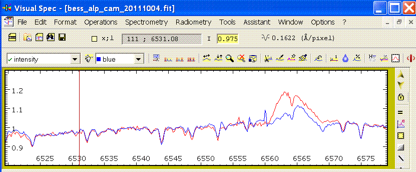

Another picture this time showing two spectra from 4th Oct in blue and 17th Oct in red of the pretty dramatic changes in the Halpha line of Alpha Cam.
John
John
- alphacamcomparison4thand17thOct.GIF (25.78 KiB) Viewed 22464 times

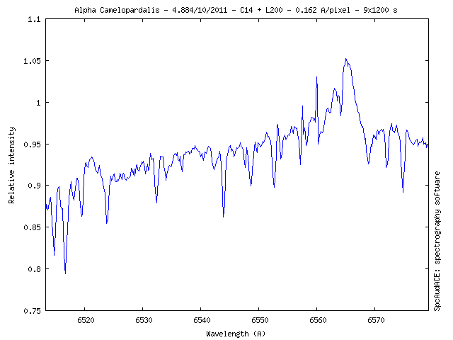

Bonsoir
Un spectre de Alp Cam dans L’UV realisé avec UVEX4 fente 15microns.
