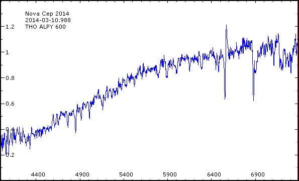

Re: Nova Cephei 2014
Here is mine from a few hours earlier (rather low, skimming the trees)
edit: updated graph with better subtraction of sky lines

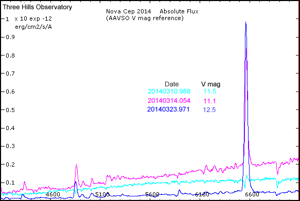

Here is the evolution (in absolute flux using AAVSO V mag as reference)
It is getting hard to guide on the slit at mag 12.5 (3sec exposures on the DSI Pro) and there do not seem to be any alternative field stars
