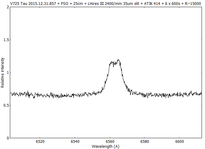

- Posts: 420
Re: ATEL #6043 Be Star HD 245770
Dear Paolo,
I've taken an hour for it on 31-DEC: and tried VSpec Gauss fit to measure EW, but I'm new to this process and result varied highly upon selecting an interval.
I'll send it to the ARAS DB along with other bunch of spectra I'm reviweing at the moment.
Did a 2nd shoot some hours later (seems as if the line shape had changed), but don't dare to publish it due to sky conditions and poor SNR.
Possibly needs others to shoot it further (at any resolution), I'm serivcing my eq6 mechanics these weeks and + sky/fog conditions are not the best.
- Posts: 578
Very good spectrum Peter! Not easy with that resolving power. The line shape has changed a lot but my mid-res observation is very old (april 2014). Very interesting the fast changes you detected, we could try time resolved spectroscopy (I think I'll use the 1200 l/mm grating).
Here the weather is very bad so I cannot observe too. In a few days should improve (I hope). Meanwhile let's check the Astronomer's telegram.

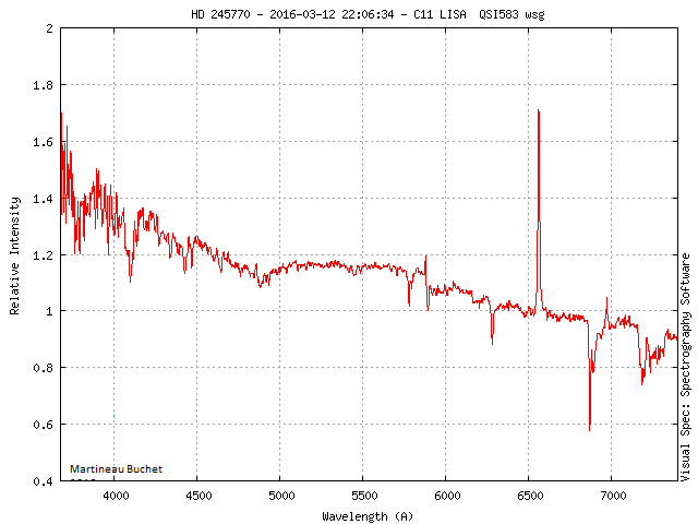

Here attached our contribution in the follow-up of this star HD 245770 or V 725 Tau with its peculiarity of the line He I 5876 A.
Cordially
Yolande Buchet
Gérard Martineau
Ci jointe notre contribution dans le suivi de cette étoile HD 245770 ou V 725 Tau avec sa particularité de la raie He I 5876 A.
Cordialement
Yolande Buchet
Gérard Martineau
Cordially
Yolande Buchet
Gérard Martineau
Cordialement
Yolande Buchet
Gérard Martineau
