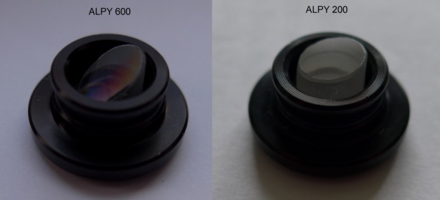

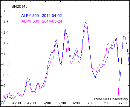

For some time now I have had an aim to build a spectrograph capable of identifying supernovae discovered by amateurs. This needs high sensitivity (>mag17) but only at low resolution and SNR (R~ 50-80 at SNR ~20 would probably be enough) To follow this dream I have fitted a 200 l/mm grism to my ALPY, replacing the standard 600 l/mm version. (see attached photos)
As well as concentrating the spectrum ~4x due to the lower dispersion, the 200 l/mm grating (made using the same master used for the Star Analyser 200) is significantly more efficent than the original 600l/mm grating (This is typical of transmission gratings where increasing number of lines significantly affects the throughput of the grating)
The resolution is only R~130 at 6000A, similar to that of the Star Analyser but sufficient for indentifying supernovae for example. Being a slit spectrograph, it has important advantages over the slitless Star Analyser of no intereference from other stars and spectra in the same field, a very reduced background from the sky or parent galaxy and what remains is easier to remove.

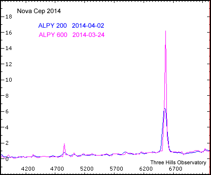

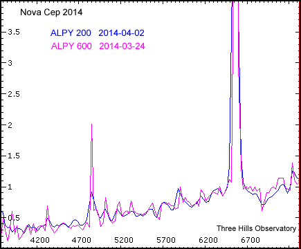

Attached are first light spectra of SN2014J and Nova Cep 2014 (at around mag 12.5-13) compared with the same objects a few days earlier with the ALPY600. The ALPY 200 exposures were 15min compared with 1 hr for the ALPY 600. To go much deeper I am going to need a better guide camera than my current DSI Pro

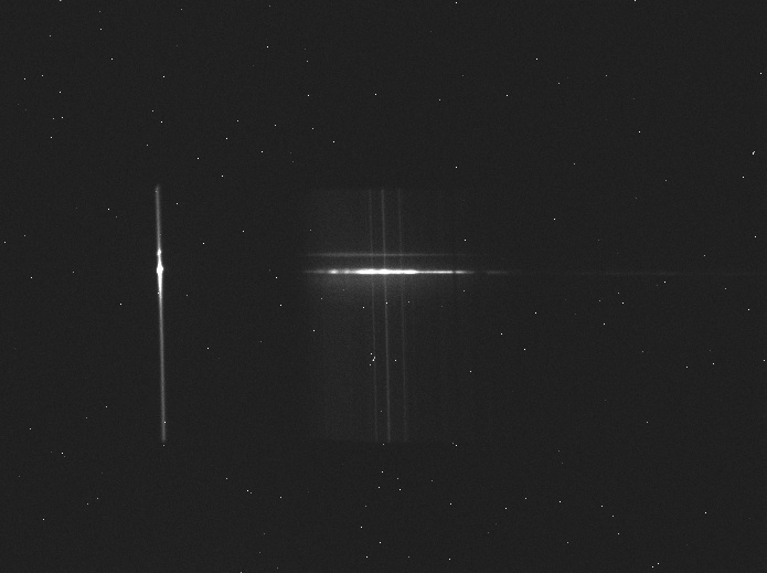

This is what a single 300 sec raw exposure looks like (SN2014J, ALPY200 C11 ATK314L+ 2x binned)

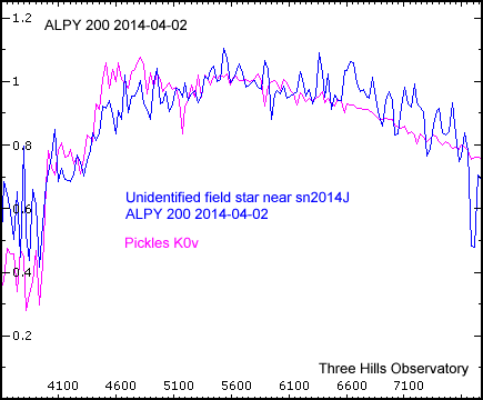

Here is the spectrum of the unidentified star accidentally caught in the slit just above sn2014J in the image above. Overlaid is a K0v Pickles spectrum for comparison. Based on the counts it is ~10x fainter than sn2014j so ~mag 15.5. The SNR is ~25 in 15min total exposure.

It is a bespoke piece of glass from Paton Hawksley matching the dimensions of the standard one in the ALPY but with the appropriate angle and with the 200 l/mm grating added using the SA200 master. It was mounted in a blank holder from Shelyak. I guess if there is enough interest it would be straightforward for Shelyak to offer it mounted in the holder as an alternative to the 600 grism. It means stripping down the core module to change it (you just have to make sure you dont tip out the other optics when you remove the grism and not to touch the grating of course) but this is straightforward enough and there is no difficult retuning to do for example.

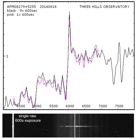

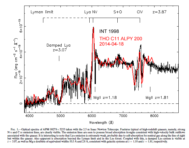

I am now using the ATK16IC-S as a guide camera on the ALPY200. By using the subframe function in PHD2 I can get a fast enough update for guiding.
First test was on the famous gravitationally lensed QSO APM08279+5255 at mag 15.2 and z =3.87 which I had measured some years ago using the Star Analyser
http://www.threehillsobservatory.co.uk/ ... tra_22.htm
I could only see the target in >10 sec exposures in the ALPY guide camera so I first moved the target close to the slit using full frame long exposures and then started guiding using 3 sec sub frame exposures on a ~mag 13 star in the same field. I then moved the guide position 1 pixel at a time until the target could be seen in the spectrograph slit in 60 sec exposure images. The guide position was adjusted to maximise the signal in the slit and then a series of 600 sec exposures were recorded.
Attached is the result (a single 600 sec exposure and a sum of 9x 600 sec. click to view the 600 sec raw image)
This is also compared overlaid on the discovery spectrum from 1998 using the 2.5m Isac Newton Telescope from this paper
http://iopscience.iop.org/0004-637X/505/2/529
The main features are clear even in a single 600 sec exposure and the 9x 600s spectrum is in good agreement with the professional spectrum, including features in the IR
