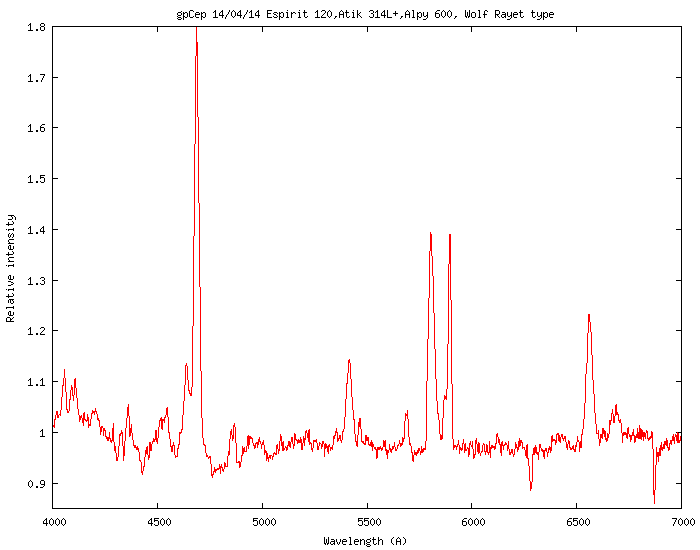

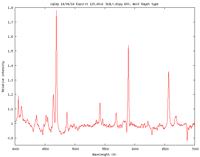

Hi
Tried a couple of WR type stars in Cepheus tonight as observing due south hopeless with the near full Moon.
Hopefully my response is improving! Not sure of the image size for posting as the bottom of the plots seem to cut off?
thanks for looking
Steve

Your instrument response correction does not seem to be working right. These WR stars have a blue continuum. Compare for example your results with Christian Buil's here
http://www.astrosurf.com/buil/survey/wr ... stars.html
(CQ Cep = WR155, GP Cep =WR153)
As a first step, I suggest checking your calculated instrument response by reducing your reference star spectrum using it. The result should of course be very close to the library spectrum for that star.

Also there are several emission lines which appear in your spectra which are absent in Christian's and are common to both of your spectra , notably one which looks like Na D lines. I suspect these may be from the sky background. Did you do a background subtraction?

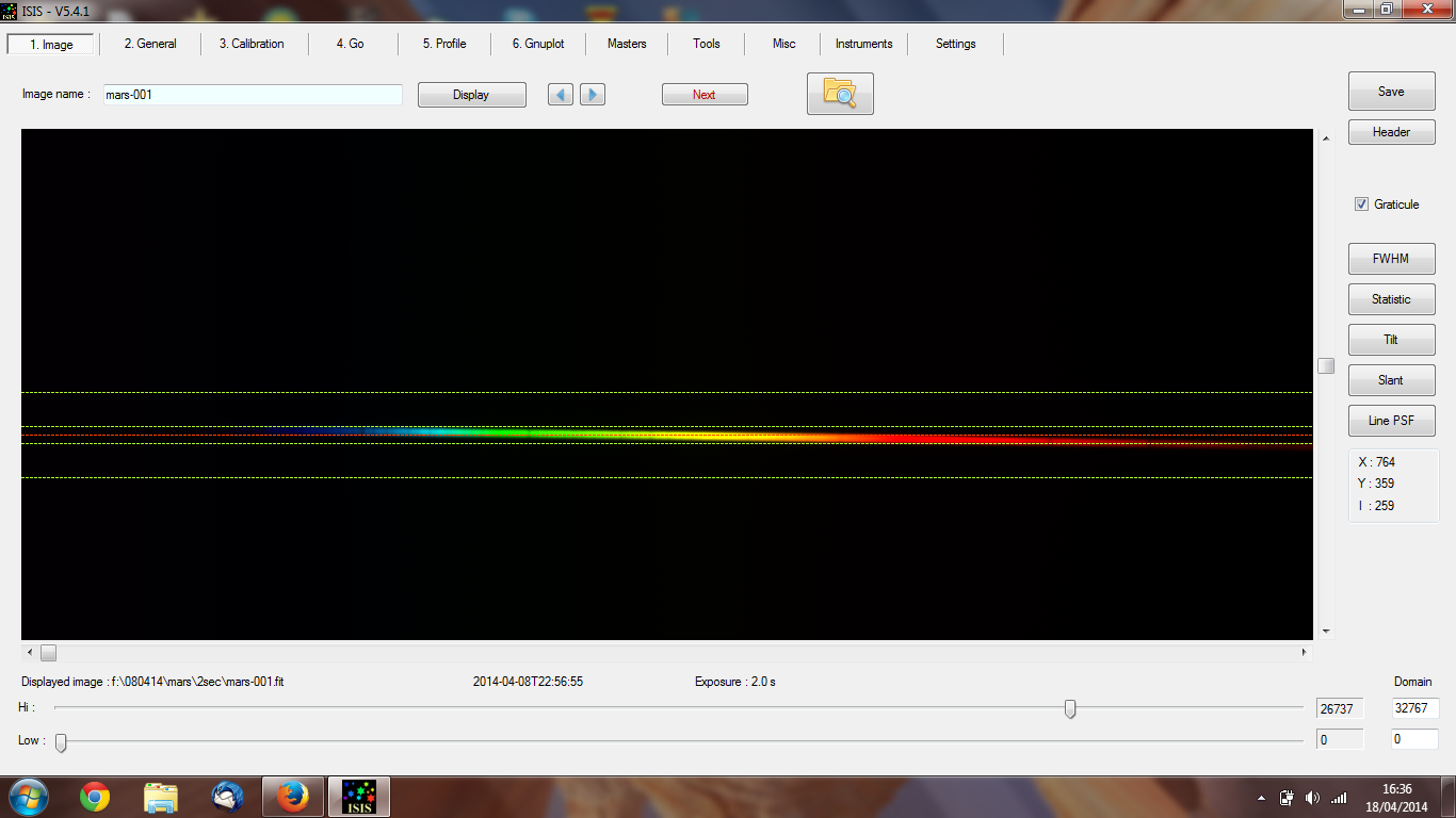

Not sure I quite described it correctly but I was wondering if say this spectrum of Mars I did the other evening (for some reason it comes out in colour with ISIS?)
was entered as the reference image as you can see it is tilted by about 0.7 degs and the sky subtraction lines can be opened to include the whole spectrum, now should I be correcting that tilt on this image and getting the subtraction lines parallel before I process with ISIS or leave it as it is?. I assume ISIS will rotate the remaining images by 0.7 degs! Leaving the image as is I seem to end up with an RMS of 0.1 to 0.2 which seems ok
best
Steve

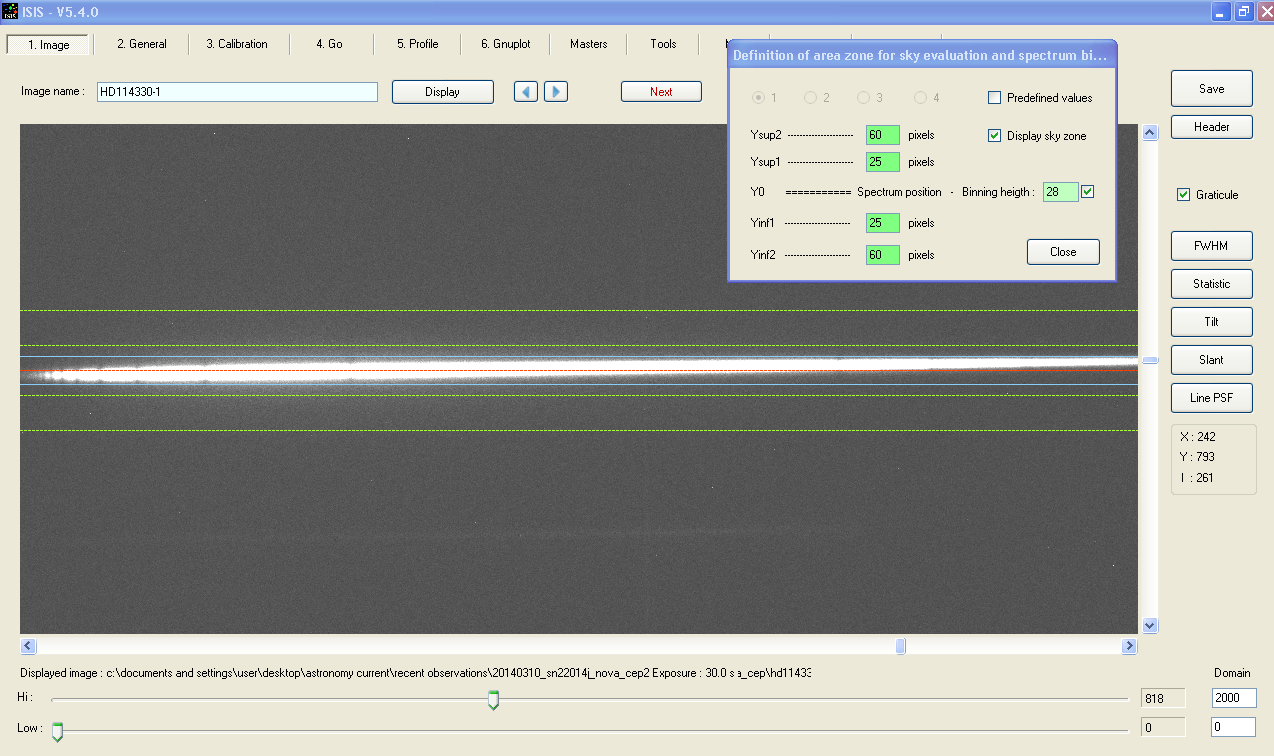

I cannot see the binning zone in your image (there should be blue limit lines either side of the red dotted centre line). Is the inner sky zone the same as the binning limits by any chance or perhaps the binning zone is set very wide? ) Unlike RSpec, in ISIS you can set all the zones independently which stops the risk of cross contamination between the two. Attached is an example of how I would set up the limits in these circumstances. I stretch the image until I can see clearly the full extent of the spectrum and set the centre line and binning zone to just include all signs of the spectrum, including any tilt
(This is probably wider than needed as I expect ISIS does the geometric correction then applies the binning limits but unfortunately you cannot visualise this easily in ISIS. It would be better if ISIS did the geometric corrections and summed the images first and then allowed you to set the binning limits looking at the corrected and summed image - but I digress...)
I then set the sky background regions (yellow dotted lines) slightly away from the binning region to make absolutely sure of no cross contamination of the background by the spectrum.
I then measure the tilt on the spectrum and the smile/slant on a lamp or sky background line. ISIS picks these figures up and does all the necessary corrections when you press "go" producing a fully corrected image and a binned spectrum profile.
None of this will affect the wavelength calibration (provided the same geometric corrections apply to both reference and target) but incorrect setting of binning and sky zones can affect the shape of the spectrum and hence the instrument response correction.

Ah! my bad !!! I mistook the yellow dotted lines for the binning lines Doh!! So on that basis I haven`t done any sky subtraction yet :oops:
