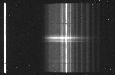

This supernova was discovered by amateur Dave Grennan. Attached is my spectrum with the ALPY 200 (At mag ~16.5 This is a new record brightness for me)

sn2104AS at mag ~16.5 with ALPY 200

Nice catch Robin !
Did you find out what those two horizontal dark lines were?

They are just the outer limits of the sky background subtraction regions. ISIS displays them a guidelines even if as in this case the background was not subtracted. You can see here that (as requested) ISIS has cleared up all the transient hot pixels in the region between the two limits.
I was interested in an estimate of the SNR in the resulting spectrum so I measured the variability between spectra produced from the individual exposures. The SNR works out at ~30 (in a ~25A bin size) for the combined exposures compared with a theoretical value of ~45 based on the counts. Not too bad considering the deterioration in SNR that must inevitably take place subtracting the large background.
