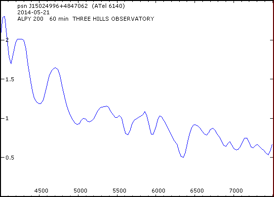

Another faint (~mag 16) supernova with the ALPY 200.
psnJ15024996+4847062 was discovered by amateurs R. Gagliano, Jack Newton, and Tim Puckett: 2014.5.13.240

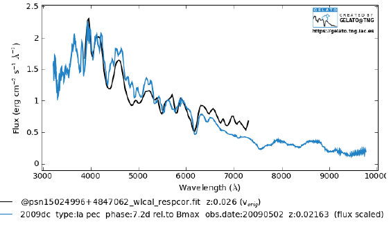

It is identified with high confidence as a type Ia from my spectrum using GELATO
psnJ15024996+4847062 at mag ~16 with ALPY 200
- GELATO best fit

- calibrated spectrum
- psnJ15024996+4847062_20140521_ALPY200.png (8.98 KiB) Viewed 3564 times

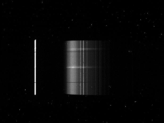

- background subtracted
- psnJ15024996+4847_20140521_ALPY200_bgsub.jpg (26.26 KiB) Viewed 3564 times

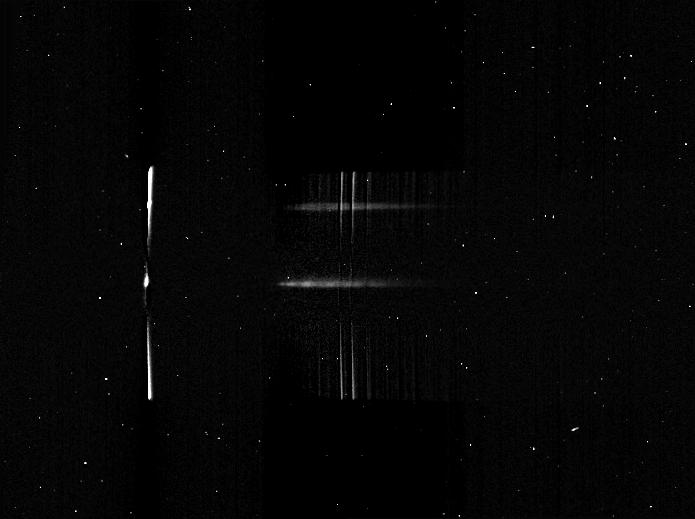

- raw spectrum image
- psnJ15024996+4847_20140521_ALPY200.jpg (13.08 KiB) Viewed 3564 times

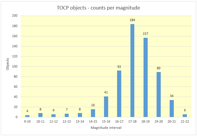

I made an approximate statistic from actual CBAT TOCP page (transient magnitude at discover time):
The number of accessible objects greatly increases above mag 15. These excellent performances allow to do a concrete and systematic research.
