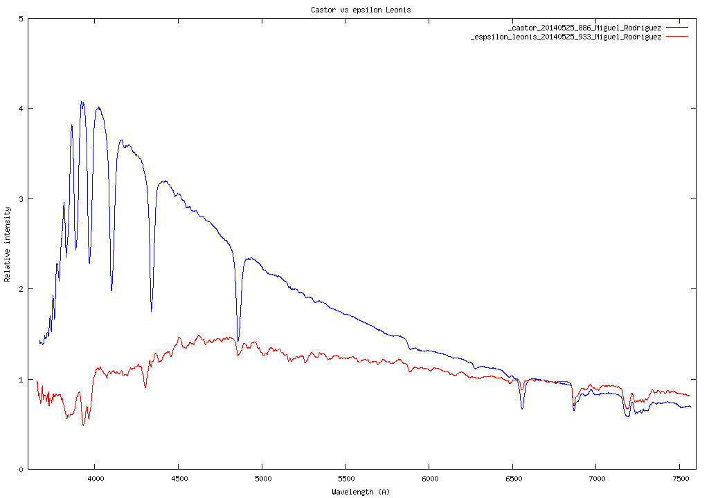

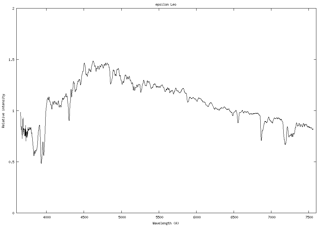

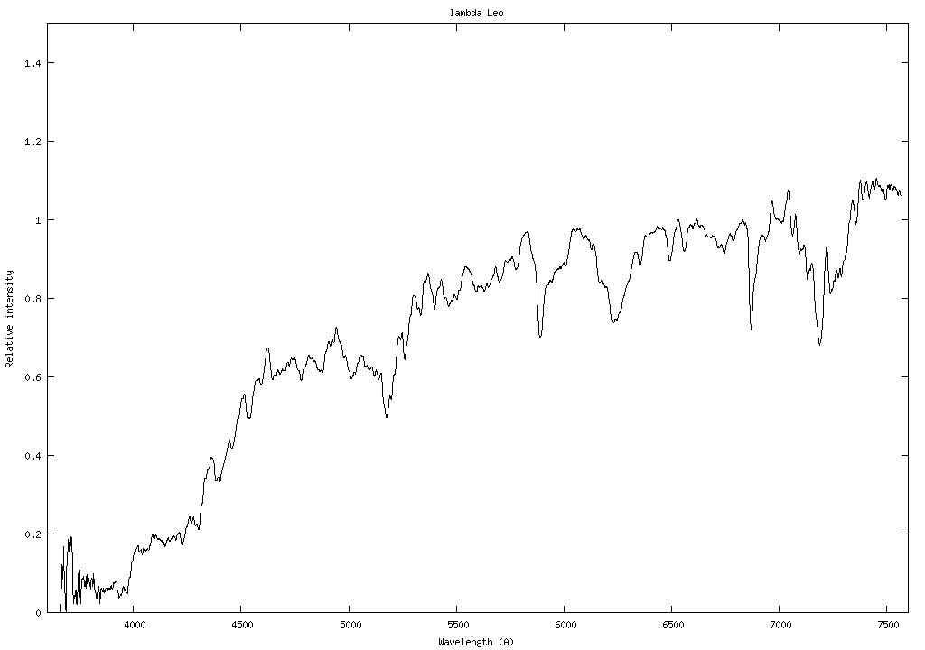

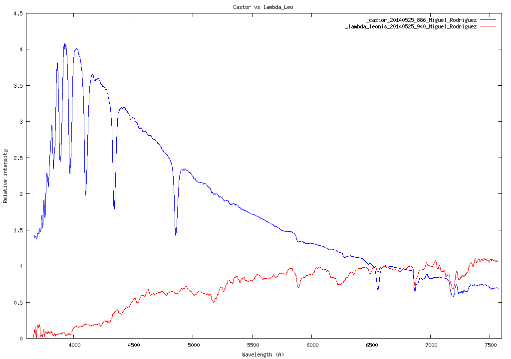

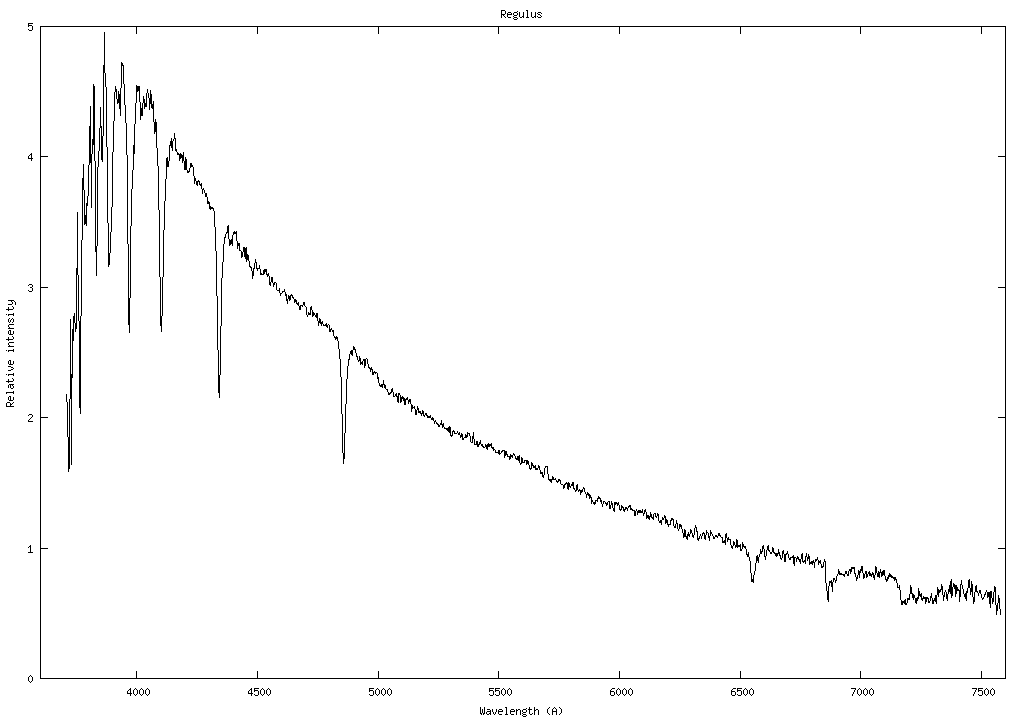

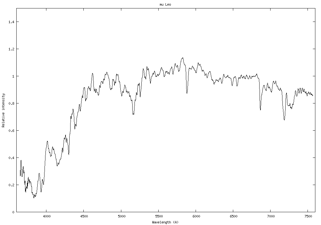

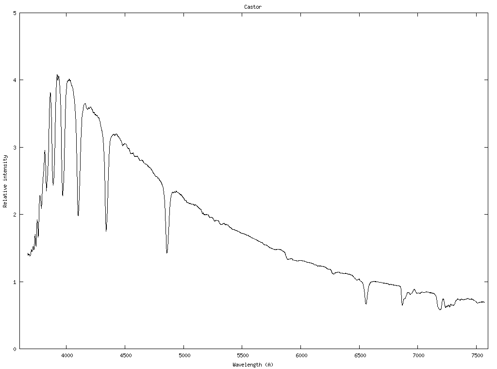

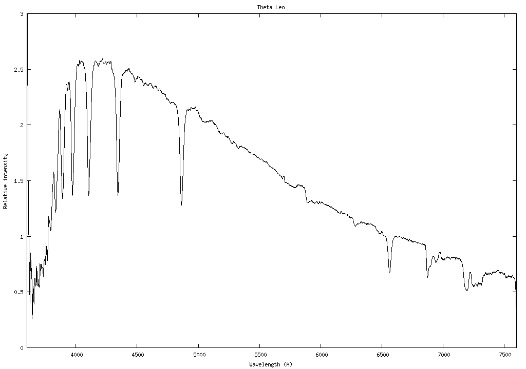

At this time I have succeded making spectra of bright stars, specially B and A, to get response calibration. Then I've tried stars of different spectral type. It is exciting to record different spectra from stars that looks the same in the image frame. I have attached spectral profiles of Regulus (B8IVn), mu Leo (K2III), lambda Leo (K5III), theta Leo (A2V), eta Leo (A0Ib), epsilon Leo (G1IIC), the jovian moon Ganymede (compared to G2V spectrum) and R Leo, as a sample of these my first spectroscopic nights.
- Castor_vs_lambda_Leo.png (9.54 KiB) Viewed 7988 times
- Castor_vs_eps_leo.png (8.94 KiB) Viewed 7988 times
- Castor_20140525_886_Miguel_Rodriguez.png (6.53 KiB) Viewed 7988 times
- _mu_leonis_20140525_925_Miguel_Rodriguez.png (8.08 KiB) Viewed 7988 times
- Thetaleo_20140525_015_Miguel_Rodriguez.png (7.24 KiB) Viewed 7988 times
- Regulus_20140523_918_Miguel_Rodriguez.png (7.53 KiB) Viewed 7988 times

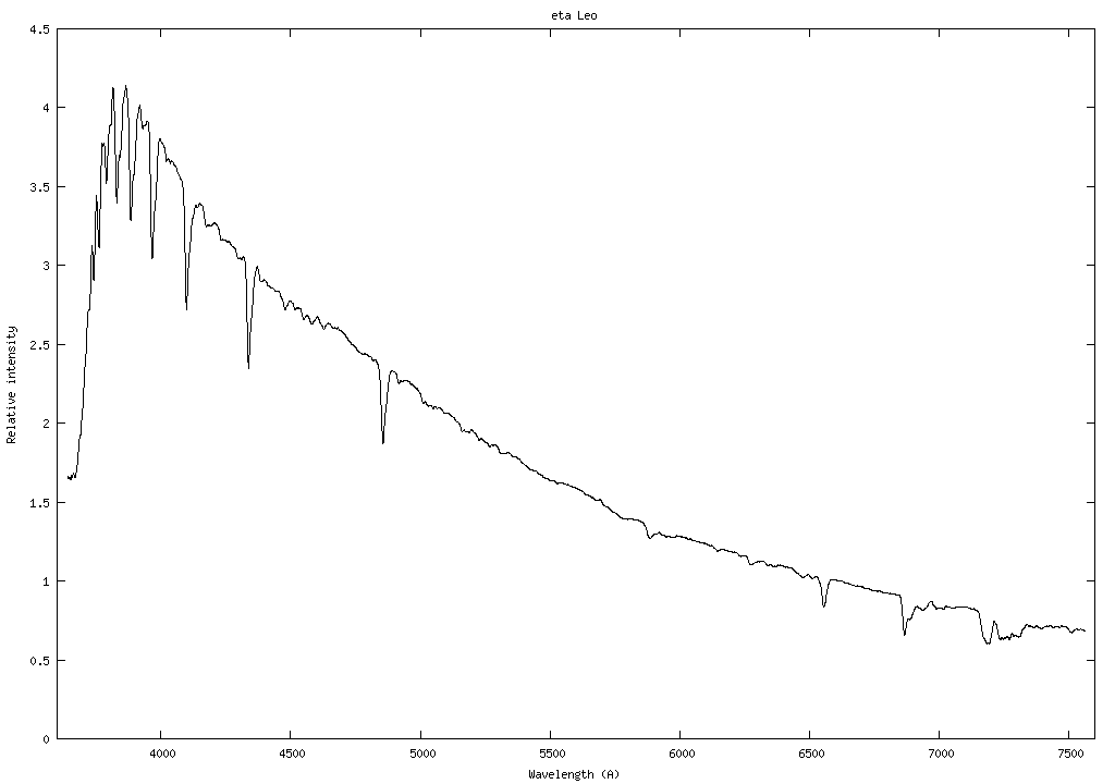

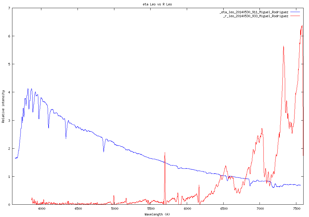

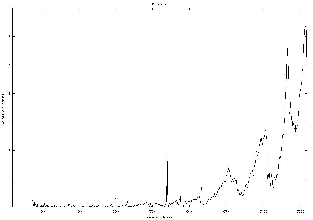

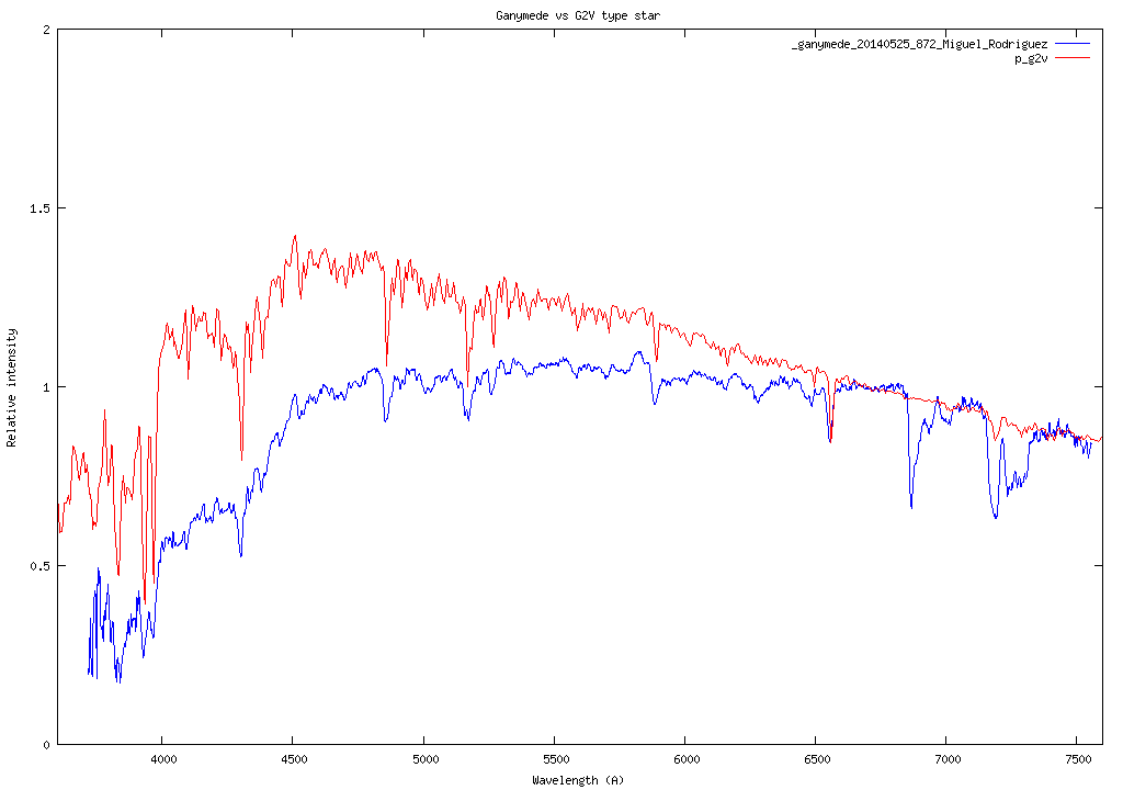

Some other spectra:
- eta_leo_20140530_911_Miguel_Rodriguez.png (6.41 KiB) Viewed 7987 times
- R_leo_20140530_933_Miguel_Rodriguez.png (6.86 KiB) Viewed 7987 times
- eta_Leo_vs_R_Leo.png (9.48 KiB) Viewed 7987 times
- Lambda_leonis_20140525_940_Miguel_Rodriguez.png (8.13 KiB) Viewed 7987 times
- Ganymede_vs_G2V.png (10.83 KiB) Viewed 7987 times
- Epsilon_leonis_20140525_933_Miguel_Rodriguez.png (7.3 KiB) Viewed 7987 times

Hello Miguel,
Welcome in spectroscopy and on Aras Forum
The first steps looks very correct
About R Leo, there's a problem : such emissions doesn't exist. In Miras stars, you have -essentially- Balmer emissions
Si a spectrum of R Leo : http://www.astronomie-amateur.fr/feuill ... ctres.html
Perhaps an issue from sky substraction
All the best and show us other results

Re: First results with Alpy600
Thanks for your kind comments François, I realize that these emission lines in R Leo spectrum are not from the star, they have to be surely from light polution.

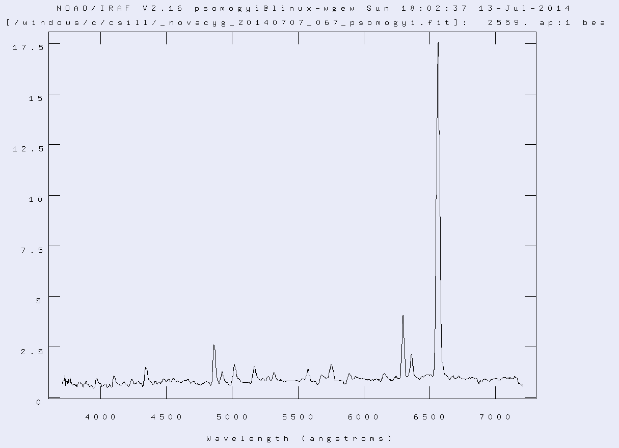

Hi, just introduced myself, now sending the very first spectra Nova Cyg 2014 and being curious whether it's ok for the database (+ will have Z And and CI Cyg of the same night):
I had to write a script to solve DATE-OBS field because the Orion studio puts there a different field "DATE_OBS" and in a non-standard format (using Orion Starshoot G3 mono as detector).
Reference star: 21-Vul (used for response curve and wavelength)
Response curve was a bit tricky to cope with, because I had to remove telluric holes above 6800A by hand for continuum fit, but I couldn't find any exact method for that, except that I would remove telluric lines completely by a simple divide + filter, but keeping telluric lines is a recommendation for this database.
So now telluric lines kept in the final profile as recommended, but manual intervention was needed for this case.
Flat was done by detaching Alpy from the scope on the table in a room, using halogen lamp, reflected from a white paper in front of the Alpy, experienced a cut in the UV when it were behind the paper.
I've downloaded a few other .fit files from database comparing to them, and looks similar, except that my resolution looks not enough to find the hole near Ha (near Hb it is OK).
