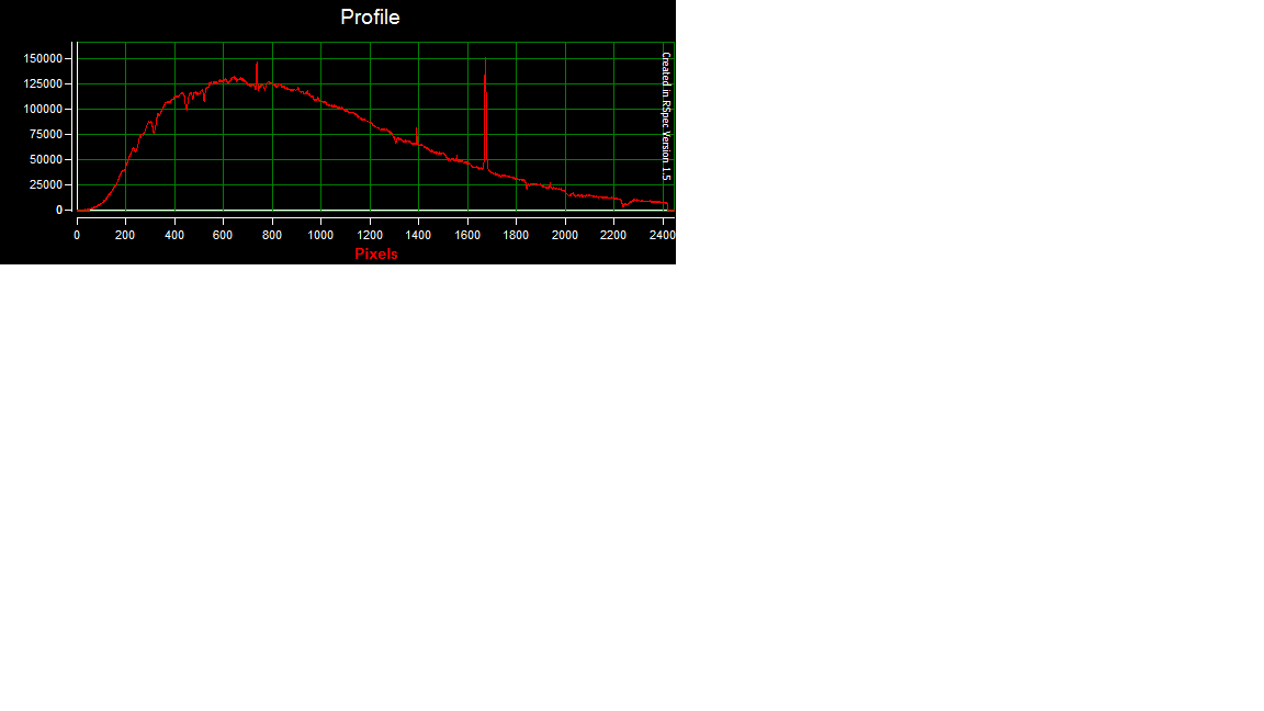

I find HD189847 / HIP98525 to be in emission. I can't find it in Bess database and Simbad has it as B7V. From a quick look at the references I see no indication of emission. I am now clouded out.
I also find the star HD192445 / HIP99667 to show emission in H alpha and H beta.
See attached
Regards Andrew
See attached
Regards Andrew
- HD192445
- HIP 99667 HD192445.png (13.47 KiB) Viewed 9085 times
- HD 189947
- HIP 98525 HD 189947.png (8.04 KiB) Viewed 9085 times

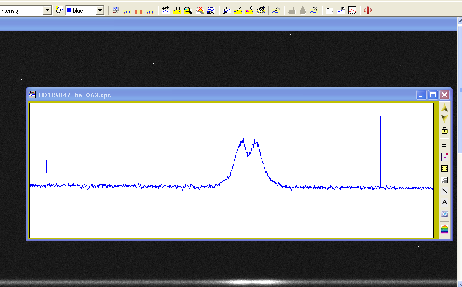

Re: HD189847 in emission
Confirmed (LHIRES 2400)
- HD189847_halpha_20140924.png (214.13 KiB) Viewed 9083 times
Andrew Smith
- Posts: 321
Please note I misslabled the images. The text has the correct star numbers.
Regards Andrew
Hi Andrew,
It looks like you have just been beaten to this discovery by a week
This paper published on ArXiv lists HD189847 (and HD40724 and 126 other stars) as a new Be stars
http://arxiv.org/abs/1409.4668
see 3.4
That is really bad luck but it does show the capability of your system
see 3.4

I have analysed the paper Robin unearthed and of the new Be stars 12 are in my current search magnitude range (5.5 to 7.5). This compares to 270 in the current BeSS data base an addition of about 4.5%. I think there are still more to find and will continue to search.
Regards Andrew
