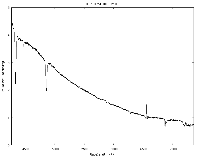

Hi All I report this observation as much for advice as anything else. I found a B8V star last night that was in emission and not in BeSS.
Data as follows:
HD181751
HIP 95109
RA 19 20 54.3
Dec +22 11 55.6
B 6.47
V 6.55
Sp B8V
BeSS N
2014 09 21
Status e
See attached raw spectra. I am not sure if B8V counts as a classical Be star. This leads to the question of what to do with the B star survey results that turn up suspected Be candidates. I feel we could do with some guidelines to filter the suspects but I am not competent to do this. Any ideas?
Regards Andrew

Thierry Lemoult
- Posts: 136
Re: HD181751 in emission
Congratulation Andrews. I'm not a Be specialist, but i think that should be a new Be according the Jaschek et al. (1981) & Collins (1987) Definition:
"A non-supergiant B star whose spectrum has, or had at some time, one or more Balmer lines in emission"
It's a main sequence star according the "V" in spectral type. I just take a look a CDS bibliography, a found nothing about emission for this star.
I Think Valerie Desnoux can help you. Do not hesitate to contact her.
A high resolution spectrum of this bright star will be usefull. Also, we need a calibrated spectrum: wavelength and a corrected instrumental response.
I will try to obtain a spectrum tonight.
Regards
Thierry Lemoult

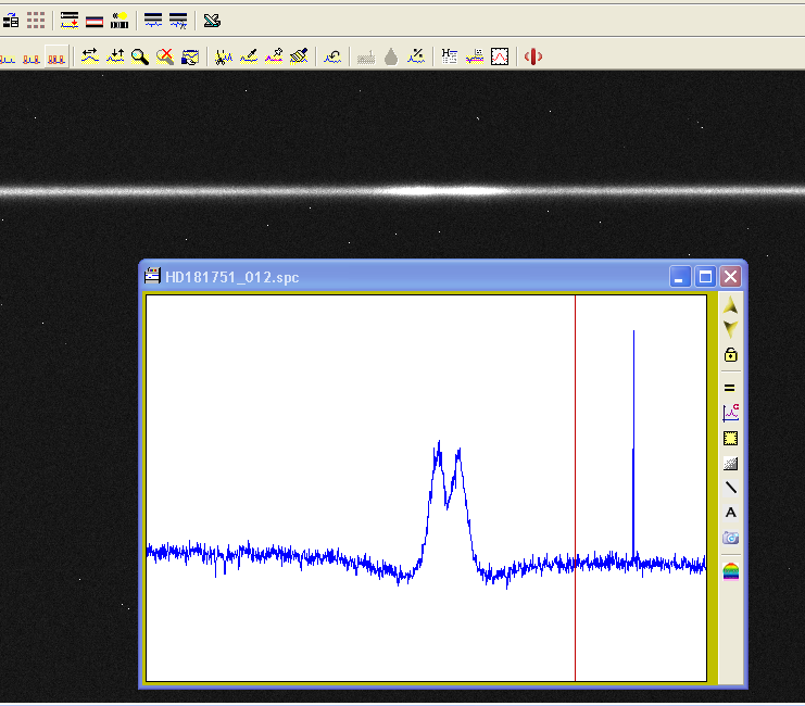

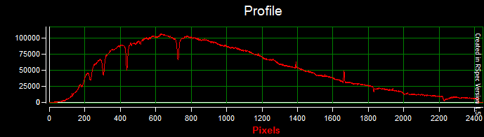

I can confirm the H alpha emission. See attached quick line profile with LHIRES III 2400 tonight.

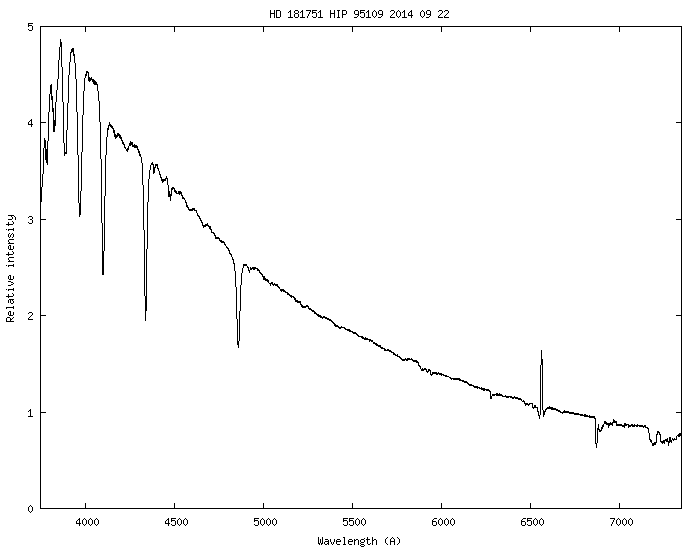

Andrew Smith
- Posts: 321
Firstly thanks Robin for your Hi Res confirmation spectra. I attach a spectra taken 2014 09 22 with the LISA and a 23 micron slit R ~ 1000. Again the images were obtained automatically. HIP 95560 A0V was used to provide the instrument response.
Regards Andrew
Regards Andrew

Andrew Smith
- Posts: 321
Thierry Garrel, has pointed out it is included in the photometric HVAR Be catalog so it is not new. We need to develop a screening process. So and advice on where to look would be good.
Regards Andrew
