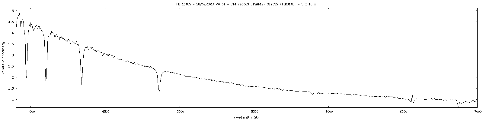

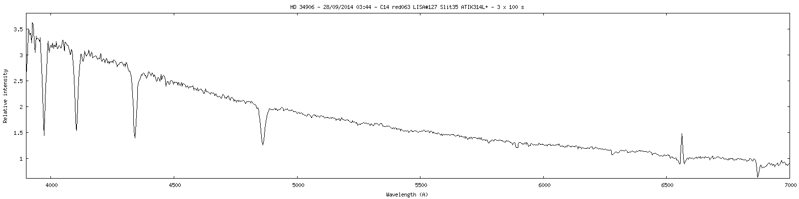

I just take a look at 64 B star obsrved this night and i find two new candidate:
HD 16485
HD 34906

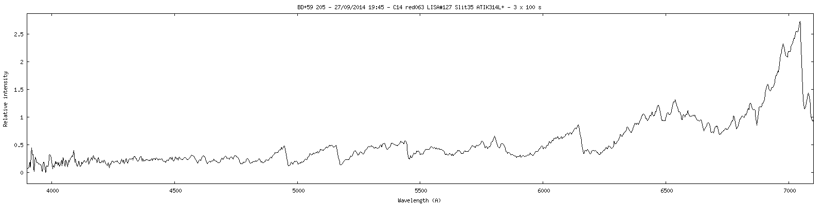

And also, find a mistake in spectral classification... BD+59 205 suppose to be a B1V according CDS Simbad but i find a spectral type look like "M4V star"
I control the guiding image, make a astrometrie, that the good astrometric position at 0.5 arsec.. And so so bright star in the region.

- _bd+59205_20140927_823_Thierry Lemoult.png (7.26 KiB) Viewed 10596 times
- _hd34906_20140928_156_Thierry Lemoult.png (6.92 KiB) Viewed 10597 times
- _hd16485_20140928_001_Thierry Lemoult.png (6.47 KiB) Viewed 10597 times
Skiff's database
http://vizier.u-strasbg.fr/viz-bin/VizieR?-source=B/mk
has 2 old references from 1959/1960 for this star. Both suggest a hot star (OB- and B2)
Has something happened to it?
Does the brightness look right in your spectrum? ( V mag 10.6 B mag 10.8 according to the Skiff reference )
Re: 2 additional candidates B in emmission
This paper from 1954 however lists BD+59 205 as a type N carbon star, magnitude 10.4
http://cdsads.u-strasbg.fr/cgi-bin/nph- ... .120..129N
number 43 in table 1b

Thanks Robin, i took a unfiltered picture with my electronic finder, i think i could use it for a estimation of the V magnitude.
I will do this tomorrow.
One thing sure, is the field, that the correct star in the slit.
Regards
Regards
Thierry Lemoult
- Posts: 136
I check the photometry of star BD+59 205 according the field camera. The unfiltere magnitude is about 10.8 +/-0.2
So that consistant with published photometry.

Thierry, a HR spectrum of HD16485 (double peak emission)
(C11 + VHIRES (7 x 600 sec expo.):
Nice Christian ! I will integrate this spectrum to the ARAS web page here: http://www.astrosurf.com/aras/be_candid ... idate.html as soon has you send me the fits file.
- Posts: 1432
C'est fait Thierry, et direct link from ARAS index page added!
