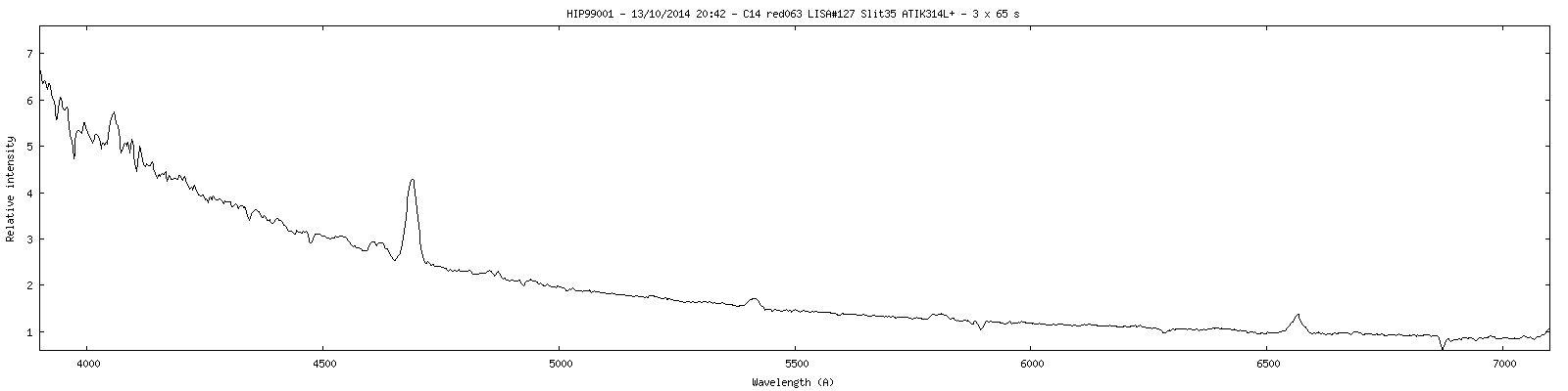

A emission star. H gamma, H beta, Ha. And the line are really broad.
Any idea ?
Strange HIP99001
Thierry Lemoult
- Posts: 136
Strange HIP99001
- _hip99001_20141013_863_Thierry Lemoult.png (5.57 KiB) Viewed 7272 times

Ooohhhh !!!
Looks like a Wolf Rayet or a Nova like
Could you send me the fit ?

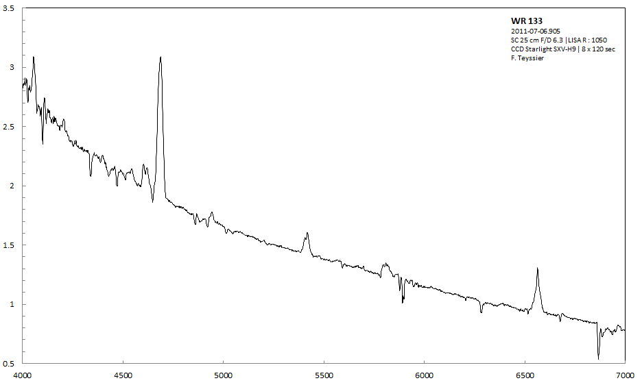

Re: Strange HIP99001
Hi Thierry,
WR133 (HIP99002, HD190918) is very close to this location (11 arcsec) and much brighter at Vmag 6.7 compared with 9.7
http://simbad.u-strasbg.fr/simbad/sim-b ... BAD+search
Is there any possibility that this is the wrong star or there is some contamination?
Hello Francois.
Your perfectly right ! The algorithm of guiding put the wrong star is ne slit.
I need to improve my program to manage this kind of situation. Today i need no brighter star close to 15 arcsec of the target.
Thierry
Thierry
