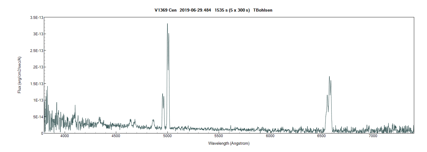

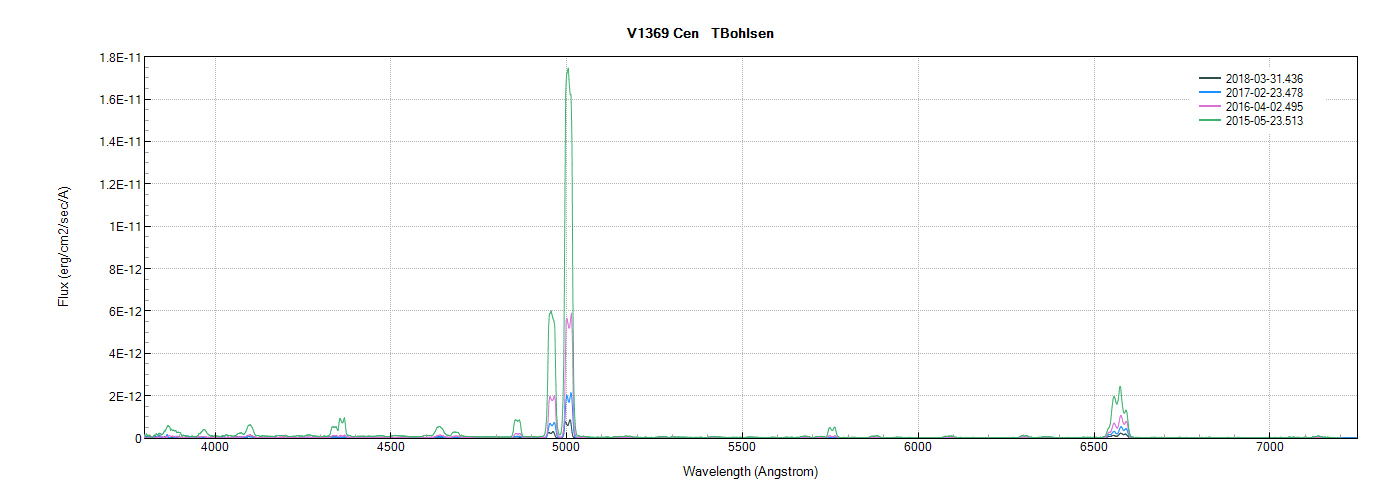

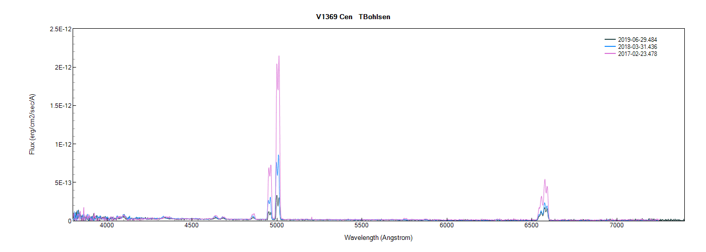

I am posting to this old thread as I have been following this old nova and have taken spectra approximately yearly for the since the intensive monitoring ceased. It has slowly dimmed and is now in the nebula phase. Currently it is V= 13.4
Terry
