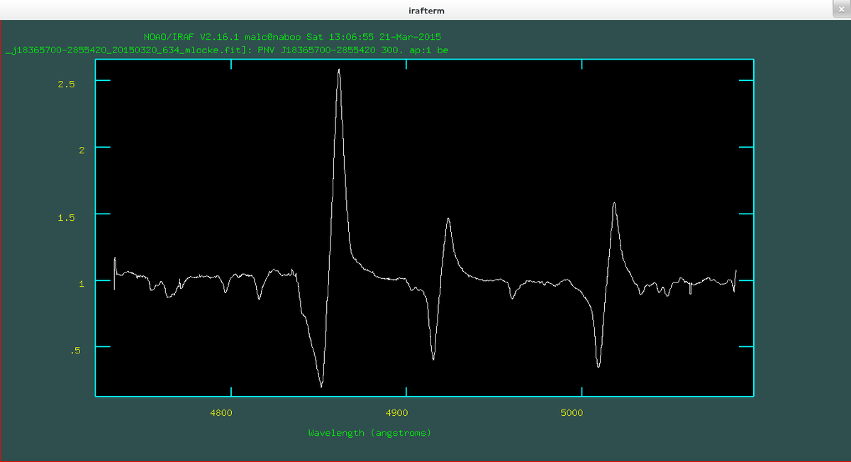

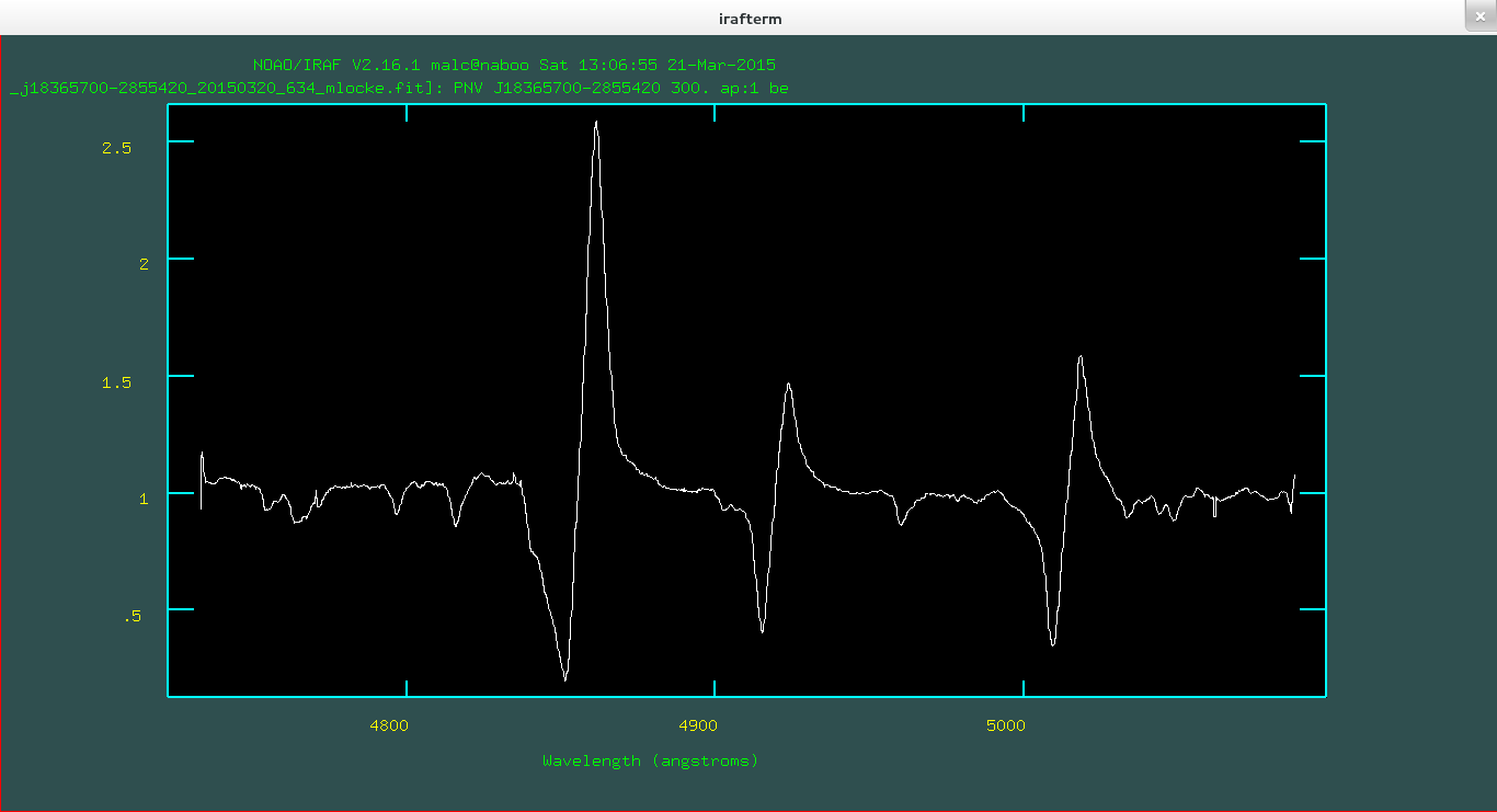

My spectrum of the H_beta region from 2015/03/20.634.
0.4m SCT, L200 @ 1800 l/mm, 24um slit, SBIG ST8. 12 x 300 seconds, R ~
9000.
No photometry but I made a visual estimate of 4.9. Considerable change
since the last spectrum in ARAS.
Jon

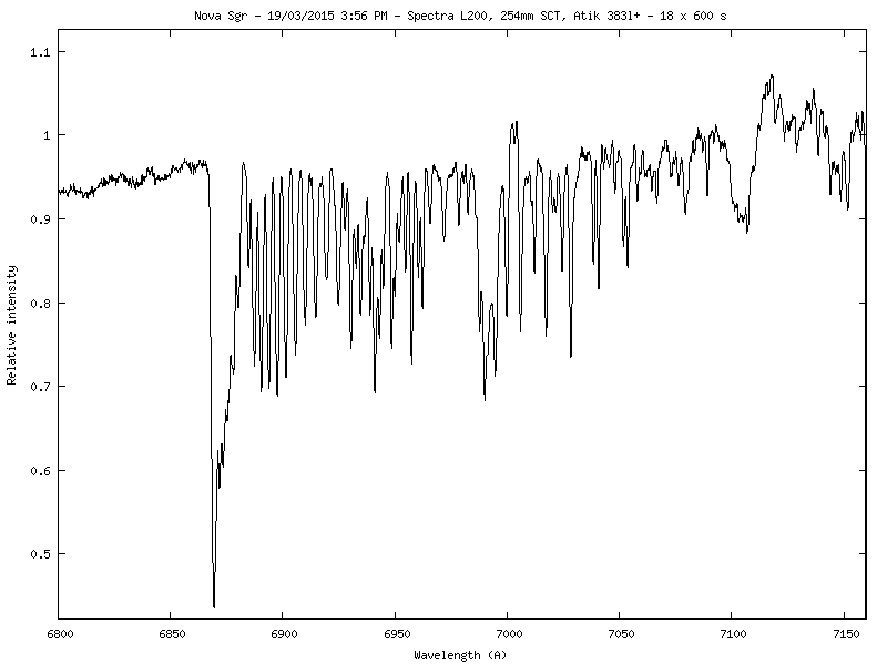

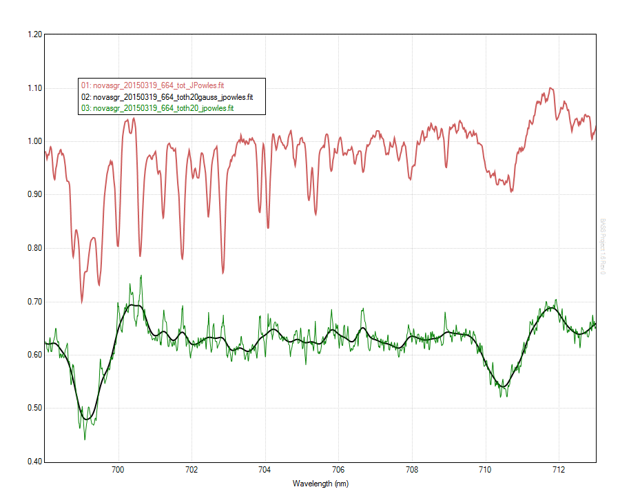

Here is a 3 hr spectrum from 19-3-2015, of the region 6800-7160, as requested by Steve Shore.
The OI line at 7003 and the CI line complex at 7115 are clearly visible, although the 7003 line is obscured by the heavy telluric lines. I've had a go at removing them, using the H2O tool in vspec and using the spectrum of the reference star I'm using (Phi Sgr). The tellrric-corrected spectrum is offset below, with a Gaussian filter applied to remove the artifacts.

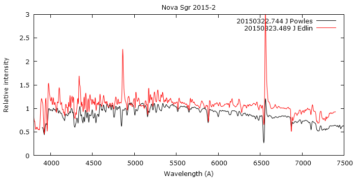

Re: Nova Sgr = PNV J18365700-2855420
Comparison of Jonathan Powles and Jim Edlin spectra
Impressive evolution in less than one day :
The ejecta is turning thin.
Have a look on Fe II absorptions.
Congratulation for these nice and interesting spectra

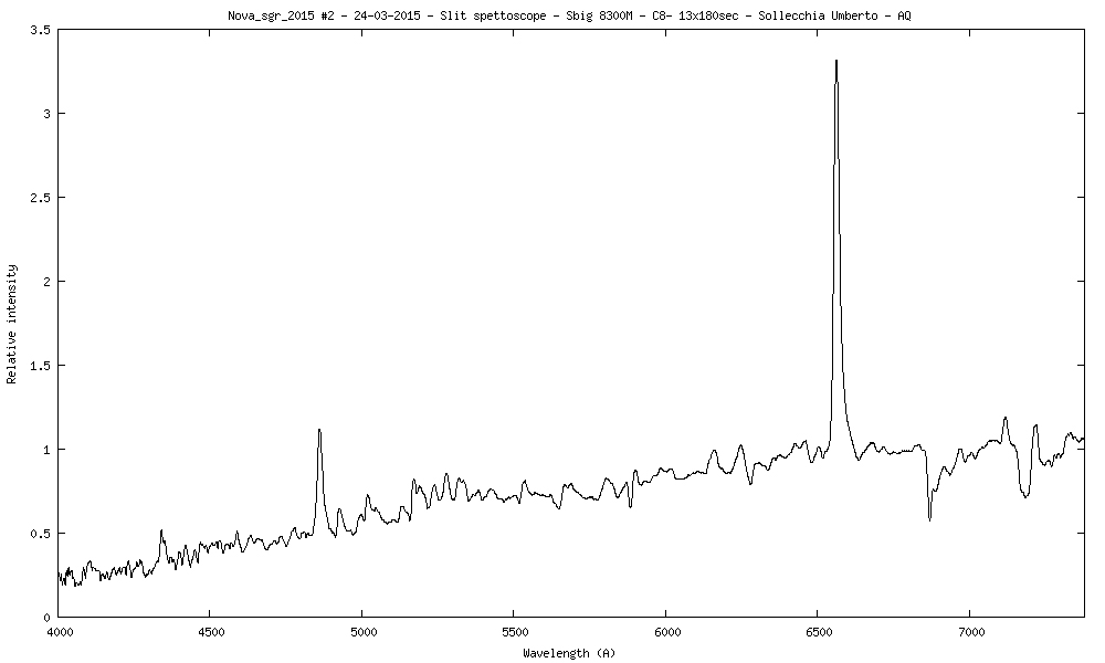

0bserved spectrum of nova . All data are reported on graph frame.
Due to very low altitude of target above the horizon and irregular clouds presence it is possible that the continuum is not well corrected.
Well done Unberto
Nice result at such an altitude
Of course, the spectrum is welcome in the data base
Regards,
James Edlin

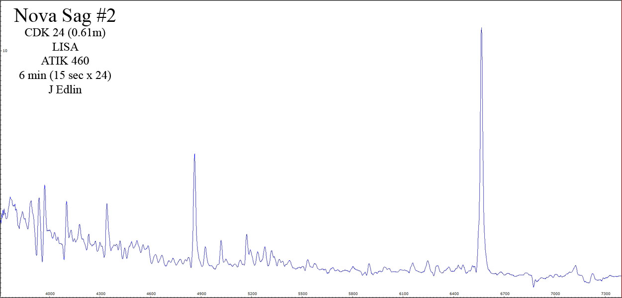

Clear night this morning. Spectrum of Nova Sag #2 with CDK 24 (0.61m) - LISA - Atik 460 ccd. Had to reduce exposure to 15 sec so as not to saturate the H alpha line. Total 6 min (15 sec x 24). Prior spectrum poor quality due to heavy haze and clouds.
Jim

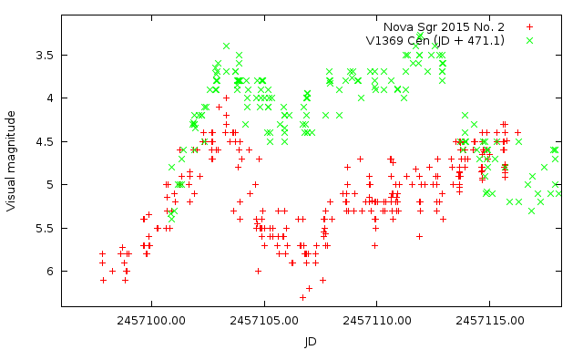

I remember V1369 Cen going through a very similar re-brightening after the first maximum, so I thought I would plot the two light curves together.
They are so far remarkably similar. Nova Sgr is maybe a little slower in the oscillations, it will be interesting to see if the similarities continue over a longer period.
