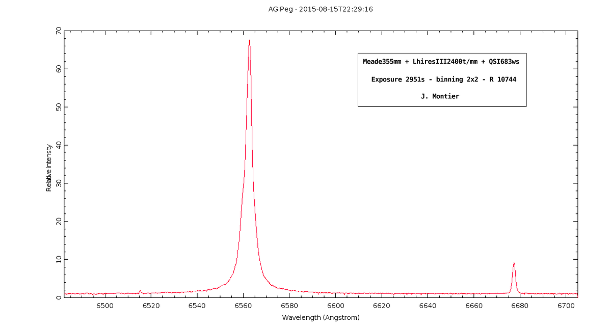

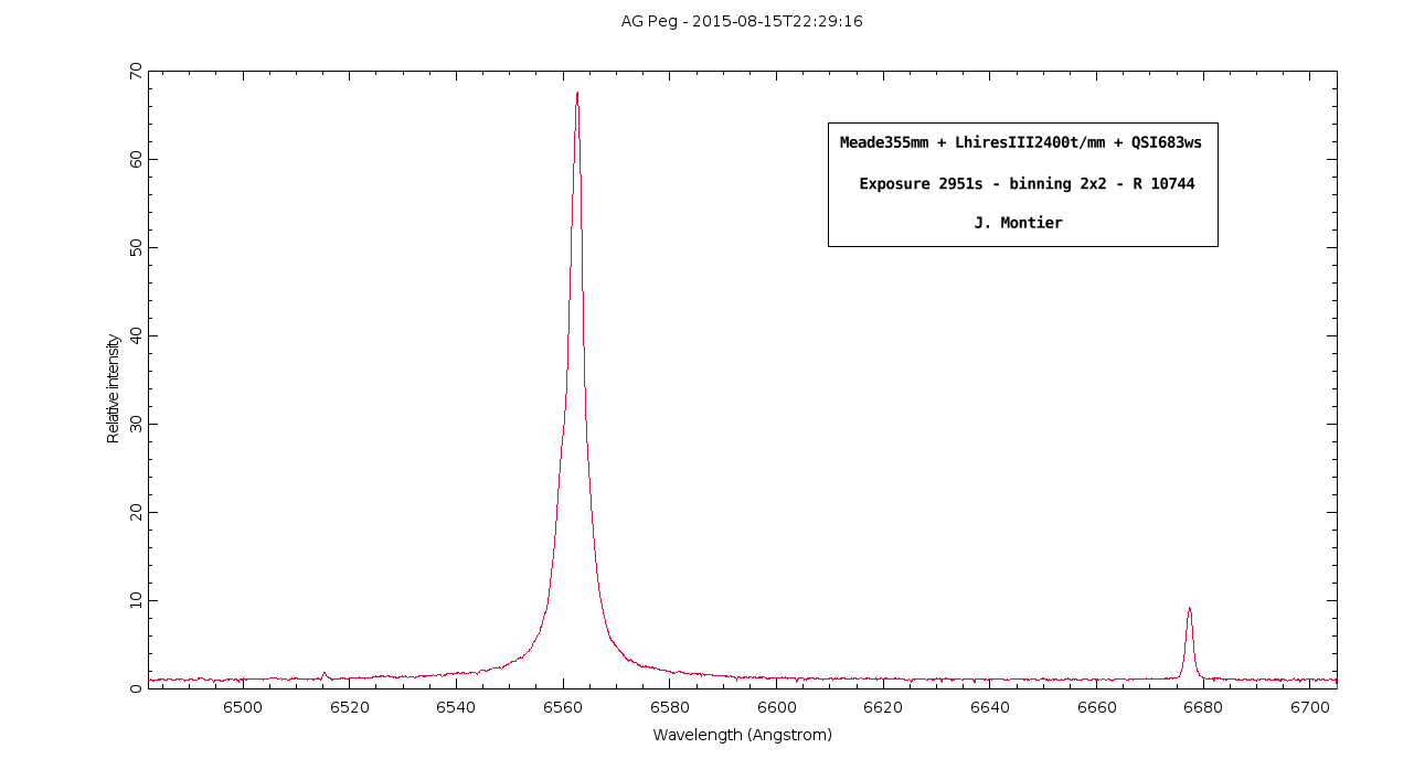

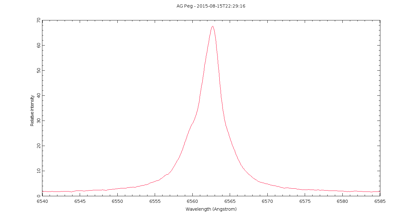

AG Peg spectrum with LhiresIII 2400 t/mm from CALC observatory (Brittany, France)
http://www.astro-rennes.com/la_sar/observatoire.php
Regards,
Regards,

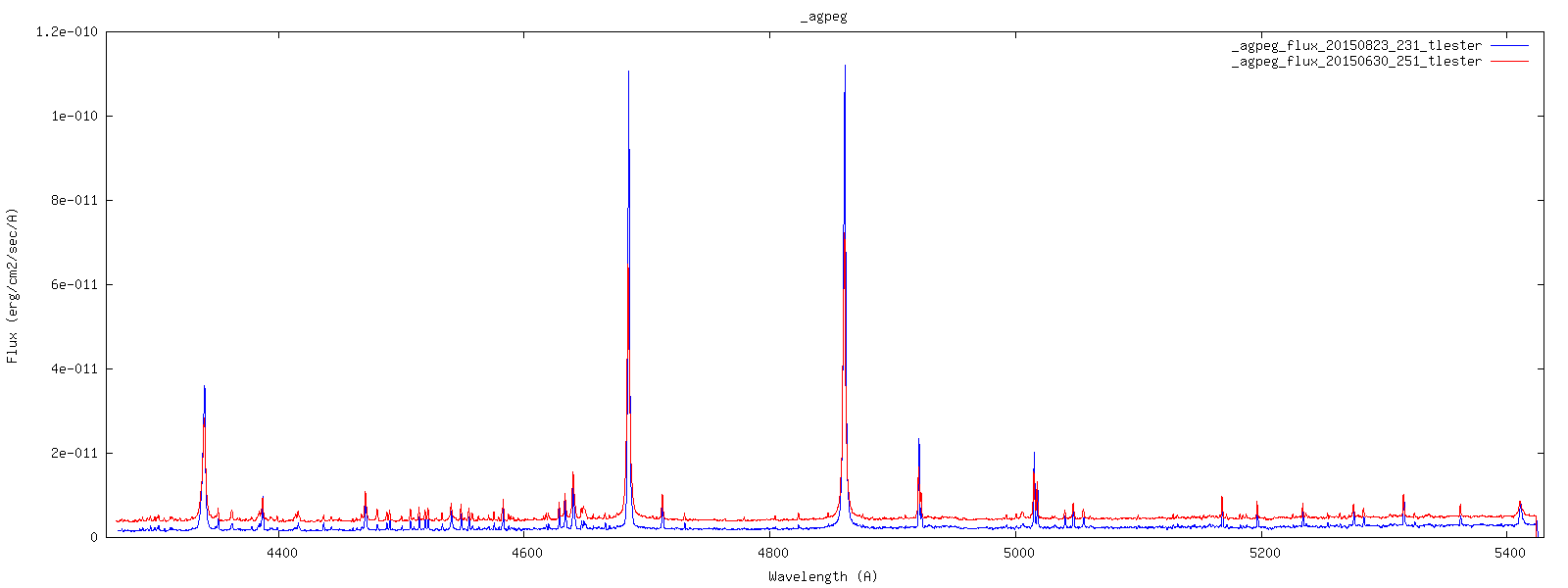

AG Peg for 2015-08-23 from 4270 to 5420 (R=6400) compared to my last result for this range on 2015-06-30, near its maximum.
Flux calibration based on the standard star HD209459 Vmag = 5.75.

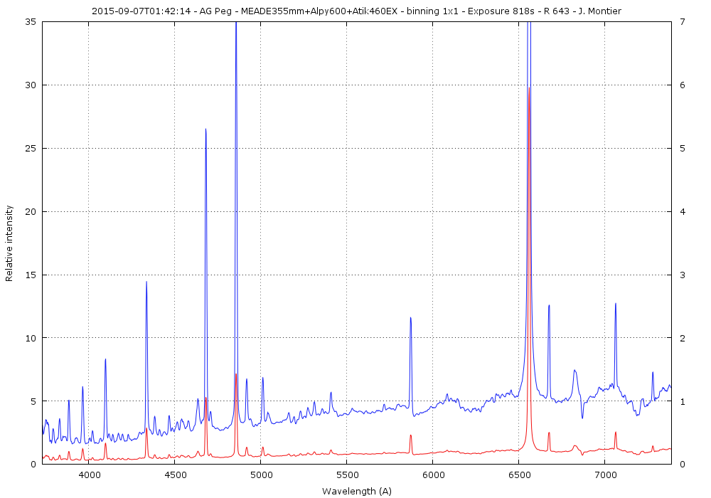

Here is AG Peg spectrum of 2015/09/07 with Alpy600 (0.485 A/pix)

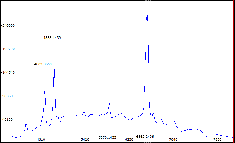

I send another AG Pegasi spectrum taken on September 10 by Celestron C11, mounted on 10 Micron GM2000HPS, plus CCD Atik 314L+ and Star Analyzer 200 l/mm. Dispersion of 7.436 A/pixel.

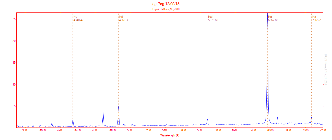

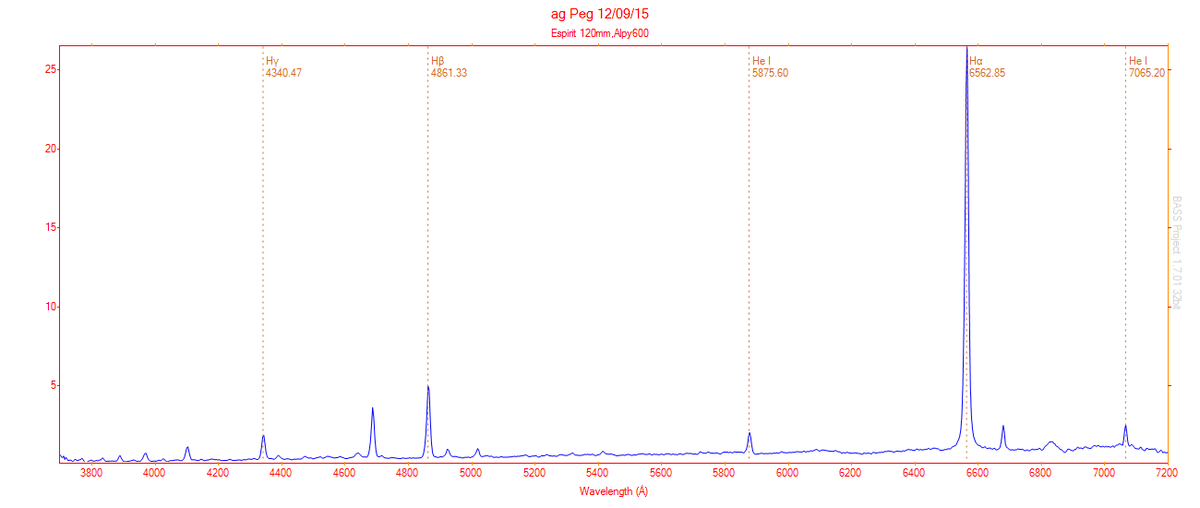

SteveCuthbert
- Posts: 45
- Joined: Fri Aug 09, 2013 6:25 am
Re: AG Peg in outburst
Hi guys
My contribution from 12/09/15
, Alpy 600, Espirit 120mm APO, calibrated/corrected in ISIS.
regards
Steve
regards
Steve
- Posts: 1562
Hi Steve,
Your spectrum looks very good. Nice IR in the blue part.
Your spectrum is welcome in the data base (fit format, send it to francoismathieu.teyssier at bbox.fr)
Best regards,
Best regards,

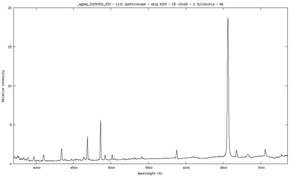

Salut, placez un profil de l'étoile observée dans la nuit du 21/09/2015.
Salutations à tous- Umberto

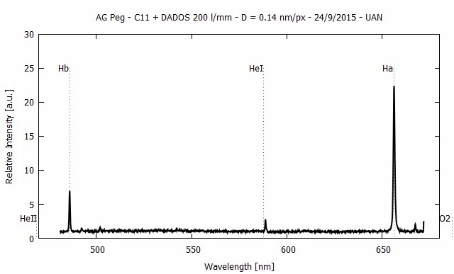

Elio Ricciardiello
- Posts: 12
- Joined: Tue Dec 06, 2011 9:19 pm
- Location: Napoli
after shooting AG Pegasi by SA200, last Thursday we took the spectrum of the variable star by Dados 200 l/mm. The attachment shows the profile in the bandwidth 4800-6600 A, without correcting by istrumental response.
Celestron C11, Atik 314l+, 10Micron Mount, 8 frames x 300 s., dark, bias, flat. Dispersion is 1.4 A/px.
Elio Ricciardiello+Dario Castellano, Antonio Marino, Antonio Porcelli, Salvatore D'Alterio, Dario Saracino
Sezione Spettroscopia
Unione Astrofili Napoletani
Osservatorio Astronomico di Capodimonte
vico Moiariello, 16
Napoli (Italy)
