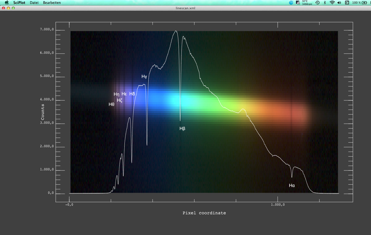

Looking onto my first raw spectra taken for alpha Lyr with the Alpy, Canon DSLR and Astronomik UV/IR Filter, the setup should go down to 3800 A. But intensities to be expected here are not very bright. From earlier experiments the setup could go beyond that and without filter in the UV, but I don't have a suitable filter to avoid second oder spectra overlapping the red.
Please note, that the image of the spectrum is enhanced by gain of a cubic non-linearity to show the lines in the UV, while the uncalibrated spectrum shown is linear.
Think thats ok to start, anyway.
Thilo

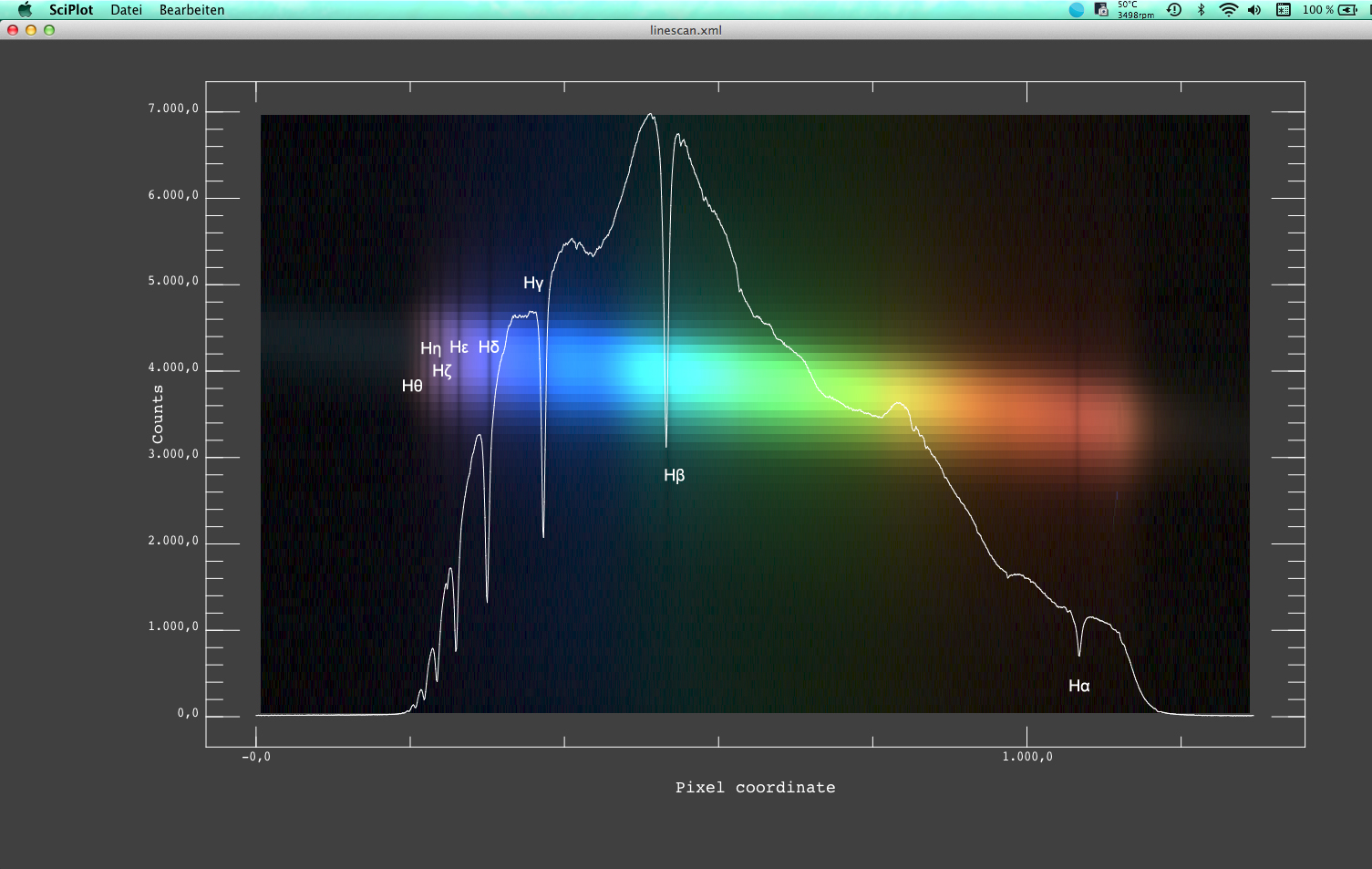

Thilo

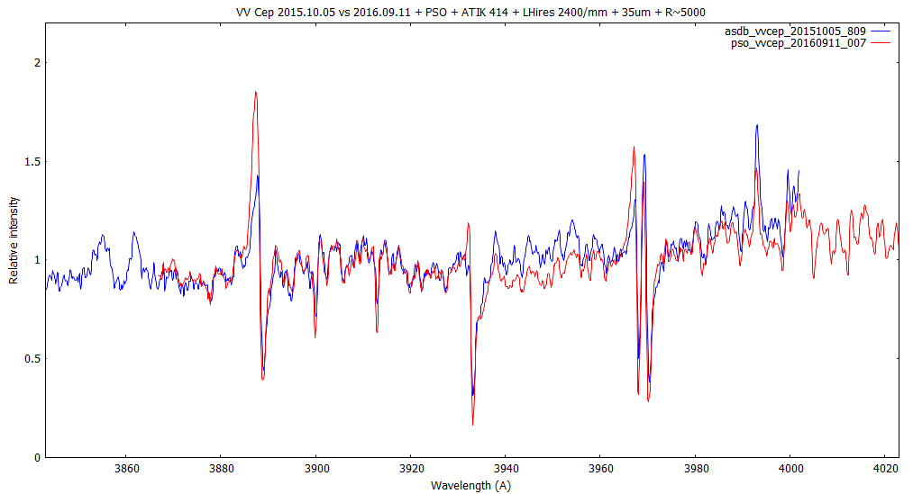

After 1 year, fresh result from this weekend - with the same LHires + 2400/mm grating - the only change is a new 12" Newton (the old was a 10"):
Emissions have changed somwhat, would be interesting to know why.
Used 2x2 binning, pixel intensity at approx. 2200 ADU / 10 minute. (Typical conversion for a 1x1 bin case to divide the ADU value per 4 above bias which is 300 ADU).
The new observation took 4 x 10 minute (with a Mu Cep 2 x 10 minute in between). Sky was not perfect, but was able to shoot close to zenith.
I do not have any ripple on the flat (in fact, flat patterns not even dependent on any wavelength...seeing the same low-order humps at the same place in red and green as well, just the dusts are much more defined). Hope the flat is valid (hence attaching 7 cep in the zip - it looks to be smooth), made the flat 3 x 1 minute average with the internal lamp.
Only the left 20% of the new spectrum gets less focused here by calibration.
Attaching a zip file with results and a Mu Cep, as I read it might be useful for experiments.
