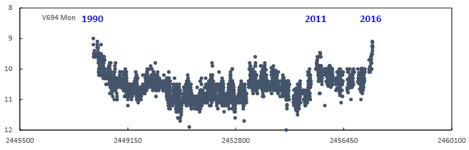

The current ouburst rivals in luminosity the one of 1990
Iijima's classification refers to the velocity of the jet.
In 2011, March, I got profiles of types C/D, with maximal velocity of about 7000 km/s (!)
I see that it was during the decline of the outburst :

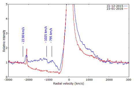

Evolution of H alpha absorption from 2015-12-31 (Peter Somogyi) to 2016-01-21 (Tim Lester)

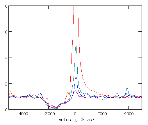

Still on 2016/02/11, swapped activity with Paolo - now I was who went through a few Balmer lines (lower res: R~2000/red - 1000/blue, LHires/600pmm/35um):
red: H-alpha: v694mon_20160211_861
cyan: H-beta: v694mon_20160211_884
blue: H-gamma: v694mon_20160211_921 (focused on)
purple: H-delta: asdb_v694mon_20160211_921 (defocused part)
(all scaled to continuum=1)

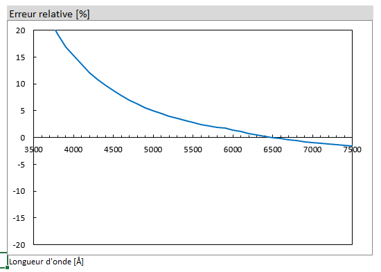

Dear all,
There's some issues with the atmosphéric response.
Not easy due to low altitude of the star, low density of reference stars and great interstellar absortion in the region.
For an altitude of 30° a difference of 5° between the target and the star produces
Here's a model of the error for a target obtained at an altitude = 25° and target at 30° (AOD = 15)
15% of error at lambda = 4000 (for a spectrum normalized at 6500 angströms)
We need to define a common protocole.

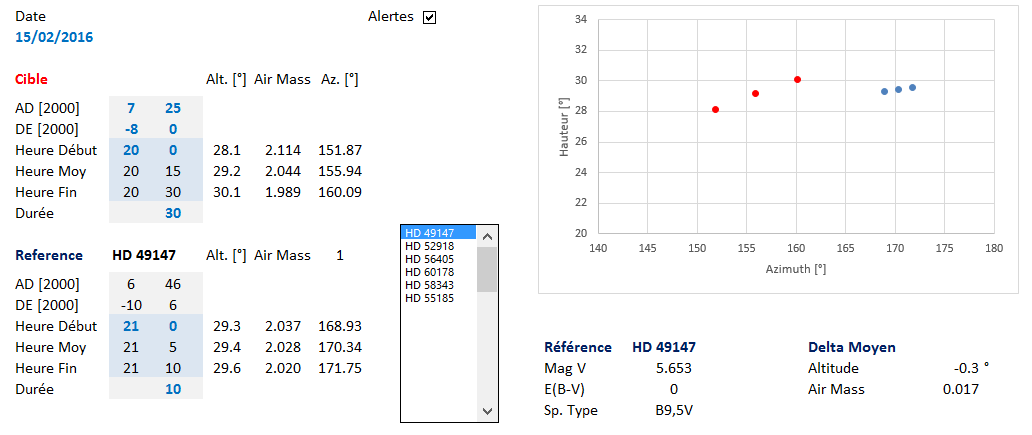

Could you describe 1. the reference star you used 2. the protocole (UT time, duration of acquisition for reference and target).
Here's two proposal, using the faint HD149147 and delta Mon
Delta Mon requires a long time between the two acquisitions
Link to reference star finder : http://www.astronomie-amateur.fr/Docume ... inder.xlsm
To be discussed

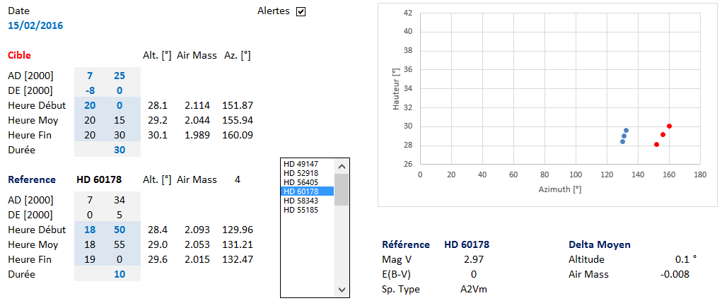

Sorry for HD 60178 ! It is the only error in the table of 1000 stars ...
The issue is fixed. I reload the spreadsheet.
The correction with ISIS is a good method, but it requires the evaluation of the AOD (needs two references at two different altitudes)
Peter : yes, but the header doesn't save the reference star neither its acquisition time (it is a important improvment for the data base, I hope that Chistian will be soon able to buit it)
