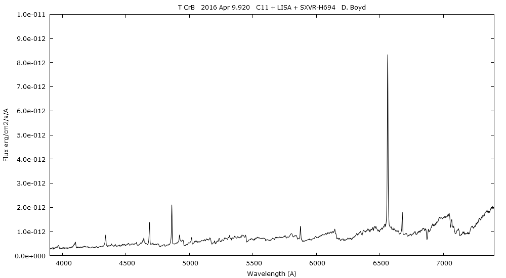

David Boyd
Posts: 164
Re: T CrB High state
Post by David Boyd »
Here is a flux calibrated spectrum of T CrB taken last night, 9th April. The concurrently measured magnitudes of the star were B=10.20 and V=9.34.
The H-alpha emission line flux was 6.6 x 10-11 erg/cm2/s.
Best wishes,

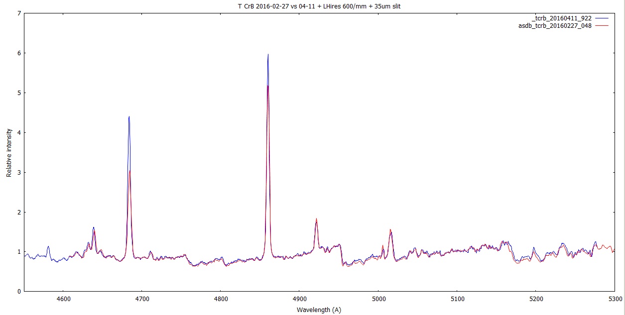

Yesterdays all night serie quick summary (29 x 10 minutes - while asleep):
comparative spectrum
Surprisingly, HeII 4686 did not seem to change much during last night (but will process via finer methods and do analysis later).
For now just picked 1 ref.star from the middle (but taken 4 at different levels, will try to use them).

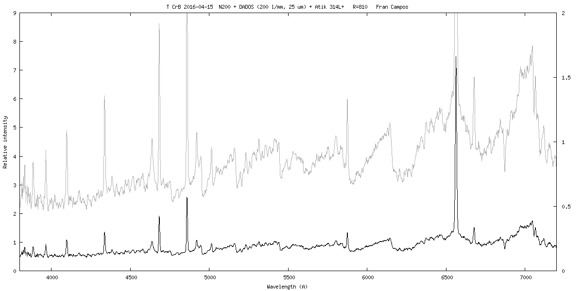

Francisco Campos
Posts: 88
Post by Francisco Campos »
congratulations to everybody for all these excellent spectra. Here is my modest contribution taken two nights ago with the DADOS spectrograph. For the first time the DADOS has reached a resolution of 800, not bad for a grating of 200 l/mm and a slit of 25 um. I wonder how does the DADOS will work with a more powerful grating of 900 or 1200 l/mm...
Greetings
Fran

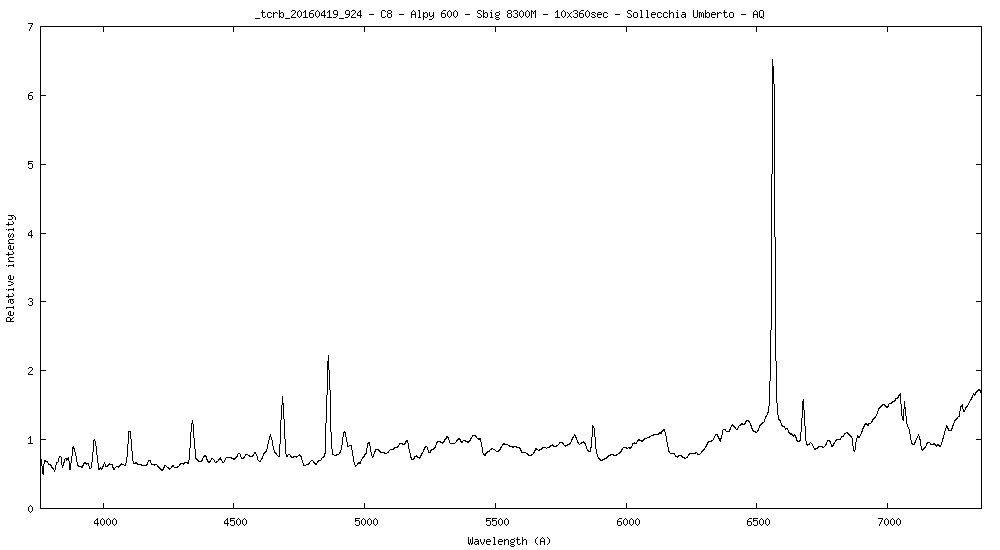

Posts: 248
Post by umberto sollecchia »
Bonjour à tous, placez le profil de l'étoile observée hier soir.
Profilo T Crb.png (6.68 KiB) Viewed 12090 times
Salutations Umberto
Comparaison between two spectra taken last night and 45 days ago

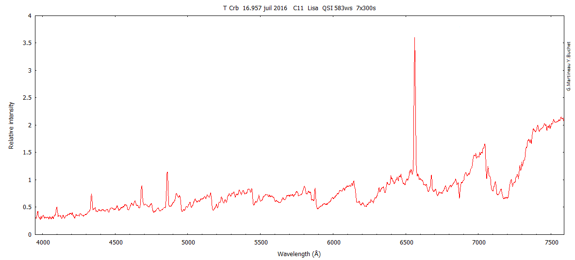

Yolande Buchet
Posts: 13
Joined: Tue Aug 14, 2012 4:34 pm
Post by Yolande Buchet »
_tcrb_20160716_944_martineau buchet.png (13.78 KiB) Viewed 11865 times
Hi,Bonjour,
One observation of TCrb,with C11 and Lisa, taken last week.
Cordially
Yolande,Gerard

Yolande Buchet
Posts: 13
Hi,Bonjour,
Cordially
Yolande,Gerard
T crb EMF.png (18.59 KiB) Viewed 11827 times

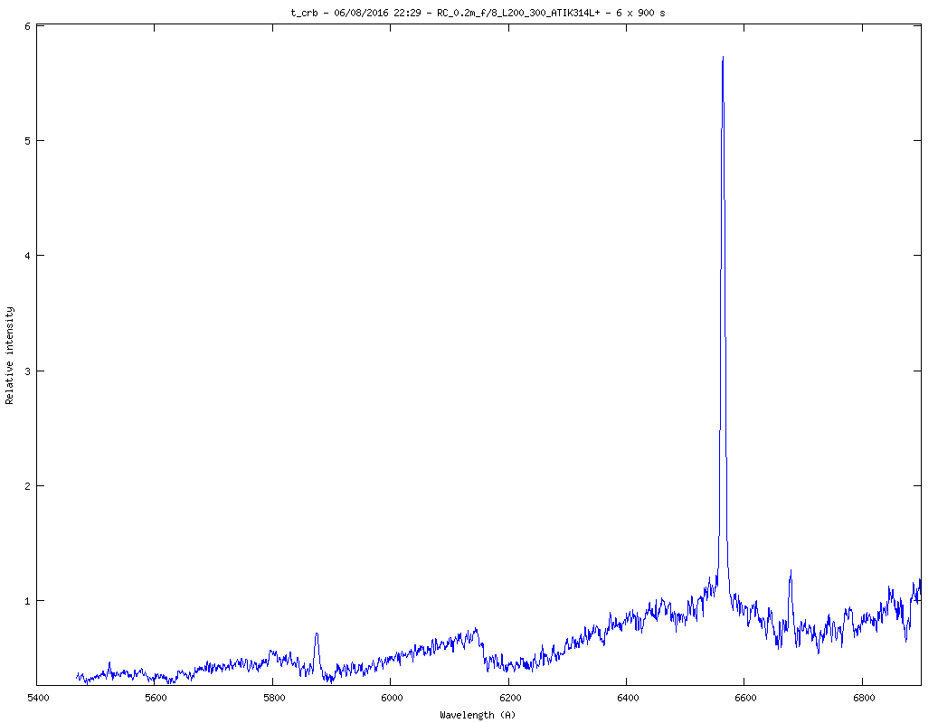

Miguel Rodriguez
Posts: 36
Joined: Sat May 31, 2014 4:52 pm
Location: Madrid, Spain

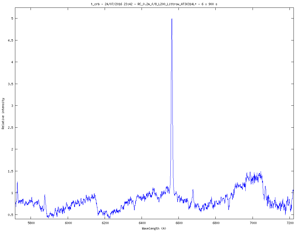

Post by Miguel Rodriguez »
Spectrum from last night. Spectra L200, 300l/mm grating, R=728, 6x900s.
Regards
Miguel
