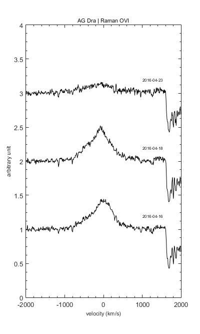

He II remains very intense (about 1.4 x Hb)
Confirmed, Peter :
Raman OVI has vanised
_agdra_20160423_890_full_Raman OVI_dec.png (22.91 KiB) Viewed 10760 times

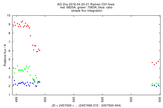

Thanks for the confirm, Francois!

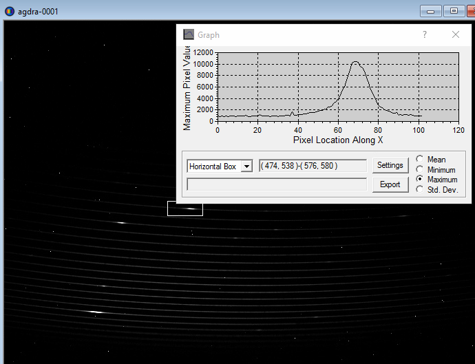

Indeed, the 1st Raman drop to a half has happened within but a few exposures, here is how it looks:
(generated by a trivial flux measure in IRAF (6804:6847, 7066:7100) splot/'e' tool, rectified to a stable 2nd order continuum)
The last 5 exposures had 20 minute, all others 10 minute.

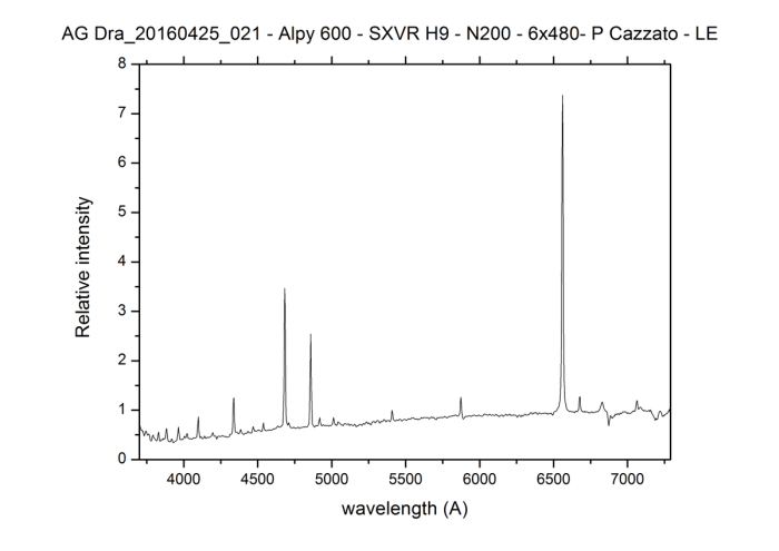

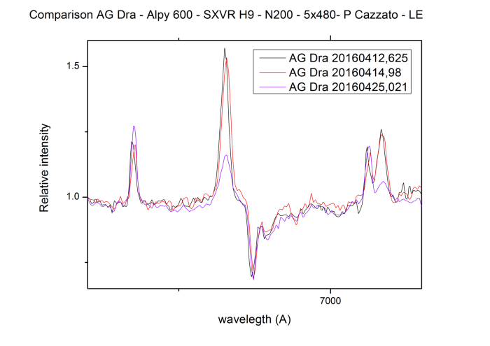

Hallo everybody,
these are my first low resolution spectrum here on aras group. I did theme using an alpy600 coupled with a 200 mm newton telescope. I attached the last spectrum of AG Dra made this night and a comparison made to show some changes in He and O VI spectrum lines
AG Dra 20160425%2C021.png (49.25 KiB) Viewed 10613 times
comparison AG Dra.png (63.2 KiB) Viewed 10613 times
Re: AG Dra brightening
Thank you all.
Maybe the material falling in has suddenly changed or depleted? Remember, it's a small feature, and the drop was only partial.
The gnuplot extract above is via my quickly written script using IRAF (yet too fresh, working on to stabilize), but the change is well seen in spectra uploaded in the database
I must confess taken a calibration right at the drop, have caught only 1 frame clearly in the middle state - but similarly low Raman features can be generated even with the previous calibration, and other features seem to mostly unchanged.
Let's see how it continues.

Hello Paolo,
As I see, the Raman OVI seem to be coming back!
Looks it needs to continue to follow!
