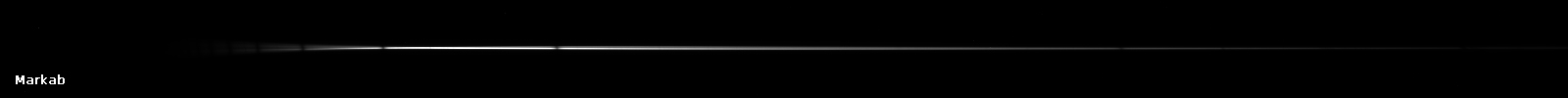

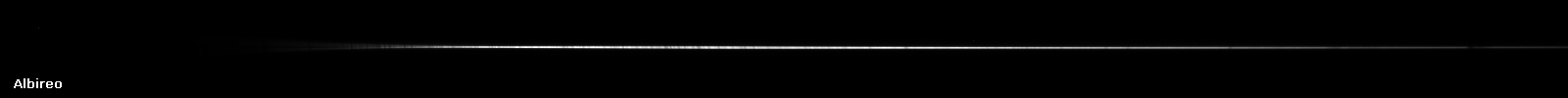

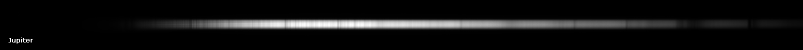

Francois Teyssier wrote:Hi Rainer,
Could you show us some same samples of your spectra.
I remember you've got good (very) results
Hi Francois,
Thanks for the Flowers :oops:

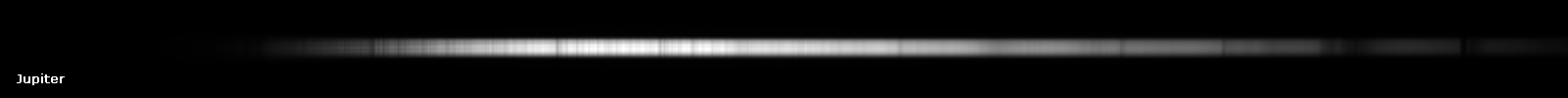

See below some recent spectrum images I have done and where I focused on approximately the 5000A to 6000A wavelength area. I am exposing now with a QSI520i with a Kodak KAI-2020M CCD chip to a maximum of about 32.000 ADU. The chip full well depth is 45.000 electrons. I do this because of V-Spec. I have done test going up to 60.000ADU (16bit depth) but V-Spec can not (¿ still or has it been changed ? :? ) process those images correctly as the spectrum is always overexposed and in other software it is OK.

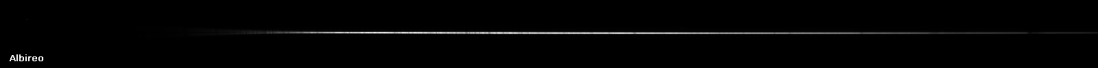

Because of the appearance of mist on my telescope, I had to re-focus.
It appears a slight difference in the appearance of the blue edge
Note the second one is almost perfect.

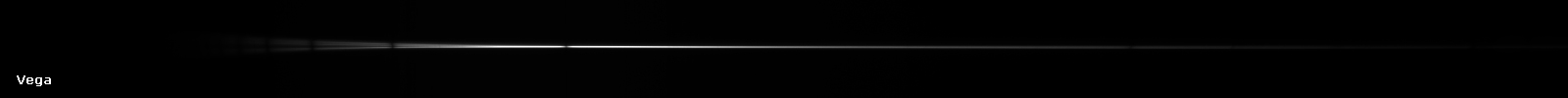

Re: Beginning with a Lisa
Hi Rainer,
There is a significant difference between Markab et Vega.
Did you take the two spectra that night, with the same settings?
The continuum trace is very fine. Can you remind us what telescope you are using?
About the focale : the major interest of Lisa is to get get faint (very faint objects). If you use a reducer, you increase the signal (about factor 2 between F/D = 10 and F/D = 6, i.e. 1 mag).

Hi Francois,
No, Vega is from a few weeks earlier but Jupiter, Albireo and Markab are from 2 weeks ago, same weekend, with the new focusing workflow ...
OK, about the f/10 and f/6 difference, so it is 1 : 1.6 and then f/8 to f/5 is the same :mrgreen: which is my setup.
