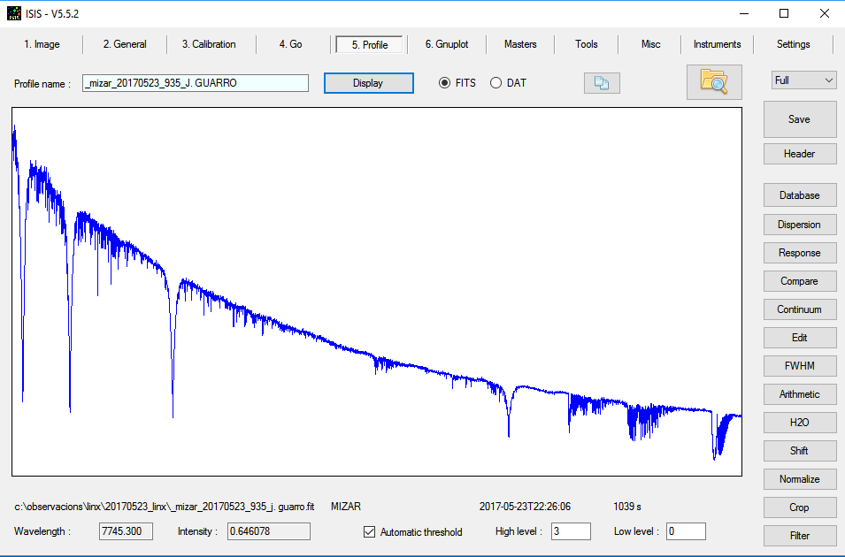

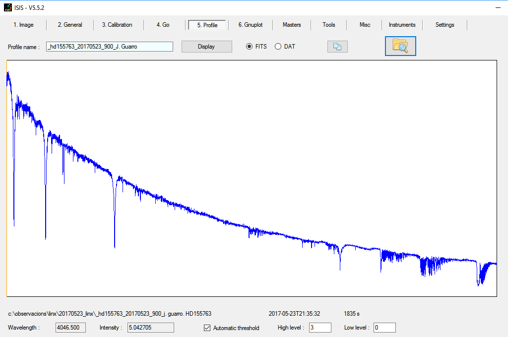

These two graphs are from last night are the first light.
The wavelength calibration is good but there are still things to tune.
Going to change the collimator 100 F to F125 mm. to try to overcome the current R = 8000 and I reviewed the focus of the collimator and the CCD. See Martin Dubs,
https://meteorspectroscopy.files.wordpr ... matism.pdf
That will be next week.
For now, orders are 26 (the size of the chip ATIK460EX not support them any more), and the dynamic range was from 4064 to 7744 angstroms.
Friendly, Joan.
Friendly, Joan.

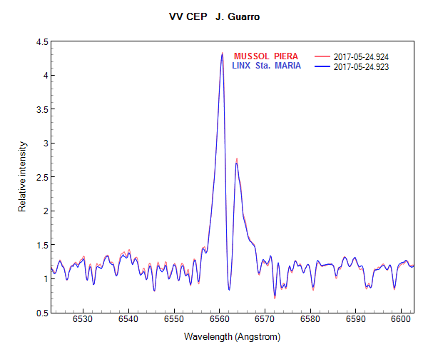

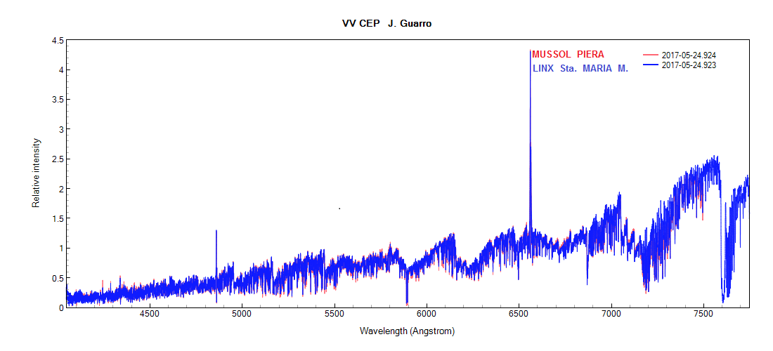

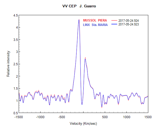

Another example are the following graphs represent the simultaneous observation of the star VVCep. One is a graph by Mussol, from Piera and the second with the Linx made from Sta. Maria (about 70 Km.). When observing the temperature deference between the two towns was a 3ºC. In addition, the two spectrographs had to endure daytime temperatures of around 28º.
During an observation session, for every star, take your flat tungsten and its calibration RELCO SC480. The most surprising is that the flat swapping and calibration, the number one star of the star number four (for example), the result is very good, very stable (better not change them). So far, the temperature is not a worrying fact for me. To mention a person, François Teyssier, lets not even one.
I know three commercial brands Échelles, two of them are direct injection to telescope, I have not seen that their use made no reference manual temperature control, (one of them with R = 20 000).
What is essential is the rigidity and strength of the mechanical assembly weak, is a bad montage.
I did not invent this is an application of my experiences.
Friendly, Joan.

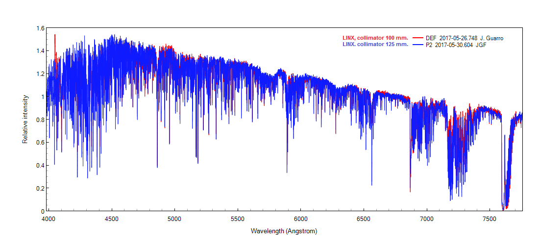

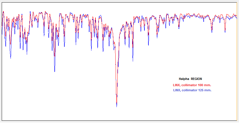

Today I changed the collimator LINX. I retired achromatic lens of D 30mm. F 100mm. (Edmund Optics), and in its place I have placed an objective, of one finder, (Chinese) of D31.7mm. 125mm focal length.
Preliminary results (with daylight) are good, the Linx has passed a resolution, R = 9000 and have increased the number of orders. Now are of 29 to 55. Range = 3979.5 to 7760 Angstroms.
Now try to be a star ...
J.G.

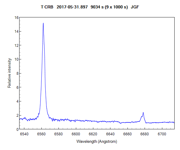

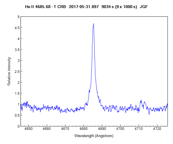

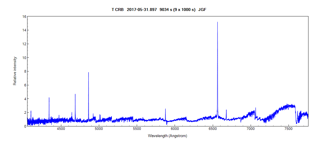

A test in the sky, the star T CrB with the LINX and R=9000.
Cheers, JG.
Cheers, JG.

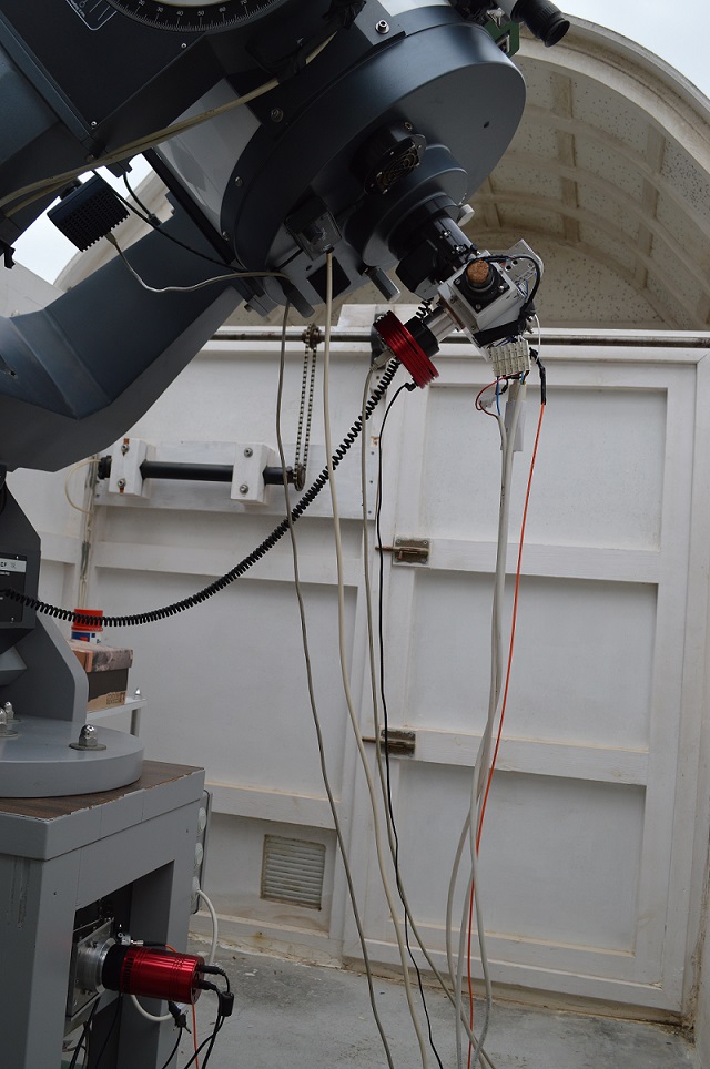

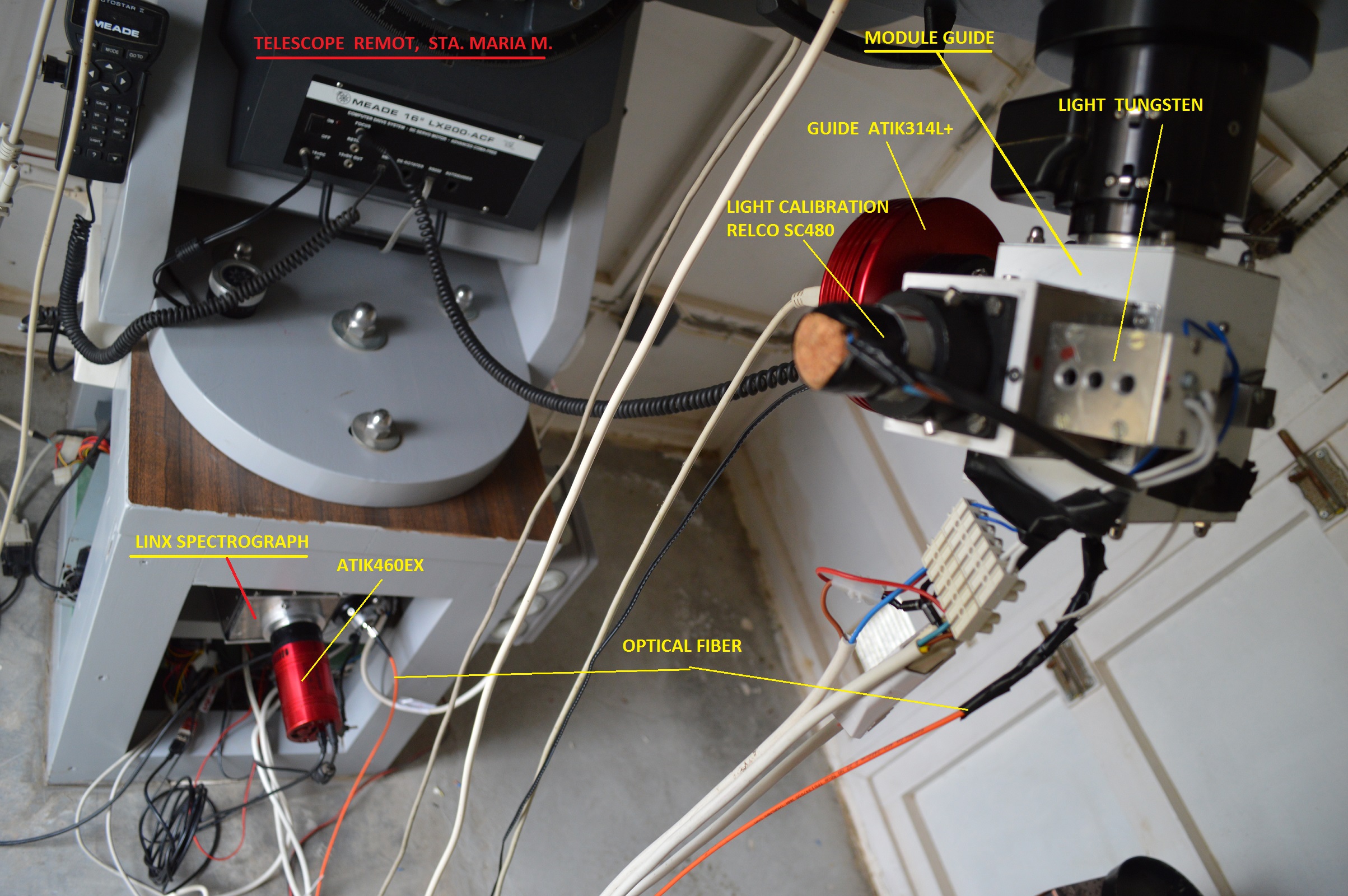

- Posts: 731
Re: Nouveau Echelle Linx
Bonjour Etienne,
These are both fotos of the LINX in the REMOT to Sta. Maria M.
Bien cordialement, Joan.

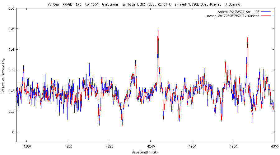

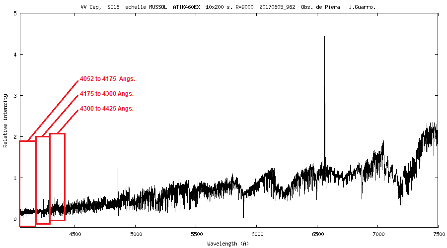

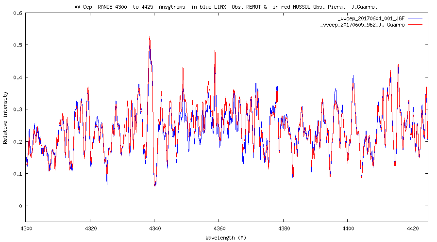

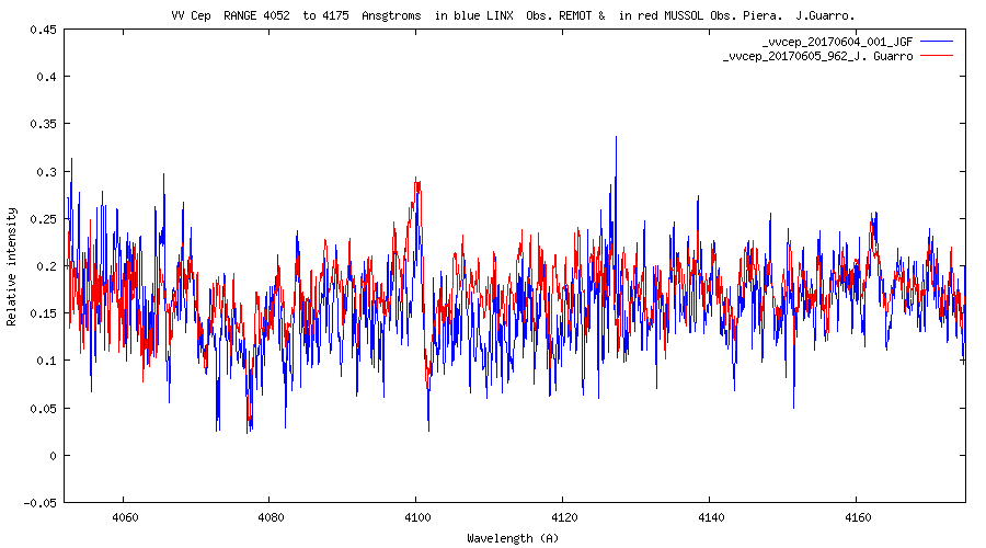

I present the comparison of two graphs, the star VV Cep. One is with the Linx from Sta. Maria and second with the Mussol from Piera.
The reason is a test to check the stability and confidence of both Échelles.
You know that VVCep is an M2, with little emission in the blue.
In the graph, from 4052 to 4175 Angs., The background noise is confused with the image (to improve the result and need more exposure time), the result is bad.
In the graph, from 4175 to 4300 Angso., The coincidences begin to be evident from the 4200 Angs.
In the graph, from 4300 to 4425 Angso. I think that I can improve.
Regards, J.Guarro.
