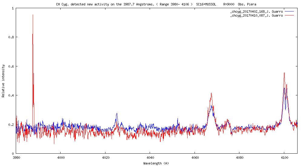

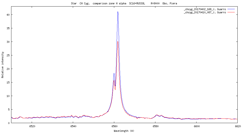

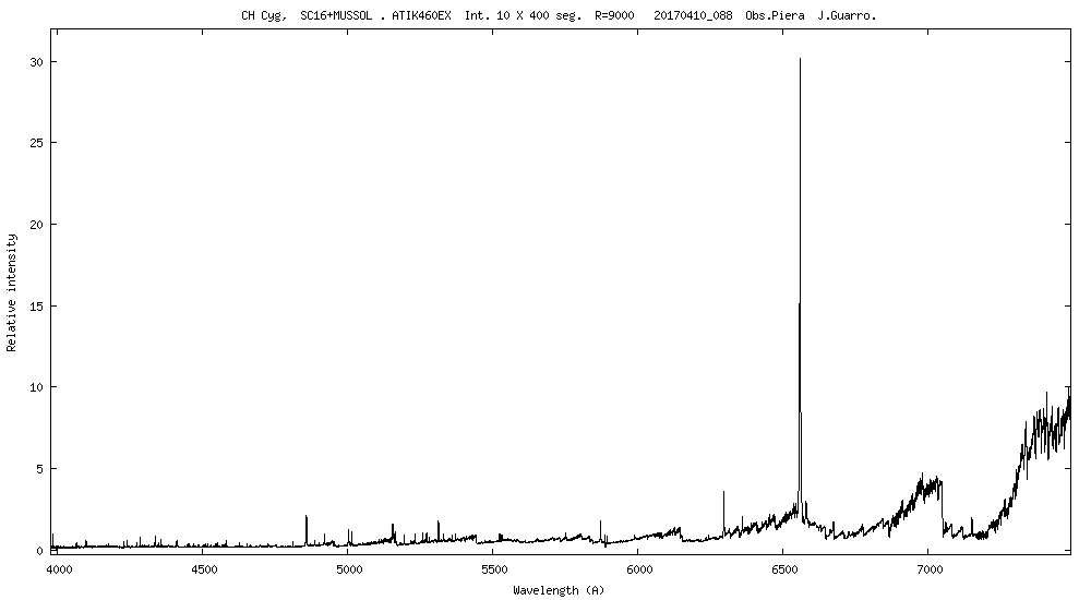

Is the CH Cyg on the last njght.
Cheers, Joan.
Cheers, Joan.
- _chcyg_20170410_087_J. GUARRO.png (6.61 KiB) Viewed 12068 times
- _chcyg com1.png (6.21 KiB) Viewed 12068 times
- _chcyg com2.png (10.99 KiB) Viewed 12068 times

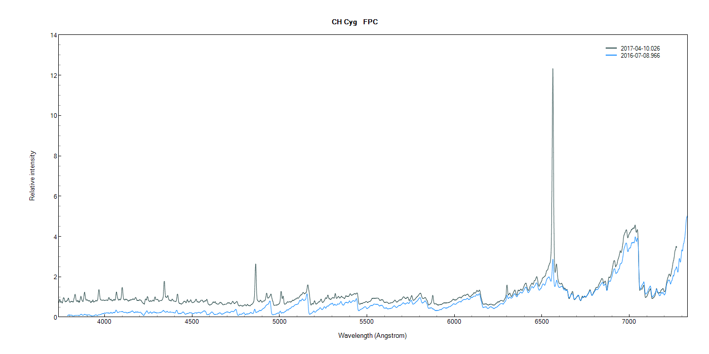

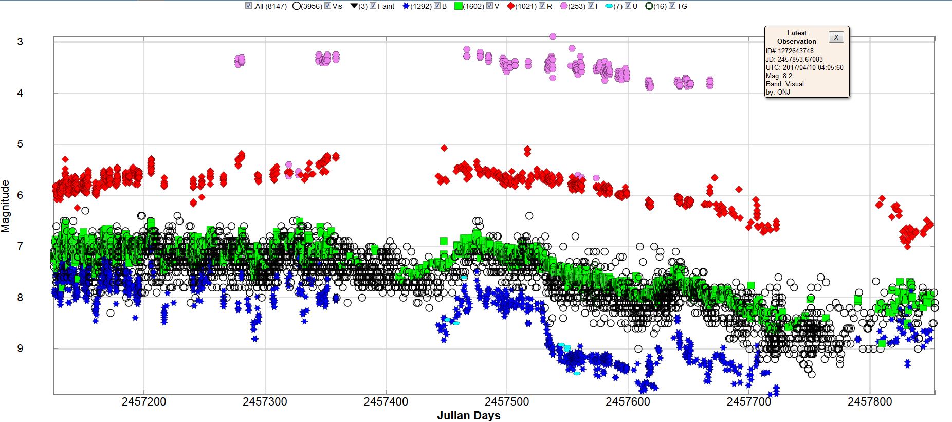

Here is a comparison of two low resolution spectra of CH Cyg. The first one, taken in July 2016; and the last one, only two nights ago. The difference is amazing...
Both spectra taken with the DADOS (R=800) and the newton 8".
Also, I upload the photometric curve taken from the AAVSO database. I expected that CH Cyg would be brighter, but not. The only important difference I see is that the star seems brighter in the Johnson-B band, but in Johnson-V band the star has weakened. Maybe the red component has faded and, on the other hand, the hot component and the surrounding nebula are more excited?
Greetings
Fran
Greetings
Fran

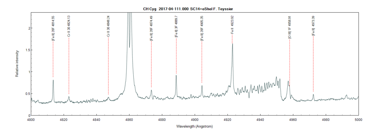

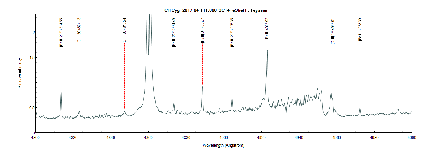

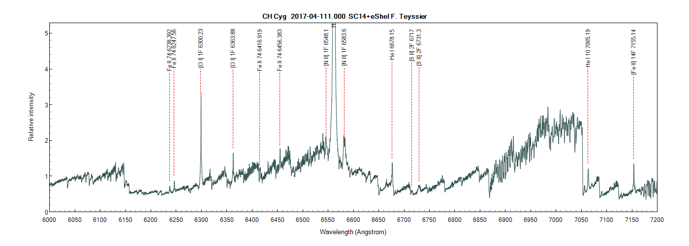

A full (almost!) commented spectrum of CH Cygni, with more than 100 identified lines (from various published values)
with PlotSpectra (Tim Lester)
Examples: Range 4800-5000 and 6000-7200
Note [SII] doublet
Other Ranges: http://www.astronomie-amateur.fr/feuill ... html#Lines
Note [SII] doublet

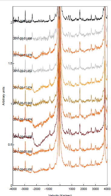

From observations in August, both at low (Woody Sims and James Foster) and high resolution (Joan Guarro, Tim Lester, François Teyssier), strong absorptions in H beta and lower Balmer lines appear clearly with max velocities from -2000 to -3000 km/s (and perhaps more)
H beta profile from echelle spectra François
