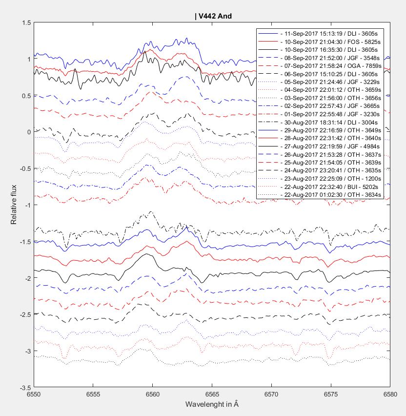

My call for observation of V442 Andromedae was well received and thanks to several of you, at least one spectrum has been taken every night and most of the time several per night!

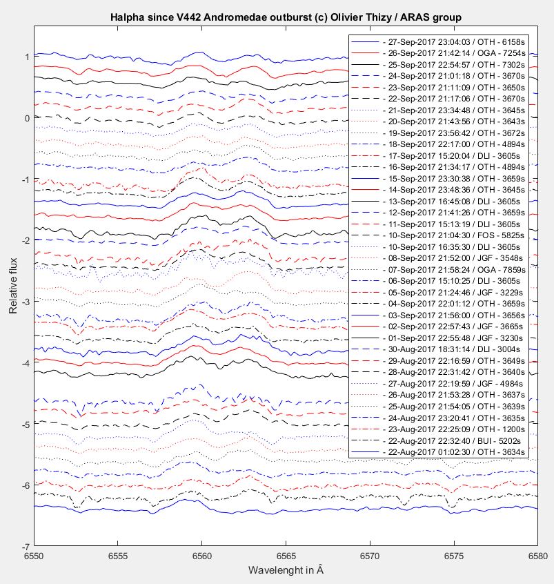

So here is as of september 4th the daily Halpha evolution since the outburst discovery on the night of august 21st:
The changes seem less pronounced for the past three nights but additional observations are required to confirm or not (again, my weather forecast are not great for next few nights). Note that no period has been searched/calculated yet as my focus is on data acquisition so far.
Last but not least spectra should of course be uploaded on BeSS database for further/detailed study.
Let's continue to observe this outburst with as much frequent spectra as possible,

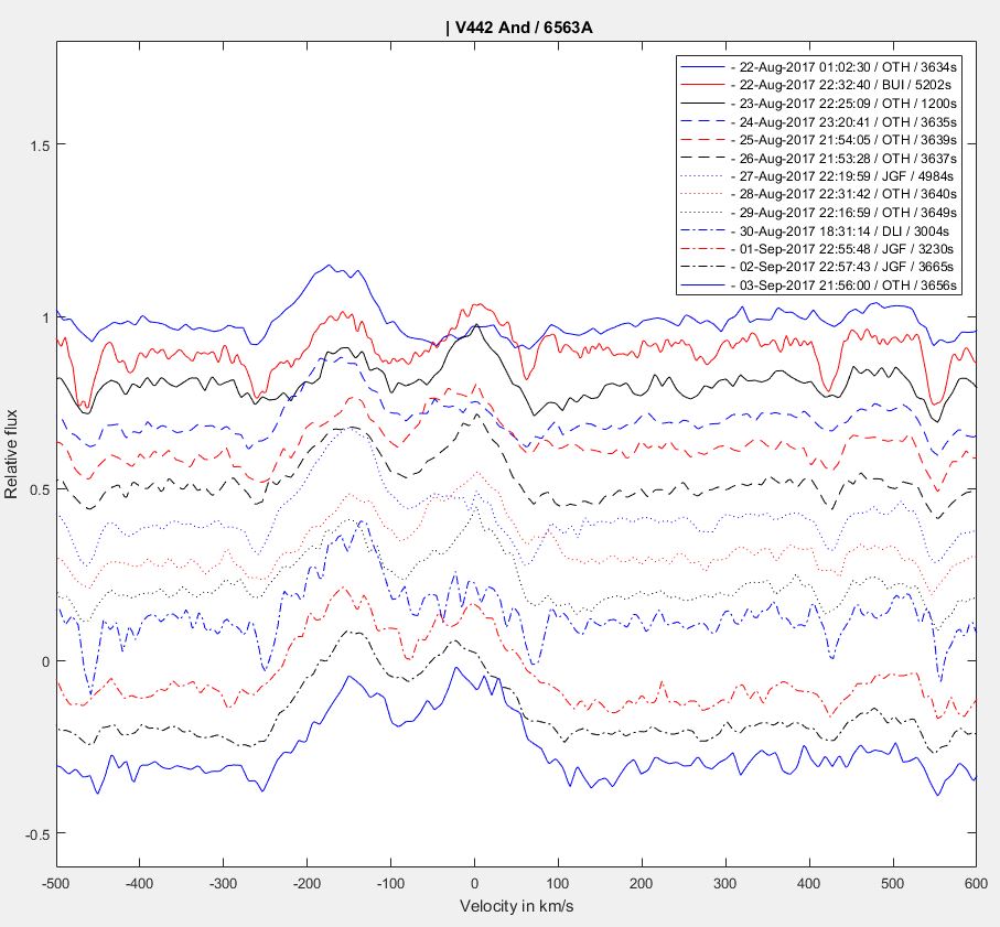

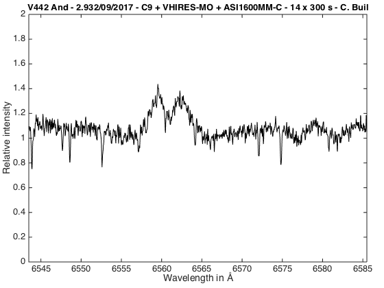

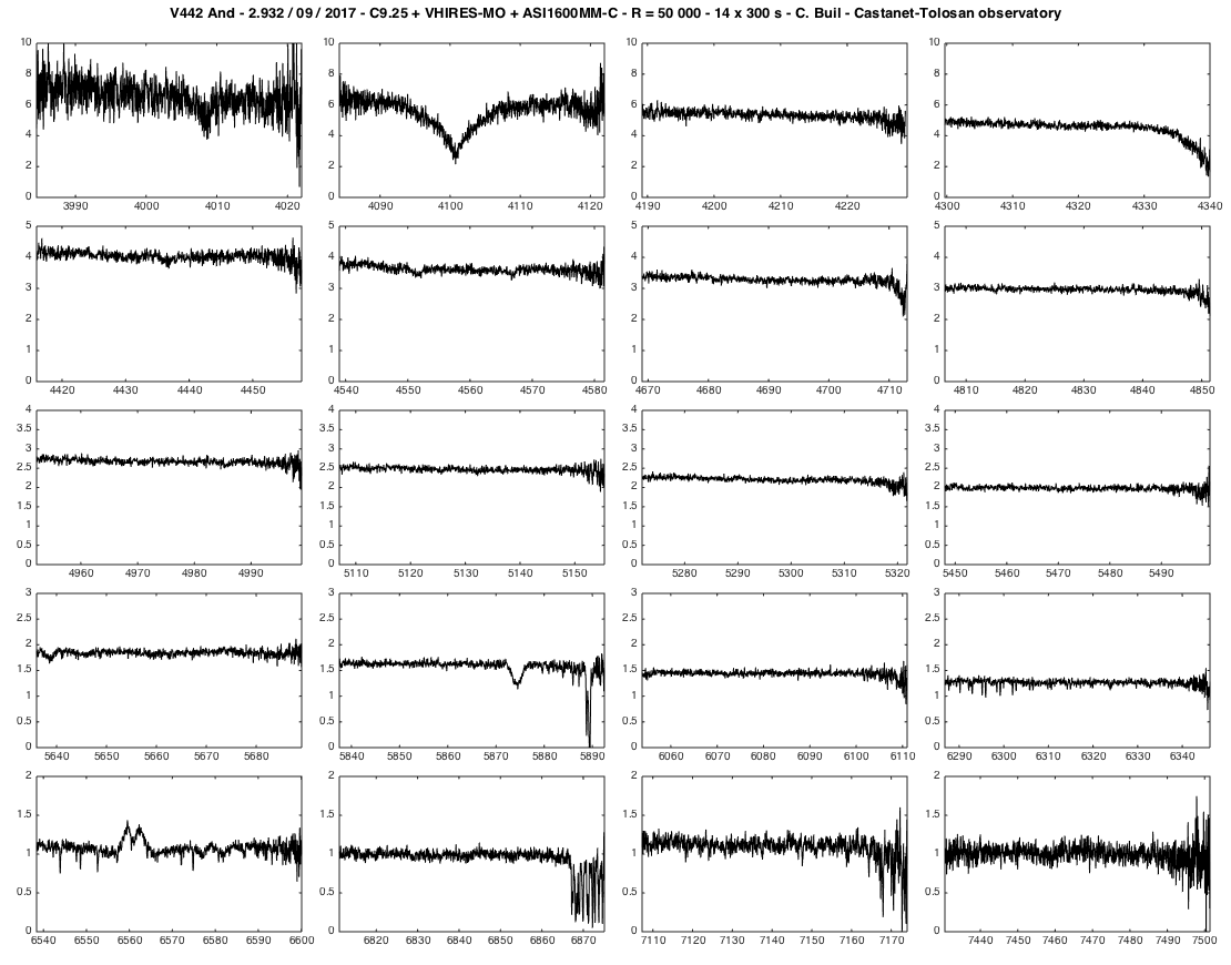

A VHIRES-MO spectrum of V442 And taken the 2.9/09/2017 at R=50 000 with a C9.25 telescope, and for the first for me,
by using a CMOS camera (ASI1600MM-C) on an echelle spectrograph. Detail of Halpha line and the full spectrum taken with VHIRES-MO.

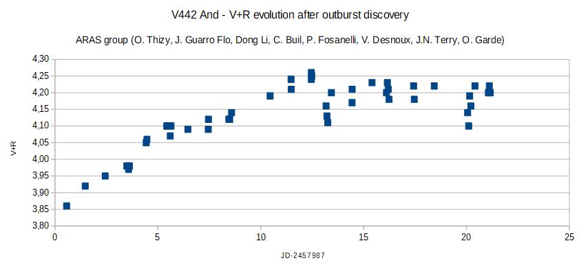

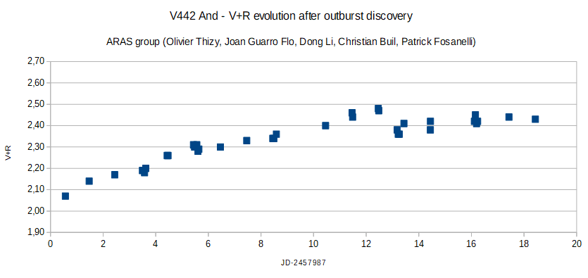

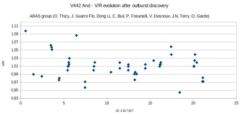

V442 And was in a more stable state for the past few days but - thanks to Joan Guarro Flo latest observations - there seems to be again some activity going on. Here are the daily graphs (one selected graph per night). The two graphs at the top are the one from Joan Guarro showing the double peak evolution again:

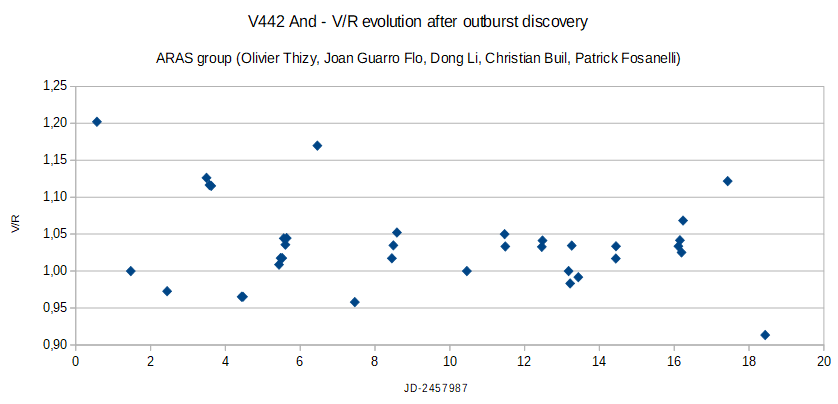

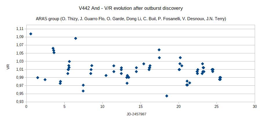

Based on Coralie Neiner suggestion, I measured V/R and V+R for all the spectra I have a copy of. I used MatLab with gaussian fit on two spectral domains; I did not model/remove the absorption so I guess this is a first "draft".
The V/R is showing an evolution (periodic? same period as the star around 2.6 days?) for approximately 10 days after the outburst discovery, then a more stable ratio, and now is back to variability again. It looks like the ejected material initially had the star momentum (and rotational period) then as it moved away it moved into a more Keplerian rotational behaviour (and different period); and more recently another ejection of material?
At the same time, V+R is showing a smooth increase then a stabilization for the past few days. This tends to indicte that the V/R variation above are mainly due to material around the star NOT homogeneous:
Bottom line is that this is a very interesting Be star outburst and I encourage you to continue observing it. As usual, upload your spectra on BeSS but please send me a copy so I can update the data/graphs accordingly.

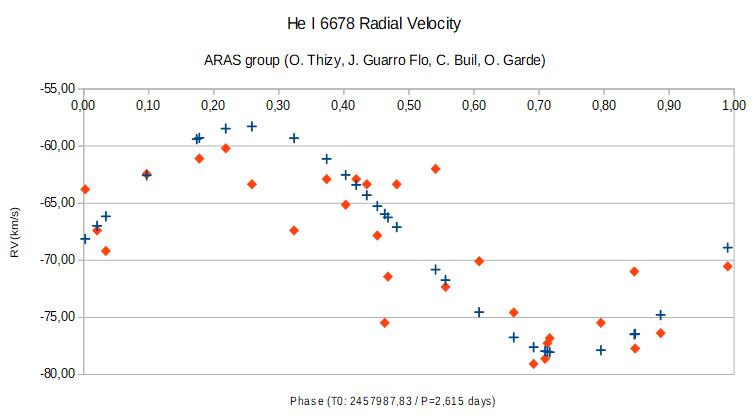

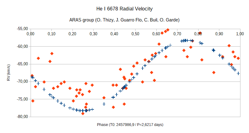

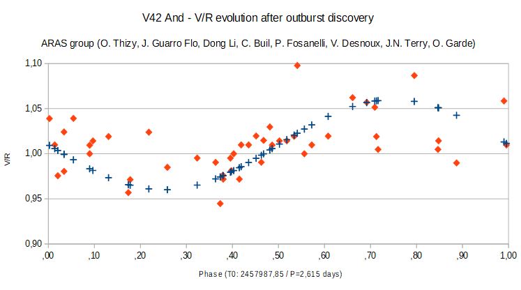

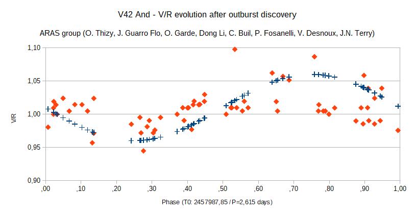

Thanks to Dong Li & Patrick Fosanelli recent observations, there is confirmation of the activity of V442 And after a short "quiet" period with Halpha emission showing variability, V/R variable again while V+R seems to remain more stable:
I folded V/R over the 2.615 days period; here is the result:
Last but not least, I measured He I 6678 center and plotted it against the 2.615 days period:
Olivier

evolution of V442 And in 5 days

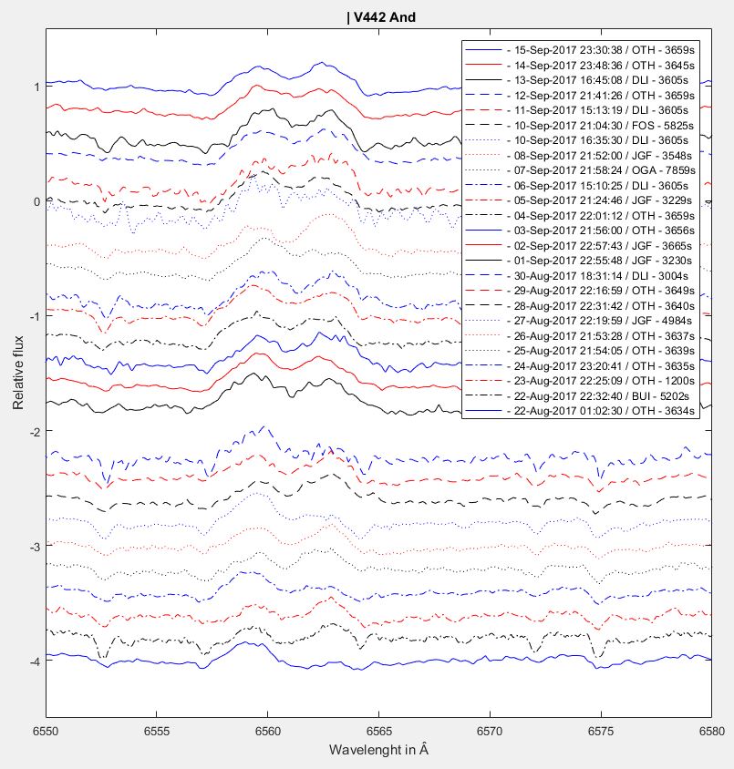

Here is a quick status on V442 Andromedae Be star outburst since august 21st. The V+R graph is now showing a clear decrease:
The V/R graph is showing some variability but slower than the 2.6 days periodic variations that were clearly visible at the beginning of this emission phase:
Here are the data folded over the 2.6 days (star rotation) period:
Here is the updated daily specra graph:

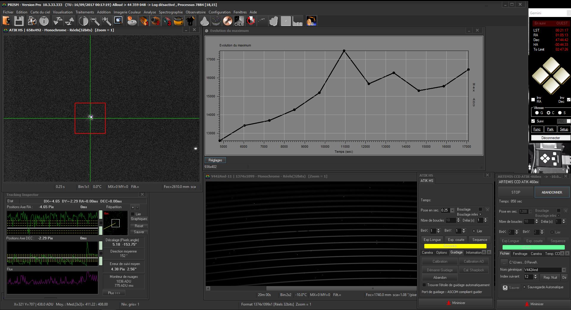

And for the fun, I have been working on remote observation. I observed last night from home... with fireplace heat and Star Trek Voyager serie on TV!
Hre is a capture of last night observing session where the spectrum signal has been increasing as the target as rising up in the sly (and I suspect the sky transparency was getting better too):

Here is the V/R graph showing variations. Note also a very good time coverage during last two days with Dong Li & I.

And here is the updated daily graph evolution:

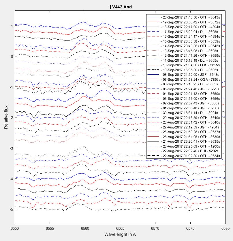

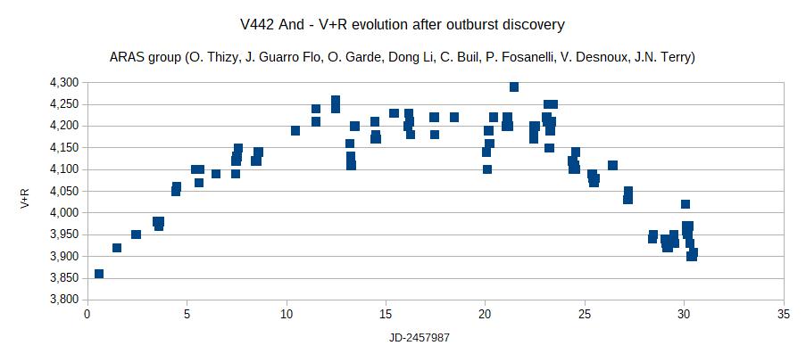

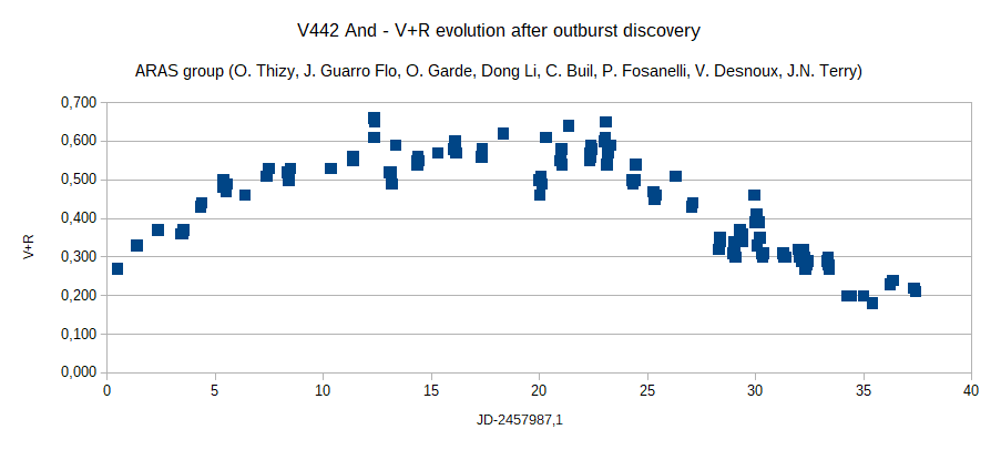

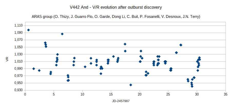

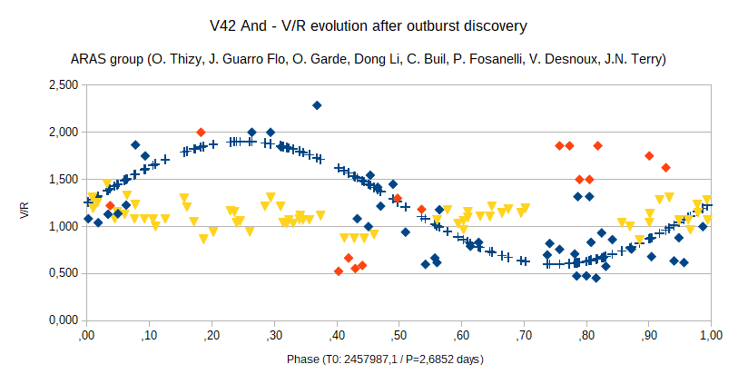

128 spectra of V442 And (hd6226) have been collected since the outburst discovery on the night of augst 21st [still waiting for more observers to join in...
], for a total exposure time of 135 hours:

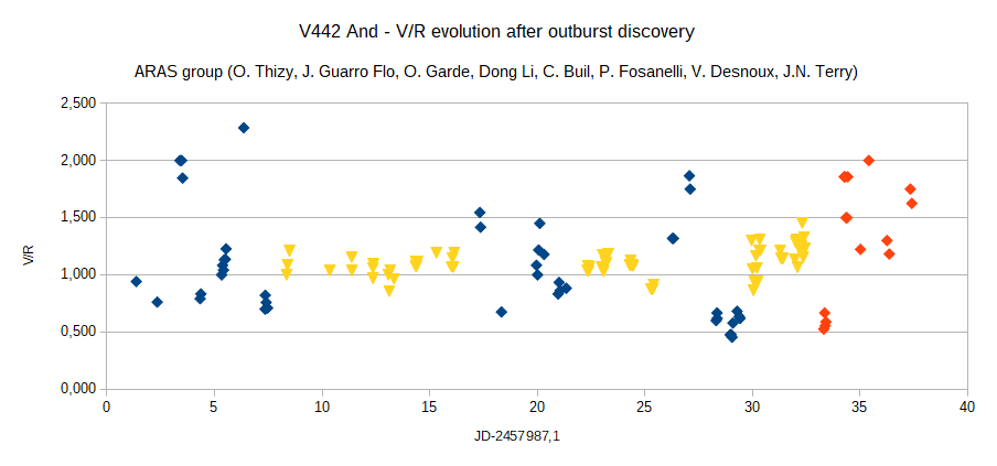

I have a mea culpa to make - I did a mistake in the V & R calculation. Basically, I wanted to remove 0.9 on each measurements in order to compensate for the absorption line (until I find a way to model it); well I added the 0.9 instead. Here are the corrected data. They show very similar information, but more accurately!
The emission increased but is now in the decline as the V+R graph shows:
The V/R is still showing variability. I grouped in blue the variable phases, in green the more stable ones:
A period analysis shows a period of 2.6852 days:
This is very close to the period found on HeI 6678 stellar photospheric line, ie the star rotation itself:
The Halpha daily graph shows the evolution over time:
