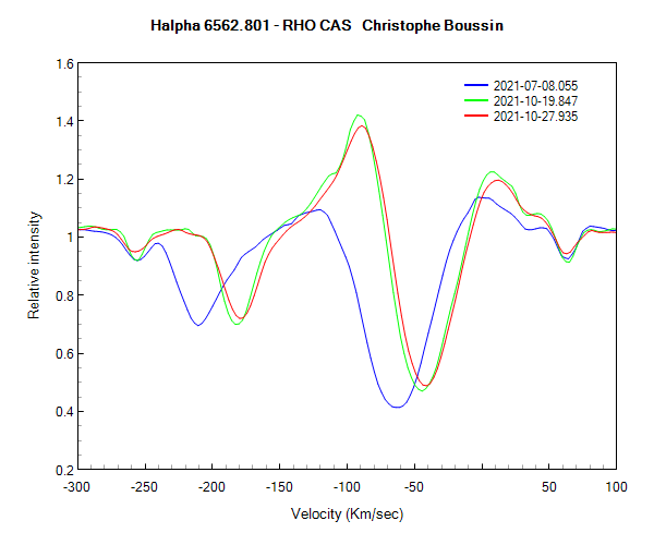

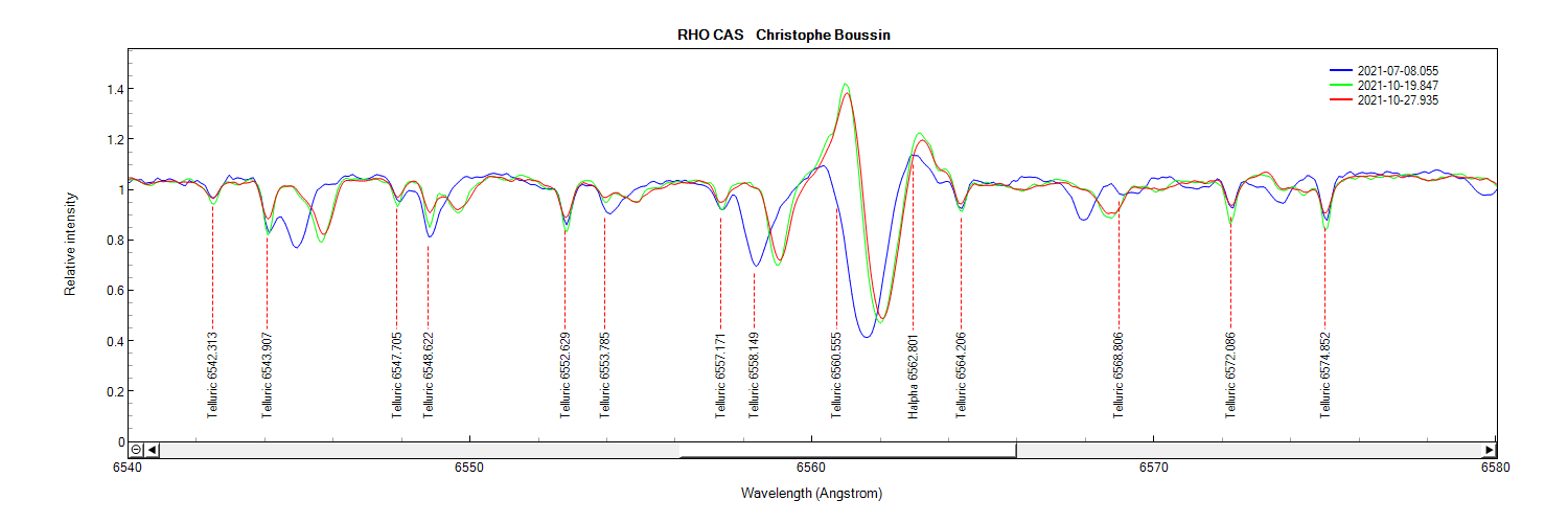

Here is my contribution to this very interesting monitoring of the Rho Cas activity.
I obtained previously a high resolution spectrum around the Halpha line of Rho Cas on July 8 at 1 h 20 TU (resolution of 17942, JJ = 2459403.5552, 6 x 600s) and recently two new spectra on October 19 at 20 h 19 TU (resolution of 19325, JJ = 2459507.3467, 7 x 600s), and on October 27 at 18 h 35 TU (resolution of 18778, JJ = 2459515.435, 6 x 600s) with my LHIRES III (grating of 2400 lines / mm).
Here is the comparison between these three spectra (the positions of the telluric lines are indicated using the PlotSpectra software) :
Spectral domain around the Halpha line of Rho Cas on July 8th and October 19th and 27th 2021
As reported by Ernst Pollmann in the previous post, the profile of Rho Cas Halpha line has clearly evolved in recent months. This evolution is well visible between my spectra of July 8 and October 19 but I don't notice any significant change between those of October 19 and 27.

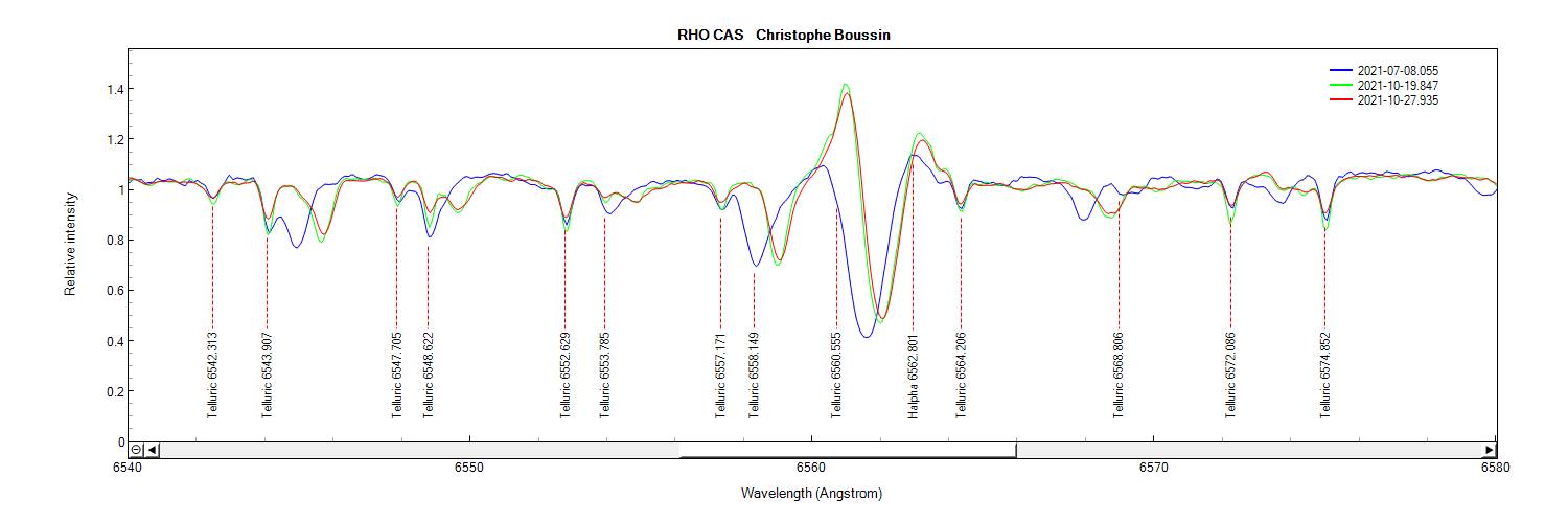

Here is a more detailed view around the Halpha line of Rho Cas :
Spectral domain around the Halpha line of Rho Cas on July 8th and October 19th and 27th 2021 (zoom)
rhocas_20210708_20211027_Halpha_zoom_Christophe Boussin.png (23.82 KiB) Viewed 28327 times
Please note that the spectra are not corrected for heliocentric radial velocity (according to the ISIS software, the values are as follows : 17.880 km/s on July 8 ; 1.408 km/s on October 19 (the movement of the Earth brings us closer to Rho Cas for these 2 dates) and -1.192 km/s on October 27 (the movement of the Earth takes us away from Rho Cas for this last date).
Zero velocity is on Halpha 6562.801 A at rest, and, according to Klochkova et al. (2014), https://arxiv.org/pdf/1312.6922v1.pdf, the systemic velocity is −47 km/s (which means here that Rho Cas and the Sun are moving towards each other) and due to low amplitude pulsations of the atmospheric layers near the photosphere, the radial velocity varies with an amplitude of about 7 km/s around this value.

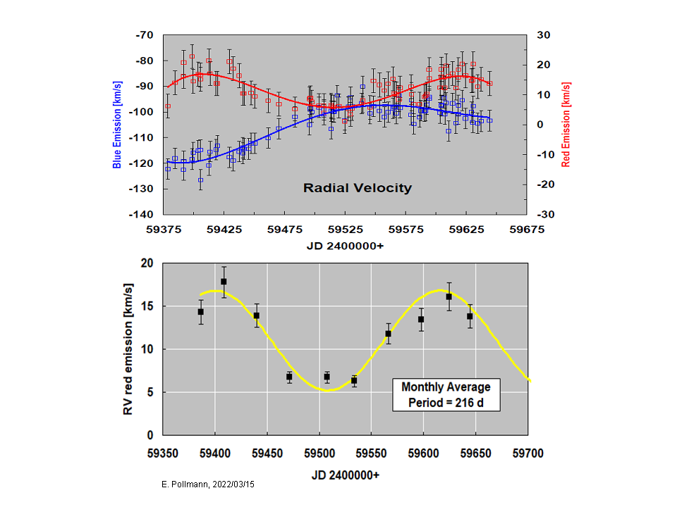

Dear colleagues,
our rho Cas monitoring, particularly the behavior of the red emission component seems to reveal as monthly average time behavior a cyclical variability of its radial velocity with a period of 216 days (see the attached plot).
If I am informed right, such a cyclical property of the radial velocity of the red emission component has been unknow so far.
Against that background it makes sense to continue the observations of the star.
