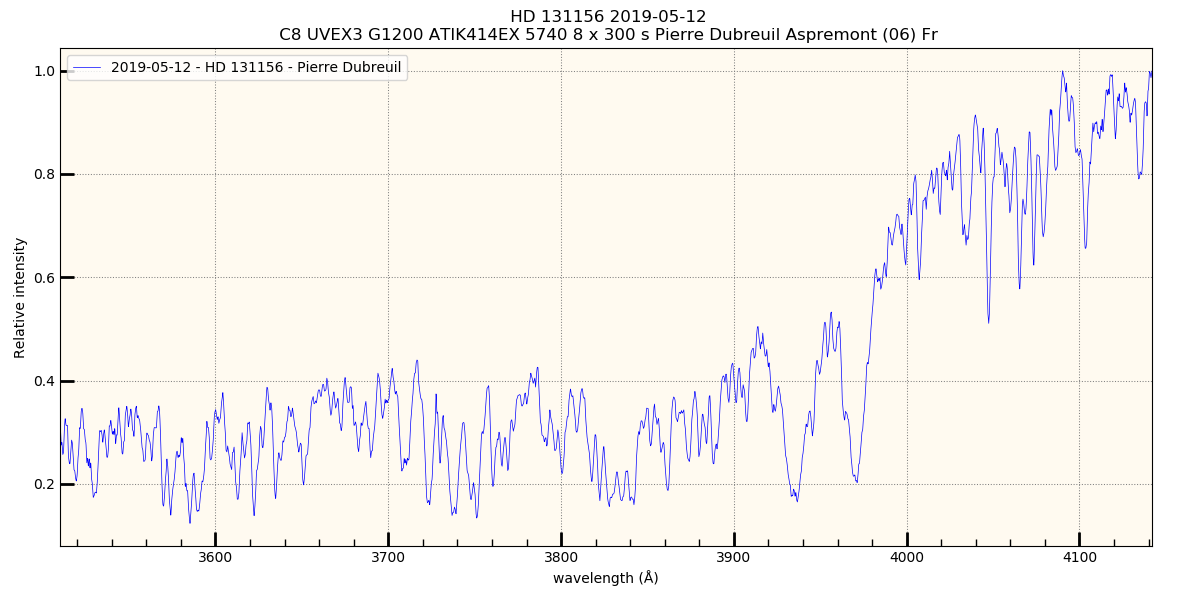

Re: Chromospheric active stars: a key program for amateurs
Post by Dubreuil Pierre »
Bonjour à tous
Hier soir premier essai UVEX3 avec fente claire dans la partie UV.
HD 131156  slit 35m
HD 131156 slit 35m
hd131156 12-05-2019.png (110.8 KiB) Viewed 136569 times

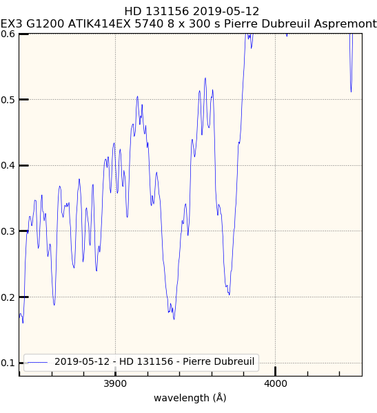

Un zoom sur H et K
HD 131156  slit 35m  crop
hd131156 12-05-2019_crop.png (61.93 KiB) Viewed 136569 times
cordialement

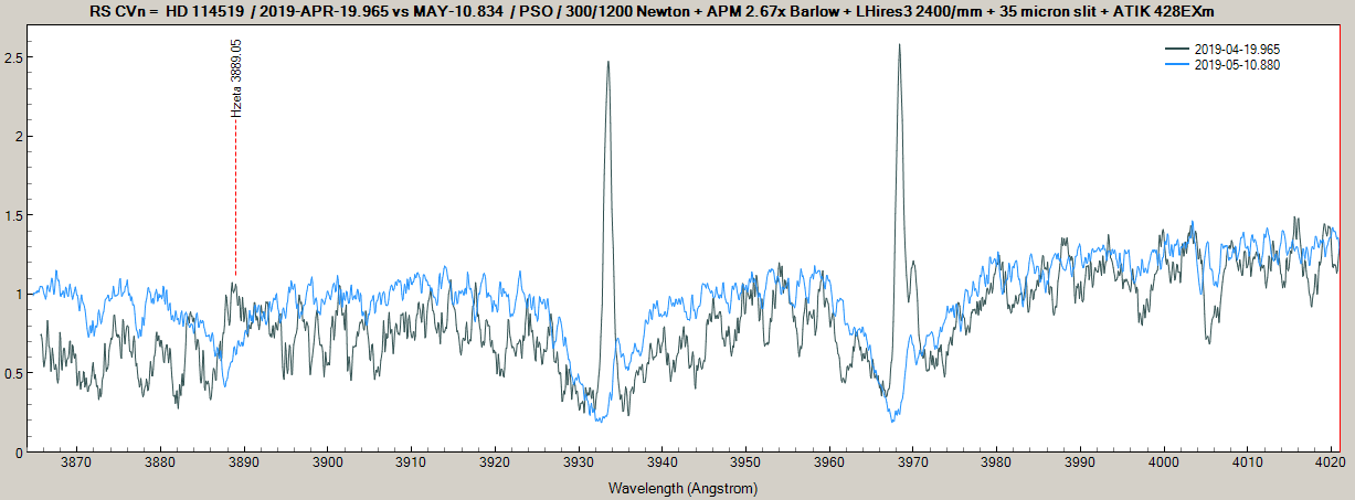

Christian, the star HD 114519 is actually *the* RS CVn (= that I've just published before yours). Would it be possible using human readable names (or both), especially by which they are most commonly referred? It is hard to associate a 6-digit number to anything - at least for me, not sure about new visitors... Of course, only when have choice!
In fact, RS CVn looks as if missed the star (in fact didn't):
But the truth is, its period is 4.8d with eclipse duration 11% (not a rare event), so looking at our JD-OBS we both may have caught it in the eclipse.

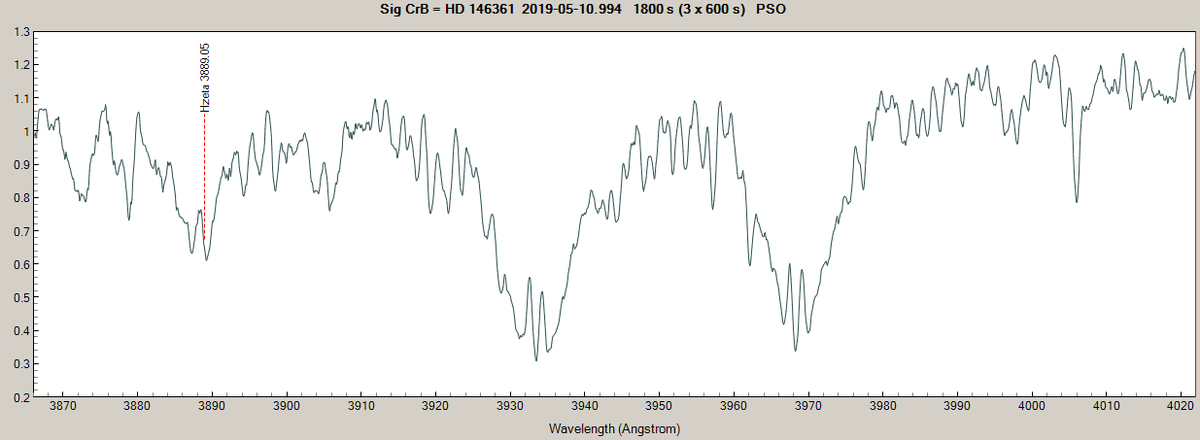

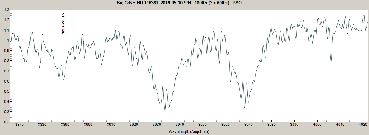

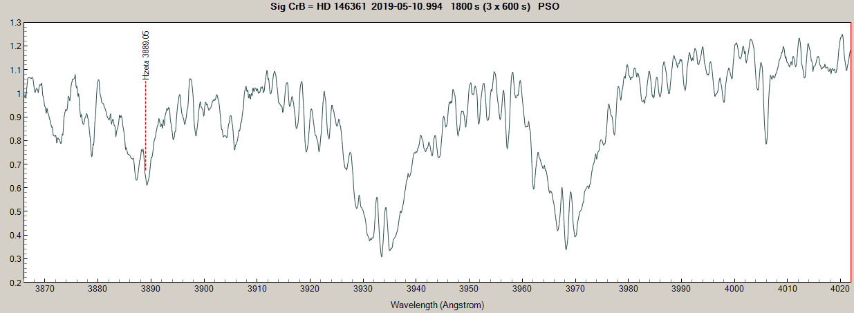

The other interesting star worth to publish here on time, is Sig CrB = HD 146361:
Visually, looks there is some change.
However, I'm rather unsure what do we want to do with an S-index in case of these 2 stars (RS CVn has deep continuum changes, Sig CrB have interesting RV moves).

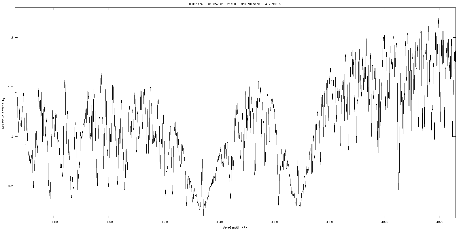

Last night, a first spectrum for me for this kind of target : HD 131156 (Ksi Boo) taken with my eShel spectrograph, but I don't refocus the spectrograph in the blue, so the resolution for #56 and #57 orders go down to R=6000.
