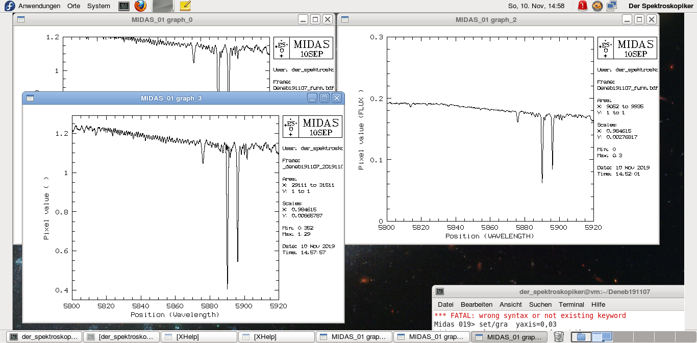

There was used the same files for both reductions . left = ISIS right = midas
Thank you for your answer but please look the adnex. It seems quite obviously that ISIS produces those "fringes" and it destroy so my spectra. It' rather clear that it is not caused by hardware problems.
I am not at all happy about this, I would prefer to go on with ISIS since Midas is not so easy to use.........but at the moment I have no choice!

The same files reduced with ISIS (left!) and midas (right)

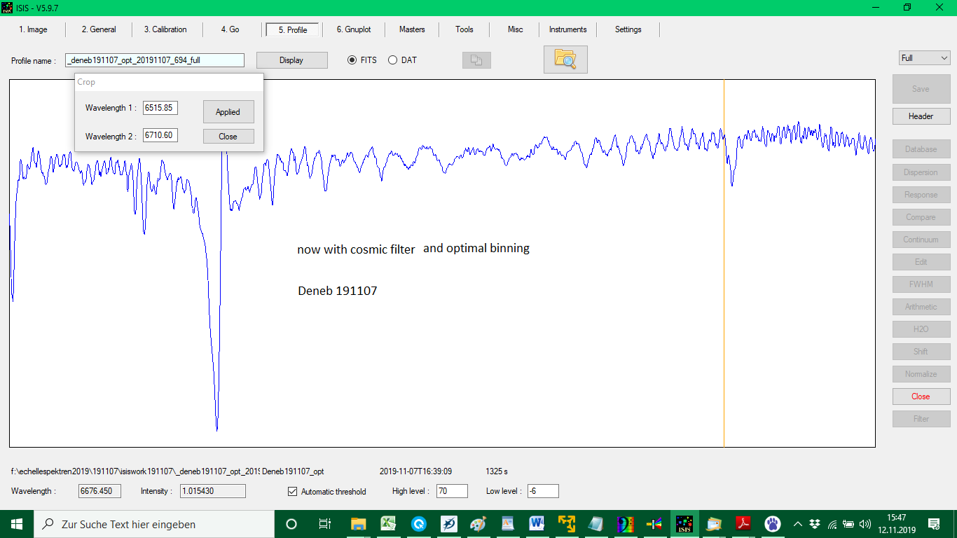

no "waves" are to be seen in the continuum!
Artefacts caused by ISIS
The problem is obviously even I used "optimal binning" in ISIIS.
berthold

I have had an ATIK 460ex to avoid those ripples. No effect. The same probleme was to see as demonstrated with the 460ex! That is not caused by the detector! Please see the results with MIDAS!
berthold

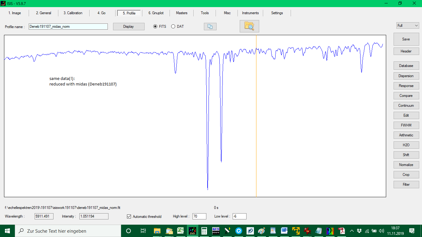

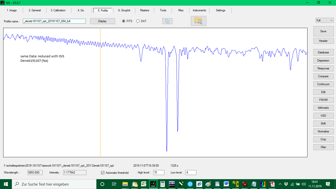

No, it is the same with ISIS
there must be a problem with ISIS
unfortunately I can't send *.xml
that's not a probleme of the hardware.
berthold
