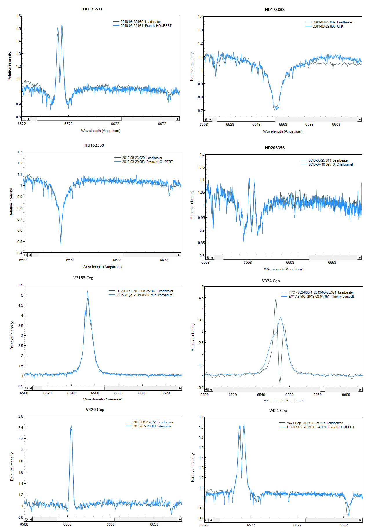

Five high priority (7,8,9) targets from last night in poor variable cloud conditions compared with the latest spectra in BeSS. They are waiting for validation in BeSS but are available in the BAA database
(EDIT:- now in BeSS thanks Valerie !)

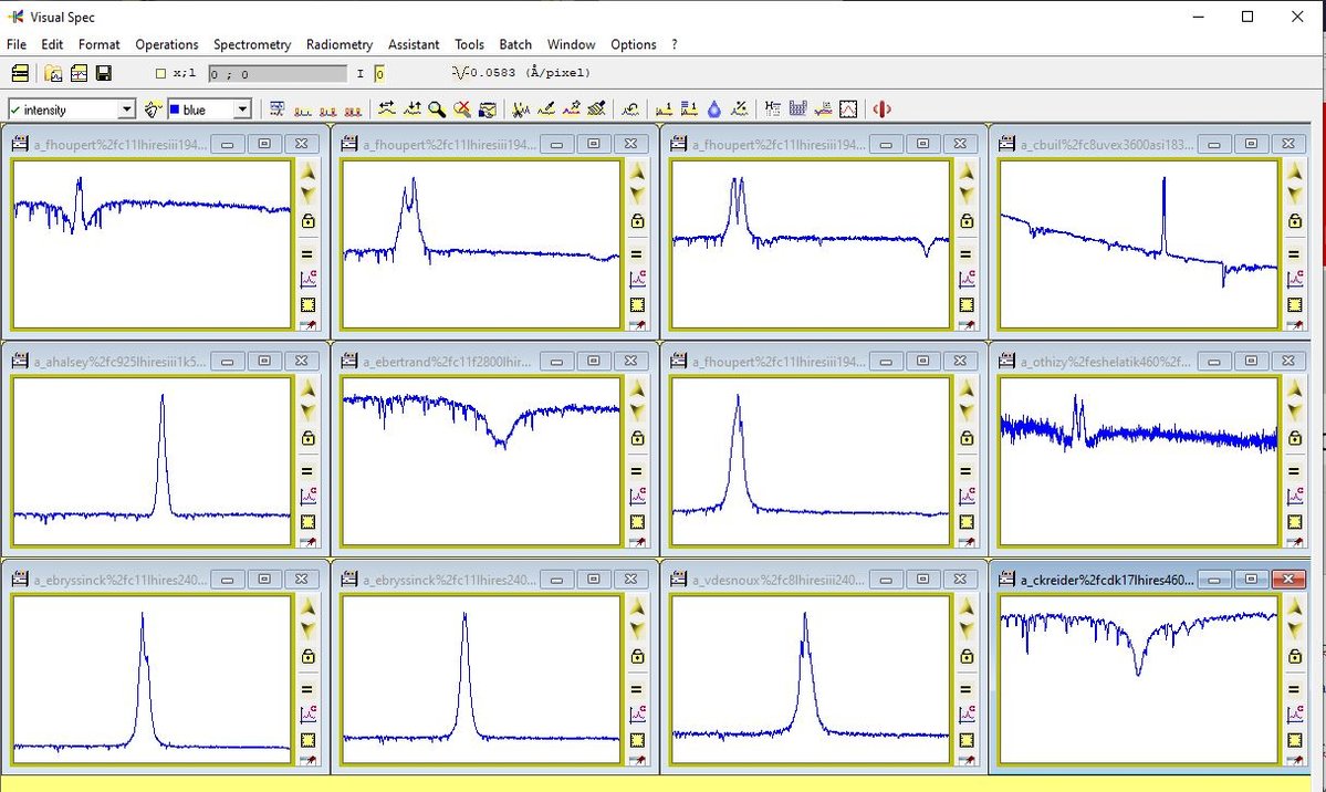

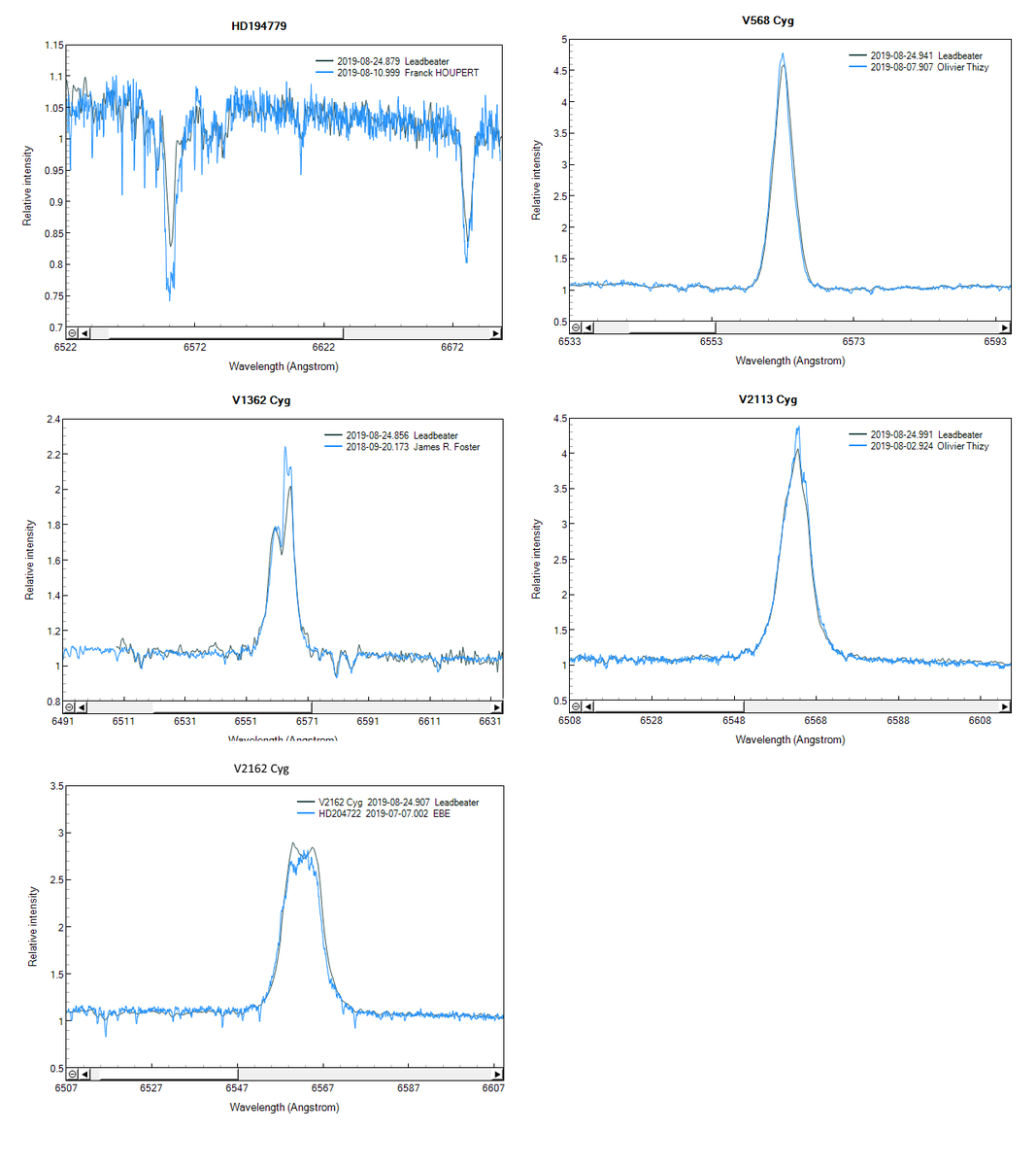

Last nights observations. Some interesting differences

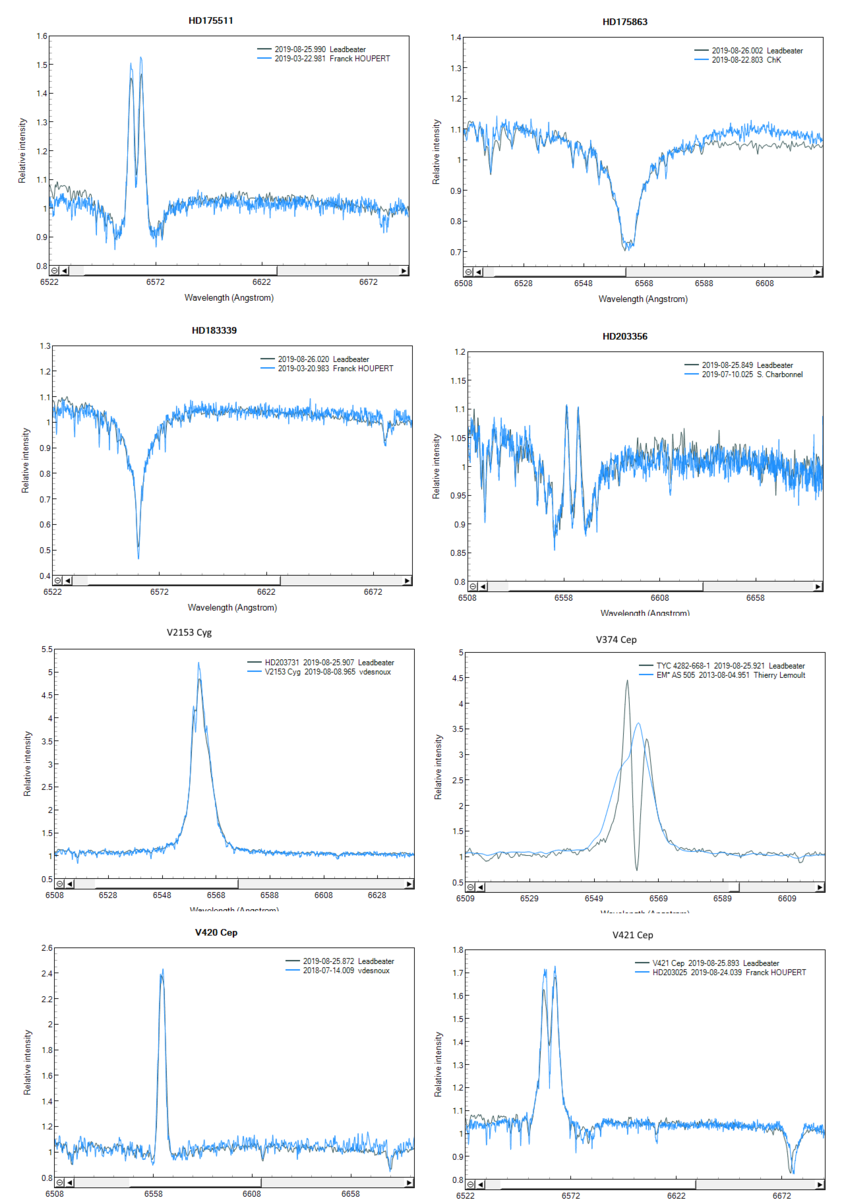

HD175511 - He 6678 is present in absorption 20190322 but is absent currently. Does anyone know the astrophysical significance of this ?
V374 Cep - The only other spectrum in BeSS is a low resolution one from 2013. The intensity of emission is similar but profile looks suspiciously different. It is difficult to be sure with the difference in resolution though
V412 Cep - H alpha looks similar to the spectrum in BeSS taken 2 days earlier but there are some strange differences in the continuum on the red side of H alpha and the 6678 He absorption line has shifted to the blue and possibly changed shape. Are these differences real ?

Notes for observations in this thread so far:
BD+27_3970 = TIC 126756648
Observed in Halpha by Robin night of 2019/08/20. 2.5xContinuum, W-shape profile with small delta-Vp. FWHM = 6.7A. Observed by Christian Buil 2019/08/25 showing apparently single-peaked Halpha at 2.5xContinuum. Medium/low priority of 4 now because the Halpha line suggests this is nearly pole-on and the disk is relatively strong for a B6/8 star, and it will be difficult to detect spec. changes.
EM* MWC 1030/TYC 3178-815-1 = TIC 296771641
Observed in Halpha by Robin night of 2019/08/20. 27xContinuum! Single peaked Halpha. EW = -110A, FWHM 3.3A. unidentified emission line at ~6515A. There is a low resolution spectrum from 20180716 which also shows H alpha in emission at similar EW. Expired as classical Be star based on Halpha profile and SED that peaks in the NIR.
HD_194779 = TIC 15126043
- Spectra so far do not show signs of Halpha activity. Still interesting to monitor no more than once per night. If Halpha activity is seen then higher cadence will be requested.
V568_Cyg = TIC 100165164
- Observed by Robin on 2019/08/24 and Olivier on 2019/08/07. Both show the ~same single-peaked 4.5xContinuum Halpha. Priority slightly lowered since we are unlikely to see much activity in the remaining time TESS is observing this star (until Sept. 11) given the high strength of Halpha and near pole-on orientation.
V1362_Cyg = TIC 40478523
- Nice observations by Robin on 2019/08/24 and James Foster on 2018/09/20 that show double-peaked Halpha with large changes in V/R over just 5 days. Similar variability is seen in NRES spectra from Jon Bartz. Continue to monitor at 1+ observation per night. Jon will continue to monitor with NRES. This clearly has interesting Halpha variability on short timescales and is likely to be variable in TESS.
V2113_Cyg = TIC 202752748
- Observed by Robin on 2019/08/24 and Olivier Thizy on 2019/08/02. Both show similar strength 4-4.5xContinuum Halpha with mostly single-peaked shape. Some structure apparent in Olivier's spectrum. Priority level remains at 7. Despite the strong Halpha, we might be able to see variability near the line center on short timescales if this is in fact a binary.
V2162_Cyg = TIC 240258004
- Interesting behavior in many observables (too tedious to name them all). High priority. Possible SB2. Very likely to be active on short timescales with TESS. Likely has a dense inner disk.
HD_175511 = TIC 236785664
Robin: "HD175511 - He 6678 is present in absorption 20190322 but is absent currently. Does anyone know the astrophysical significance of this ?"
Interesting observation + question. From Halpha, this is practically a shell star. My first guess is that an enhanced density in the inner disk could obscure the photosphere to a degree that would make the apparent depth of He lines smaller. But this would also presumably make the Halpha line core deeper, which we do not see in the observation. Non-radial pulsation can change the depth/shape of photospheric lines, but I don't think the effect would be so strong as to wash the line out completely. Or, maybe the photospheric Teff is variable. I don't have a good answer for this, but it's definitely interesting.
- This is one of the 3 Be stars that is being observed in 10+ sectors with TESS. Continued monitoring at a low cadence of 1 spectrum per week or so is ideal for now.
V374_Cep = EM* AS 505 = TIC 434972921
- Apparently a Herbig Ae/Be star according to Simbad. The SED peaks in the NIR and there seems to be dust excess. Probably not interesting for Classical Be star work, but this could still be interesting if its visible TESS light curve is variable (which would not be surprising).
V421_Cep = TIC 314576961
Robin: "H alpha looks similar to the spectrum in BeSS taken 2 days earlier but there are some strange differences in the continuum on the red side of H alpha and the 6678 He absorption line has shifted to the blue and possibly changed shape. Are these differences real ?"
- Interesting find! The He variability looks real to my eye. This could be consistent with pulsation changing the line profile shape. This is certainly worth continued monitoring especially since it will be visible for TESS sectors 15,16,17.
HD_175863 = TIC 233613741
- Observed by Robin and ChK on 2019/08/26 and 2019/08/22 respectively. No obvious difference in Halpha- pure absorption down to 0.72xContinuum. This star is in the TESS continuous viewing zone. In that respect, I think it is good there is no disk right now. Continue to monitor once every few days. If any change in Halpha, we want higher cadence observations. Good chance to observe a disk build-up from a purely photospheric level in both TESS and spectroscopy.
HD_183339 = TIC 284563819
Observed by Robin and Houpert 2019/08/26, 2019/03/20. narrow Halpha absorption with no variability. I don't think this is a classical Be star. Priority is lowered. Still, since it is in the TESS continuous viewing zone, a spectra every few weeks might still prove interesting.
HD_203356 = TIC 63318608
- Robin, 2019/08/25, and Charbonnel 2019/07/10 both see double-peaked weak Halpha in a wide absorption profile. No change between the two spectra. Based on the late spectral type and consistent line profile I doubt we'll see much variability over TESS timescales.
V2153_Cyg = TIC 373819241
- Robin, 2019/08/25, and vdesnoux 2019/08/08 both see ~4.5xContinuum mostly single-peaked Halpha. Some variation present. Halpha profile is somewhat distorted. Obviously not a shell star from the spectrum. Could be a binary based on observables. Will be interesting to continue to monitor. Nice target.
V420_Cep = TIC 313986452
Robin, 2019/08/25, vdesnoux 2018/07/14 both see single-peaked Halpha at 2.4xContinuum. Since older spectra from BeSS show up to 6xContinuum, we are probably seeing the disk at a relatively low state. Continued monitoring at low cadence is a good strategy since this is in 3 TESS sectors and we may see some disk growth from flickers.
BD+50_3188 = TIC 364925342
Christian Buil, 2019/08/25, apparently single-peaked Halpha at 2xContinuum. Not known in BeSS. APOGEE spectrum show Br11 double-peaked 1.2xContinuum with variable central depression. Priority lowered since the KELT light curve is exceptionally flat for a Be star. Still, one more spectrum couldn't hurt to see if there is variability in hydrogen lines.

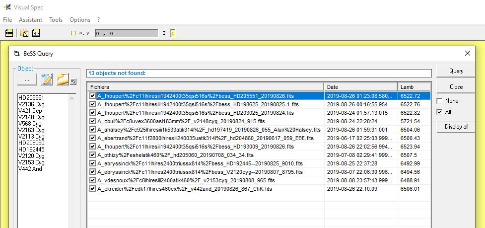

I am one of BeSS validator and we are almost up to date in our validation process. BeSS validated spectra are visible on the next day (around 01h00 UT).
As a Be star observer (and actually only observing Be stars with my backyard setup), I have added the priority >1 TESS target in my target list with increased priority (I am using an automated script which "select" targets based on telescope location, BeSS priority and my own "bonus" weight) and I have already observed/uploaded some of them in BeSS.
Here is my "TESS target" list: HD 205551 V2136 Cyg V421 Cep V2148 Cyg V568 Cyg V2163 Cyg V2113 Cyg HD 205060 HD 192445 V2120 Cyg V2153 Cyg
On top of those, I am actively observing and ask others to do so as well the star V442 And as there will be an intensive observing campaign this Fall (and it will be observed with TESS as well). This is one in coordination with PI Noël Richardson.
Anyway, to monitor a list of target in BeSS, you can use the VO ability of BeSS database. For exemple in VisualSpec it's easy to have a list of targets and check what are the latest spectra and display all of them:
An alternative would be to look at BeSS robot file and extract from that list only the TESS target you are interested in; you have the date of the last obervation for each target. This robot file is modified every night from BeSS data sent to ARASBeAm:
URL: http://www.arasbeam.fr/robot/ObsC2AFull.txt
It would be easier than having to go to GoogleSheet every time. And it will put pressure on validators to validate spectra quicker in BeSS... :-)
