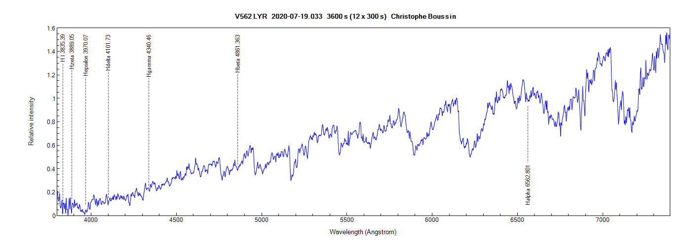

Here is my contribution to the suspected/misclassified symbiotic stars.
I obtained the following spectrum of V562 Lyr with a spectral range including the Halpha line (from 3800 to 7395 A) the 19th of July at 00 h 47 TU with my Alpy 600 (resolution of 506, JJ = 2459049.5329) and an acquisition time of 60 min :
V562 Lyr on July 19th, 2020 (3800-7395 A)
_v562lyr_20200719_033_Christophe Boussin_3800_7395.png (116.83 KiB) Viewed 218681 times

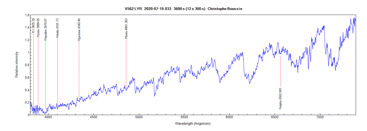

Identification of Balmer lines from PlotSpectra :
V562 Lyr on July 19th 2020 (identification of Balmer lines from PlotSpectra)
No balmer lines are visible in emission.

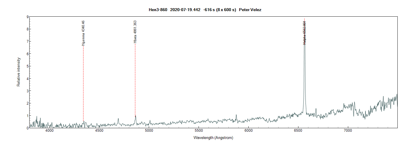

Here is my spectrum for Hen 3-860 from 19 July.
Its quite noisy - the target is faint and the conditions were only so so. That said, the H alpha and H beta emissions are quite plain to see. There are a few other emissions that I am unsure about. I confirmed this with a second set of images on 20 July. I will give this some more time over the next week when the weather is better
Francois, I will send the .fit file to you by email
Pete
Hi Peter,
That's a great result on a very faint target. Congratulations.
Your spectrum clearly identify Hen 3-860 as a symbiotic star:
- continuum of the red giant
- Balmer (HI) lines and high ionisation lines : He II 4686, [OIII] 5007
There are also He I lines 5876 and 6678.

V562 Lyr: Observations of Ibrahima and Christophe are consistent with the M2 giant. As there are no emission lines in the spectra, and the star was not detected in UV by Galex, I would say that it is only a single M giant. No periodicity has been detected by ASAS-SN, there is some semi-regular variability in SuperWASP.

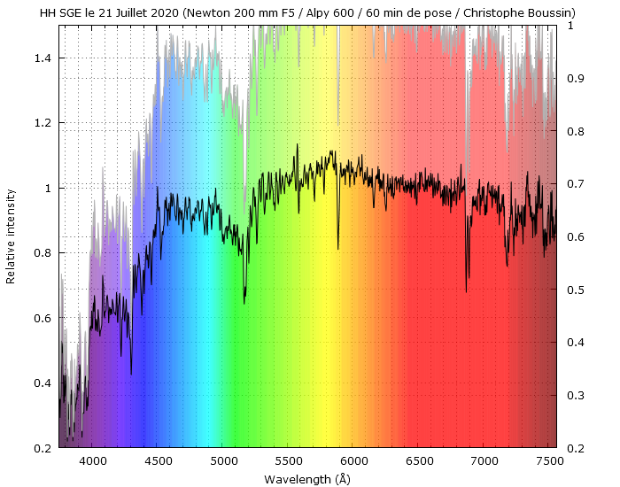

HH Sge: The spectrum by Ibrahima, combined with the distance from Gaia and the brightness of the star suggests K subgiant, not consistent with a symbiotic star.

Hen 3-860: Peter's spectrum confirmed, that it is indeed a symbiotic star (I strongly believed in this object, this was my favorite in the list :D ). Congratulations Peter, great job. I am already working on the photometry of the target covering especially its outburst in 2018. As I already indicated, I would like to devote a separate paper to this target. Subsequent observations of the star in order to increase the signal to noise, are welcomed.

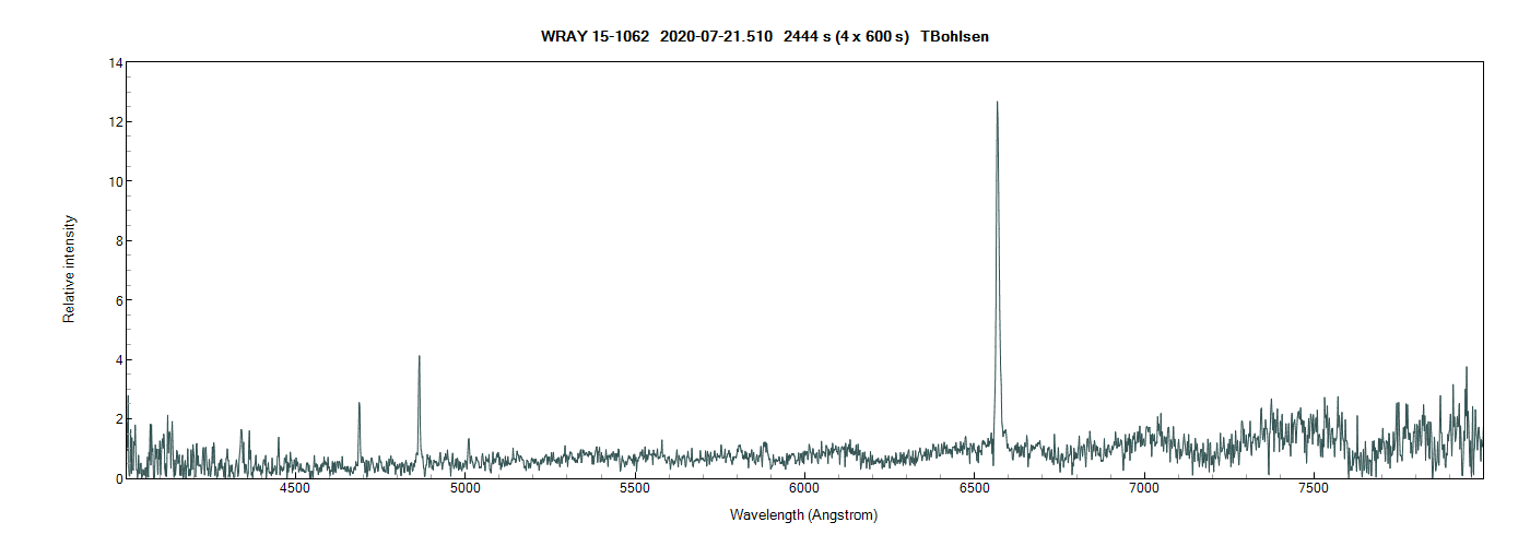

I have also taken a spectra of Hen 3-860 or WRAY 15-1062 as it came up on Simbad.
It is clearly a symbiotic star.

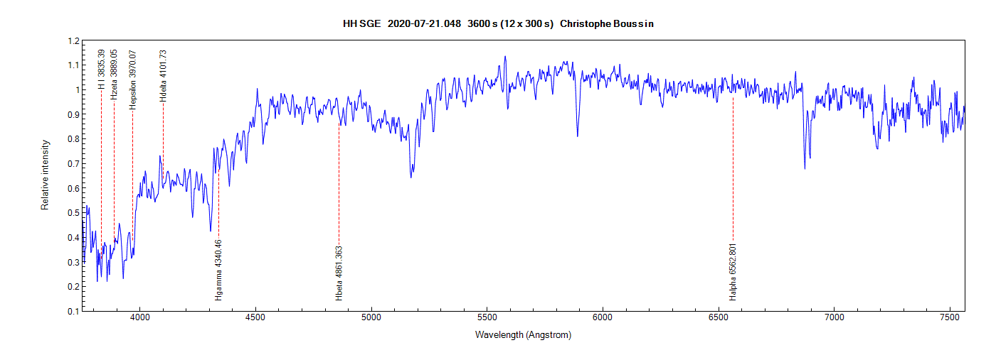

Here is my second contribution to the suspected/misclassified symbiotic stars.
I obtained the following spectrum of HH Sge with a spectral range including the Halpha line (from 3750 to 7565 A) the 21th of July at 01 h 08 TU with my Alpy 600 (resolution of 502, JJ = 2459051.5477) and an acquisition time of 60 min :
HH Sge on July 21th, 2020 (3750-7565 A)
_hhsge_20200721_048_Christophe Boussin_3750_7565.png (127.74 KiB) Viewed 218573 times
HH Sge on July 21th 2020 (identification of Balmer lines from PlotSpectra)
Clear skies,

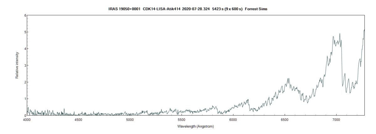

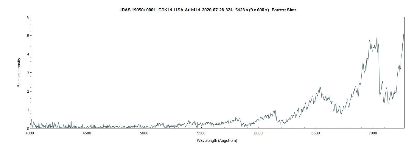

Here is a spectrum of IRAS 19050+0001 taken last night. The fits file has been sent to François Teyssier for the database.
Woody Sims

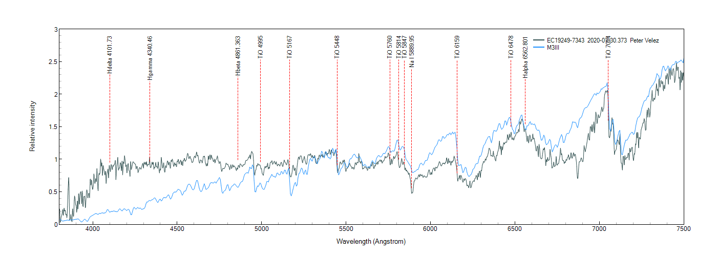

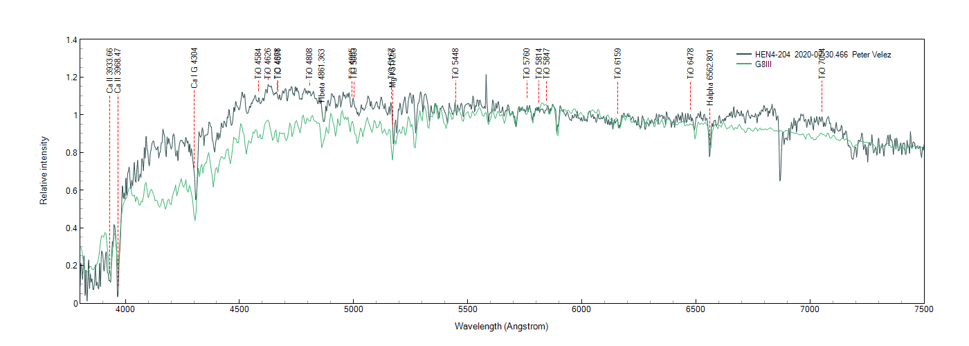

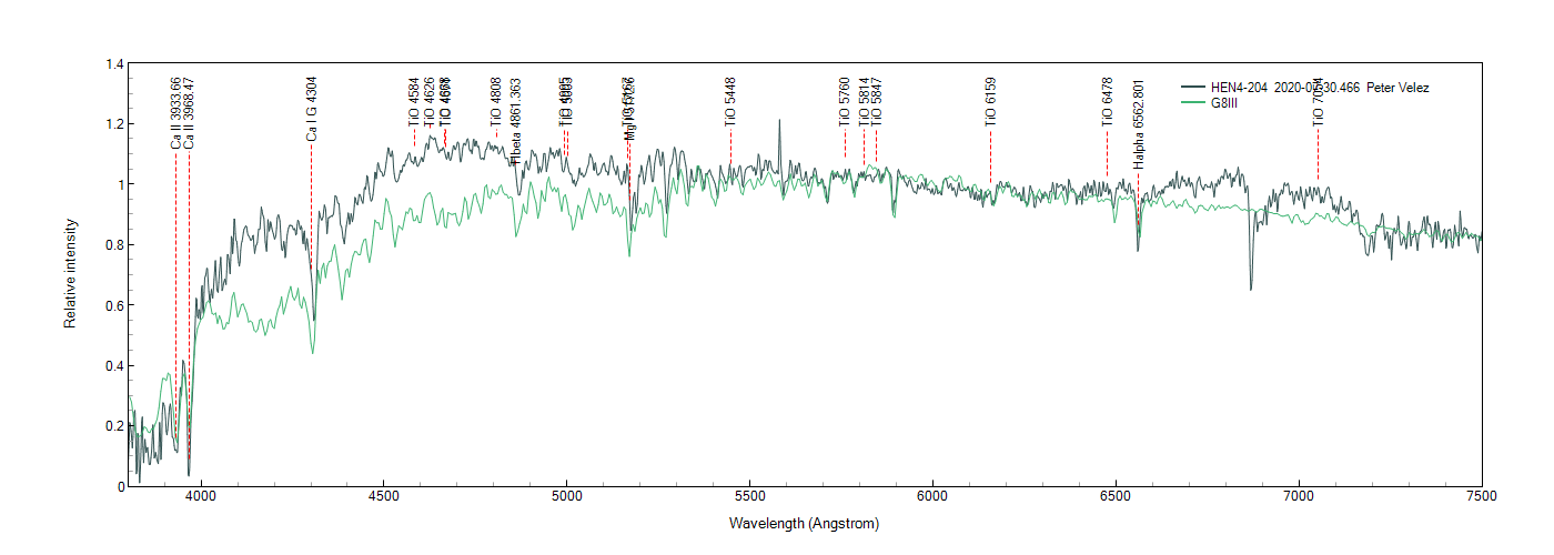

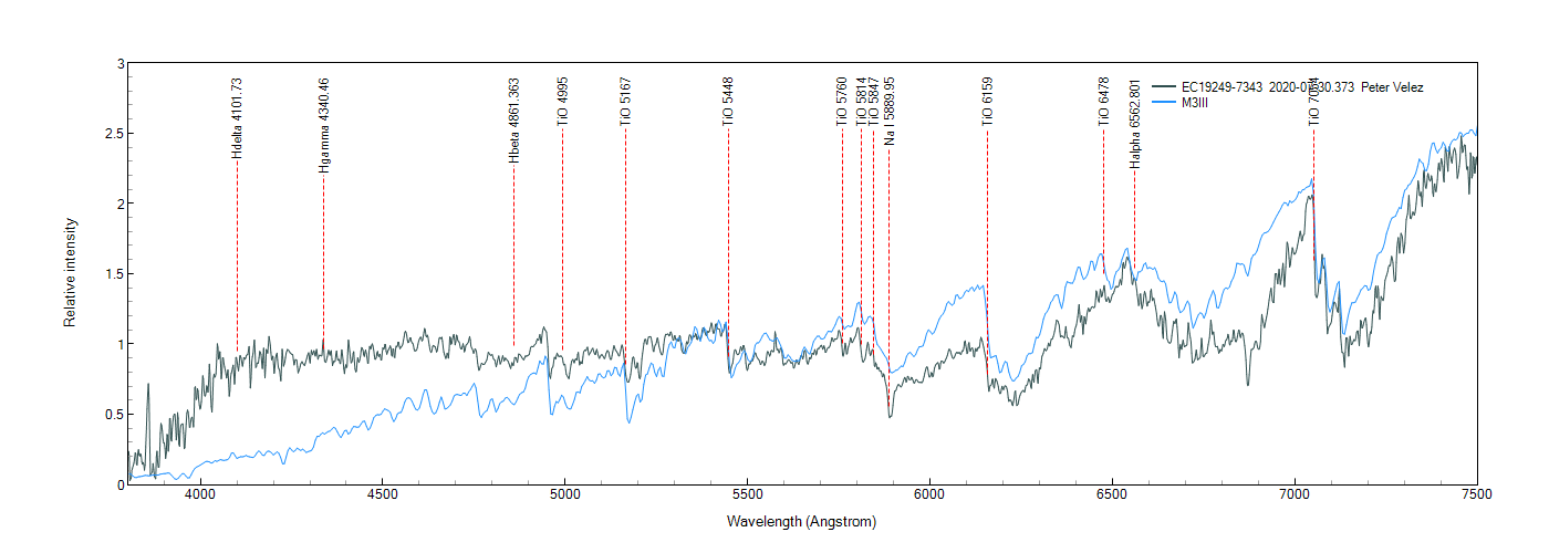

I confirmed my earlier results for EC 19249-7343 and Hen 4-204. Both are not symbiotics.
EC 19249-7343 looks a good match for an early M giant. I've attached my spectrum plotted against a Pickles M3III synthetic spectrum with a few absorption lines noted.
Hen 3-204 seems to be a mid G giant. My spectrum is plotted against a G5III synthetic spectrum. The spike at 5581A is spurious.
Spectral calibration in the UV/Blue is not great - but should be sufficient for present purposes.
Pete
