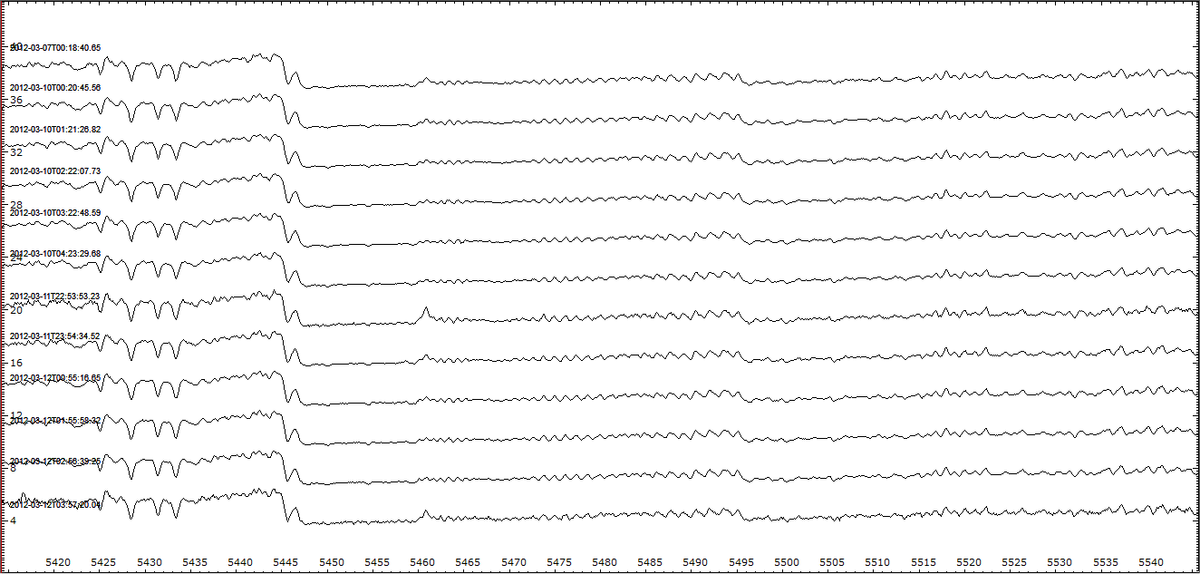

Maximun time coverage of CH cyg at my location is 5H after 00H20 TU, beginning at 20° above the horizon, finishing at 70° 1H before sunset. I've done 5 eshell spectra of 1H each yesterday without noticed any flickering. I asked to Margarita for observation cadence needed.
Well, i slept comfortably and let the telescope in automatic mode in the frozen night. It will be possible to do this every nights depending of the weather.
Joined are the fit spectra for whom want to chek filly lamp calibration method.
T

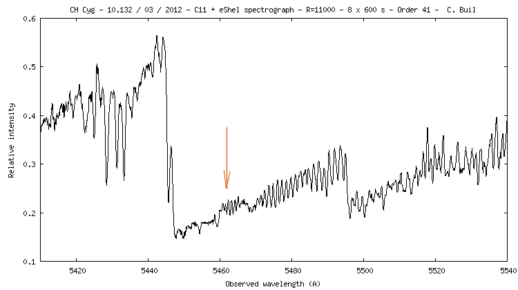

On the attached portion of eShel spectrum (C11 telescope) the arrow indicate a spectral region apprently in emission in the published Thierry spectrum
(my spectrum is taken last night - 10/03/2012).

- 5018.5 line on Robin spectrum must be FeII rather than He I
- The "spectral region apprently in emission" could be an enhnacment of the continuum produced by the activity of the hot star.
It shoud be interesting to compare this region with da M6 or M7 normal giant star.

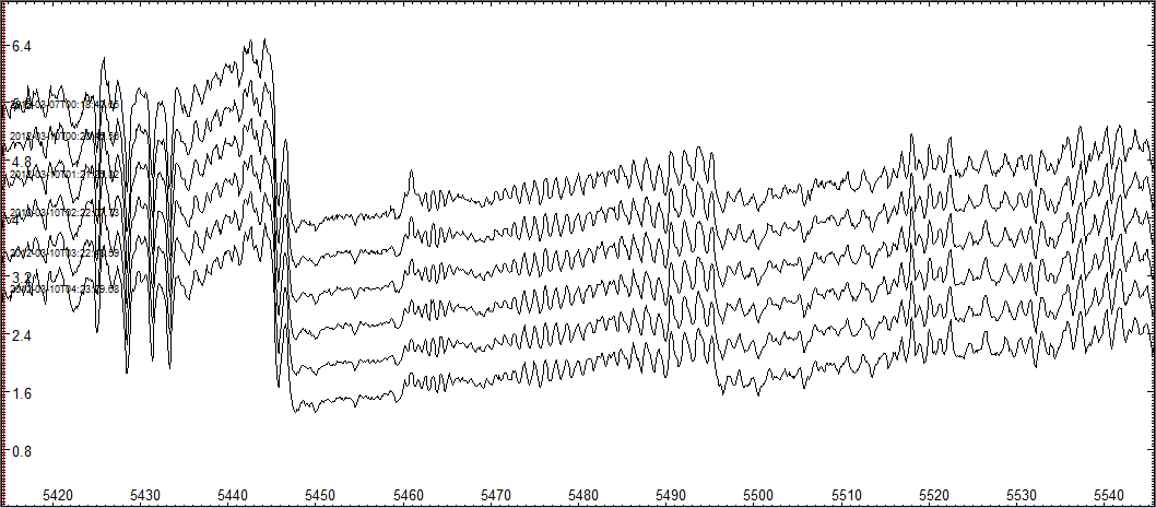

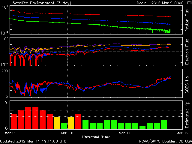

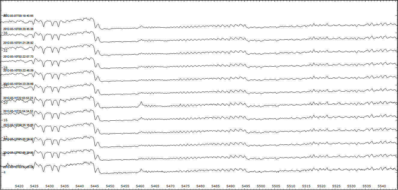

5461 was seen in emission in March 7 spectra, taken at very low altidude, 17°. I have the same emission in the first spectra of my early series at high airmass and it vanished with airmass getting low, from 20° to 70° altitude. It could be an atmospheric emisison.
Note Auroral activities was strong during until March 10,

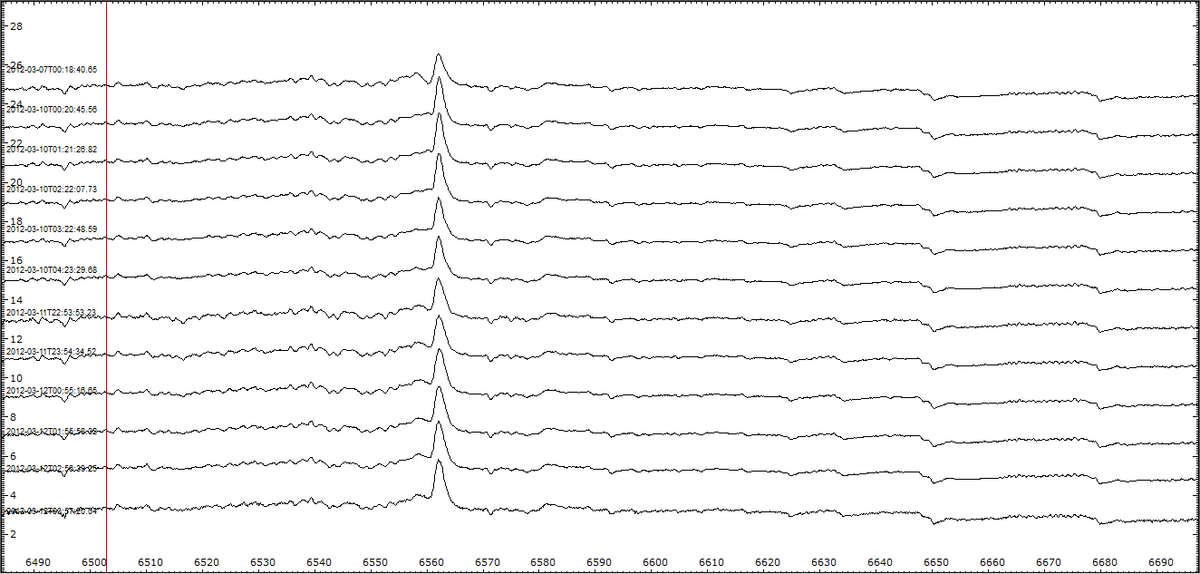

It is a telluric line, with fringing pattern beside when present. I have the same in today early morning spectra at 17° above northeast horizon and on one spectra not well guided at 70°high south. Robin It's a good idea but the pro are knowing such lines and does not need a comparison star, difficult to find at same airmass and azimuth, as dibs too. We may ask to Margaritta if there is the needing.

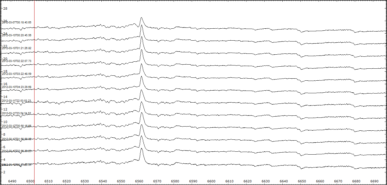

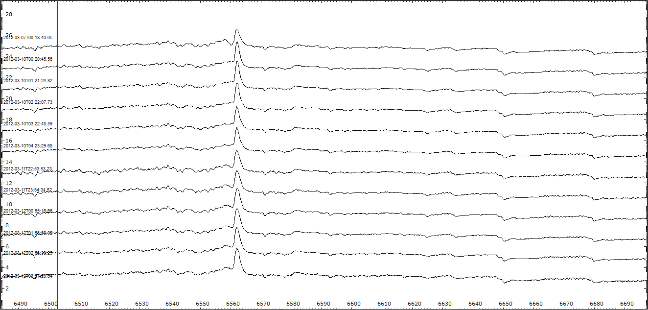

H alpha behavior summary of three days of observations.
Re: AAVSO Alert Notice 454: Monitoring of CH Cyg requested
Hi Theiry,
Yes the positions of Tellurics are known. Perhaps you can find enough tellurics to measure the intensity of the O2 and H2O lines in the eShel spectra but in my narrow range LHIRES H alpha spectra they not measurable because there are too many other lines masking them. The intensity of the H2O lines in my spectra is therefore not known. Without a measure of intensity they cannot be removed. The standard procedure used by pros in these circumstances is to take hot (line free) stars at two elevations. You can then use these to estimate the intensity of the Tellurics at the elevation of the target. Unless I do this my H alpha spectra will not be reliable.
