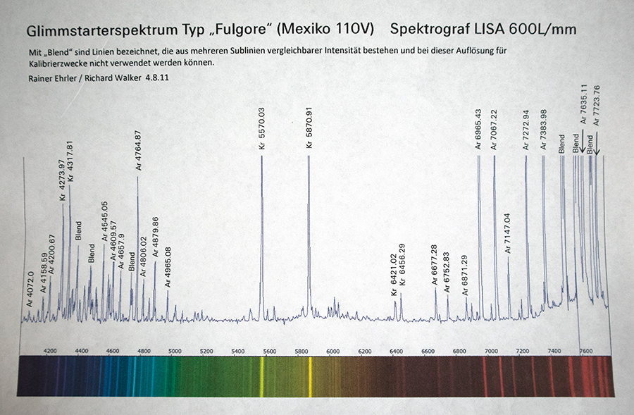

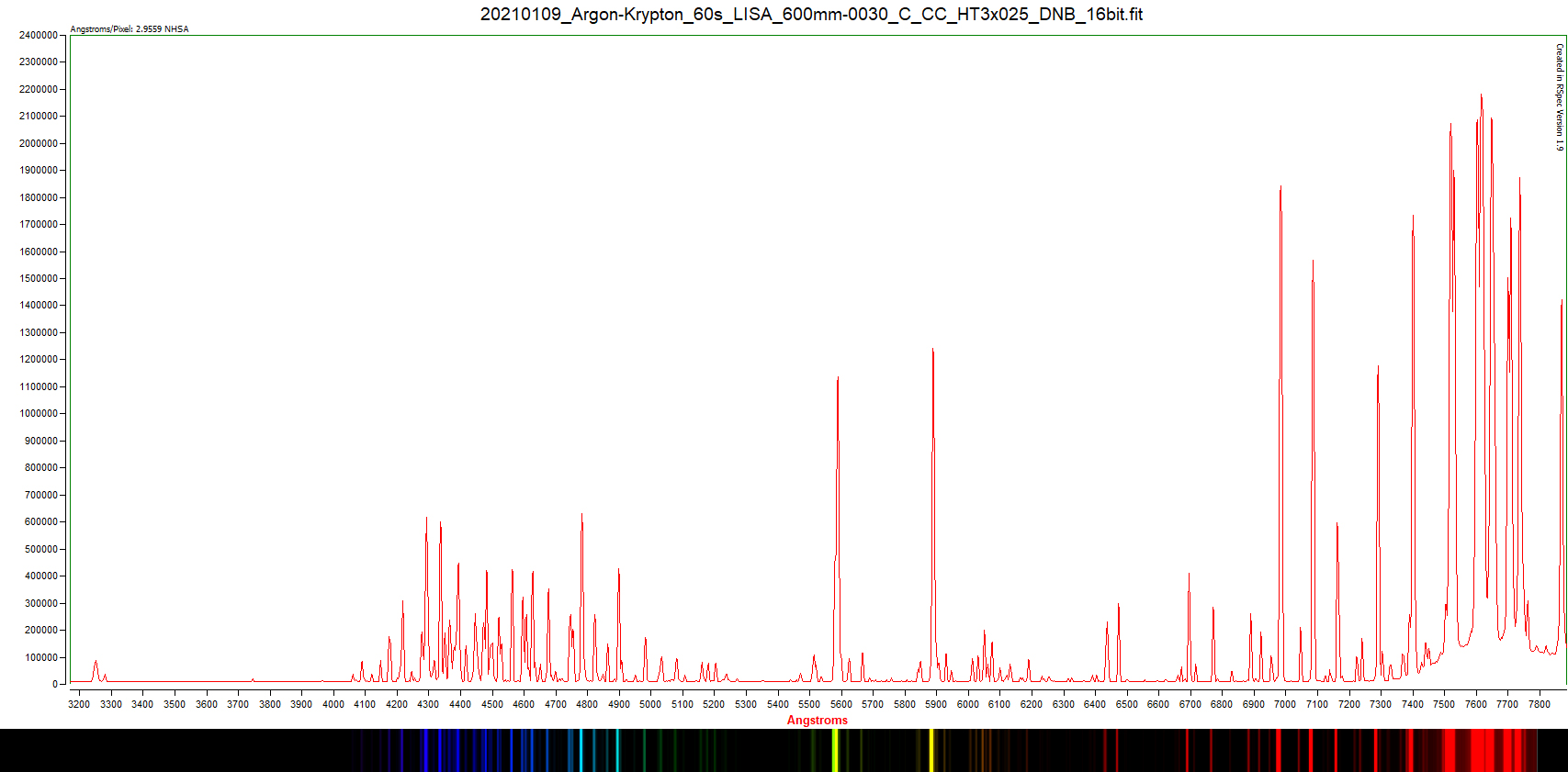

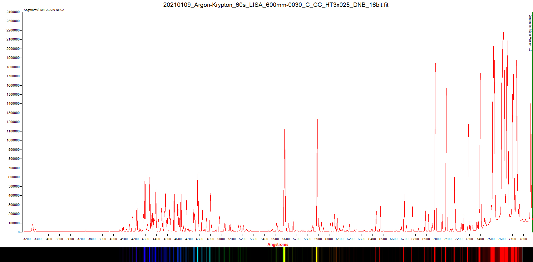

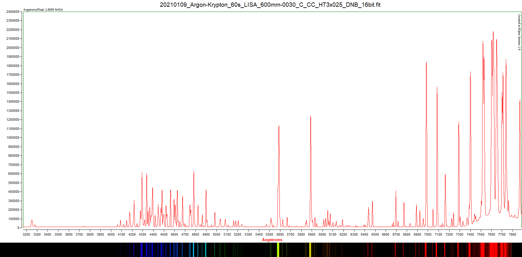

Thsnk. Will do. BTW I have now a starter lamp integrated in the telescope cover and with this I can shoot calibration frames in every position. The same lamp was calibrated many years ago by Richard Walker when in some forum there was a opinion exchange about this starter lamps. In Europe the brand OSRAM but I do not get them here. My starter lamp has Argon and Krypton gas.
regards Rainer

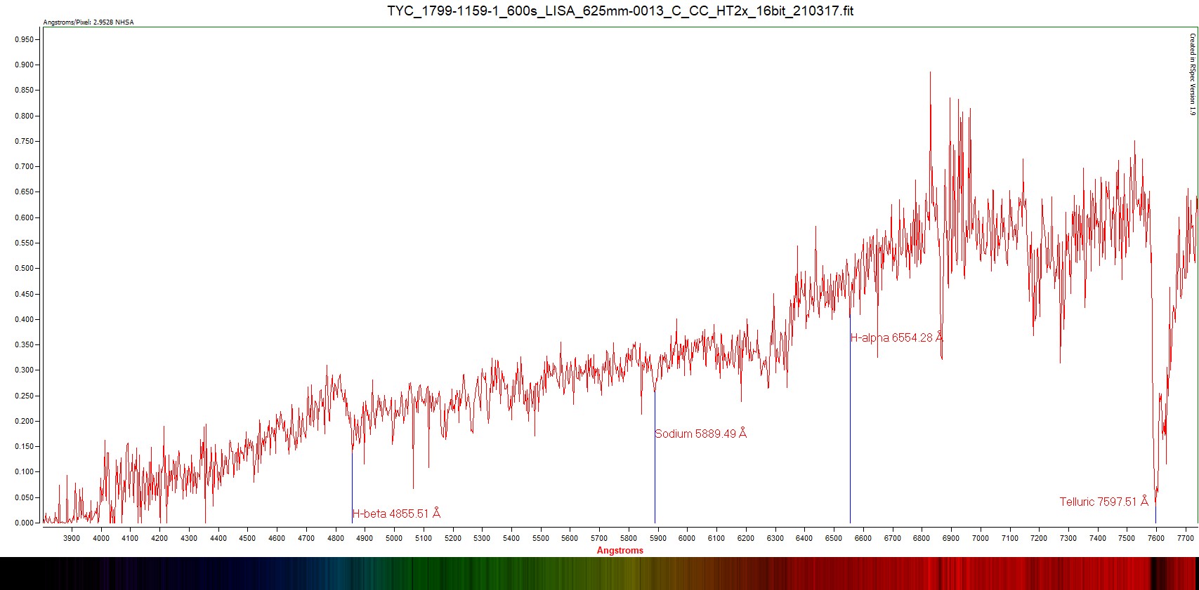

Hi Ulrich,

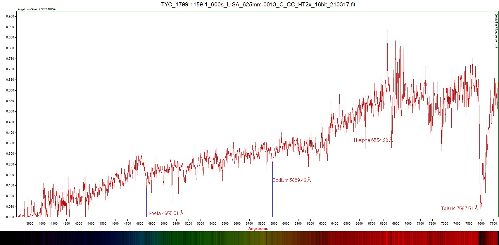

I was able to shot 13 images each 600 seconds but the last one were already quite low over the Horizon.
Below the graph. I labeled where the spectra has its lowest point. Also attached a fit file for your inspection. I just found out the forum does no accept the file type *.fit for upload.
Maybe we can exchange information adn you explain me better how to work our this file. I made a spectra of the nearby A0 star TYC 1799-660-1. Not yet processed. Also I made some calibration images of my calibration lamp and also not yet processed.
Appreciate your help.
regards Rainer

Hallo Rainer,
sorry for replying so late. I was distracted by urgent work for the Gaia satellite mission. Excellent spectrum, thanks! I will carefully look at it tomorrow. As for the practical treatment of the spectra, I am not the expert to ask. I guess you can find more and better advice from others in the forum. Any volunteers out there? ;)
If not, then simply send me your spectrum by email (bastian@ari.uni-heidelberg.de), plus the calibrartuon lamp spectrum, and I will ask the Mexican colleagues (see my next message) whether they can do a wavelength calibration and RV determination on it. They have the software to do that.
Thanks again, Uli

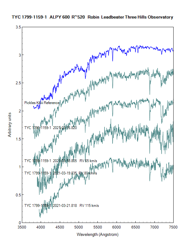

Re: urgent observation request for TYC1799 1159 1
Hi Ulrich
Here are four spectra covering 20210316-20210321 compared with Pickles K4iii as a reference. (open the image in a new tab to see it in correct scale)
There are Radial Velocities for three of the spectra, measured by cross correlation with spectra of iota Aur recorded the same nights. I do not have enough data to measure the uncertainty in RV but I would guess it to be ~20km/s 1 sigma so the differences between the nights may not be significant. The spectra can be accessed from the BAA spectroscopy database
https://britastro.org/specdb/
It is too low for me now and will not be visible for me again until August I am afraid

Thanks a lot to Rainer Ehlert and to Robin Leadbeater for additional data. They nicely confirm what we think to know about the star (spectral type, luminosity class, rough metallicity from the other spectra, and absolute magnitude from Gaia parallax). This is reassuring. Robin's RVs may be inconclusive at the moment, but let's wait and see what else comes in. I am fully aware how difficult it is to get good RV calibrations (i.e. better than 0.01 percent wavelength calibrations).
